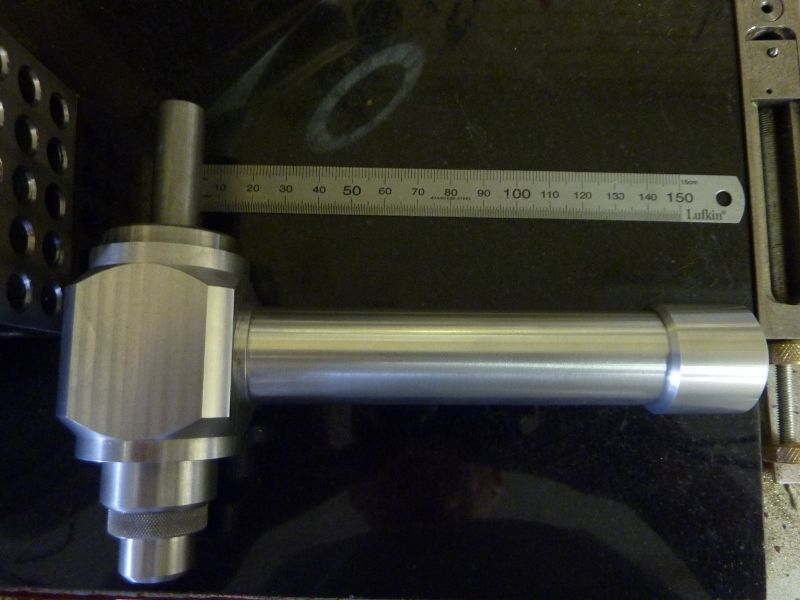

                    I'm just completing the Hemmingway Centering Microscope and would like to anodise the parts once completed.
                    However I have made the male and female threads to a really good fit, I'm concerned that after anodising the treads will be too tight.
                    When anodising, is there a process whereby curtain areas of a component can be protected from being anodised ie. close fitting parts?

                        My understanding is that the parts shrink when annodised ( the oxide is denser that base metal thats why it is impervious ..like cromium and unlike iron who's oxide is less dense and thus larger) thus threads "loosen"… about 5-10 microns.
                        Manufactured thousands of anodised parts and never needed to use "preplating" gauges for fit. but home anodising ? sorry can't say..
                        #105820
                        The Merry Miller
                          @themerrymiller
                          If components are "hard anodised" then you you will finish with an increase in dimension on outside surfaces.
                          Eg. If you want .002" hard anodising you will get approx. .001" growth and .001" penetration.
                          This is not an exact science and the figures can vary usually  between 50-60%

                              My thoughts were to use some kind of tape, grease or even paint, but having not yet done any anodising I was unsure of the reation/contamination with the acid.

                                  The fits I have achieved will not allow for any further interference to be introduced, further more it appears that there is no fast and hard rule as to controlling the thickness of anodising when using a home setup.
                                  Therefor I think I may have to settle for a good quality primer/etcher followed buy a number of hard coats of paint. At leased with this method I can mask out the areas that I need to keep natural.

                                          Is it feasible to anodise the assembled unit and disassemble it after to fit the lens etc?
                                          For those who are not familiar with the microscope see below picture.p1010822 (800x600).jpg

                                            Martin, every part should be anodised seperately at the same time in the bath. If its anodised as one item the internal threads and inserts will not get anodised.
                                            The tubular parts will be put on the jig with internal clips so marks will not show on the outside.
                                            The anodising figure for what you want doing should be AA5 – AA10, this will be perfectly adequate for the use it will be put to.
