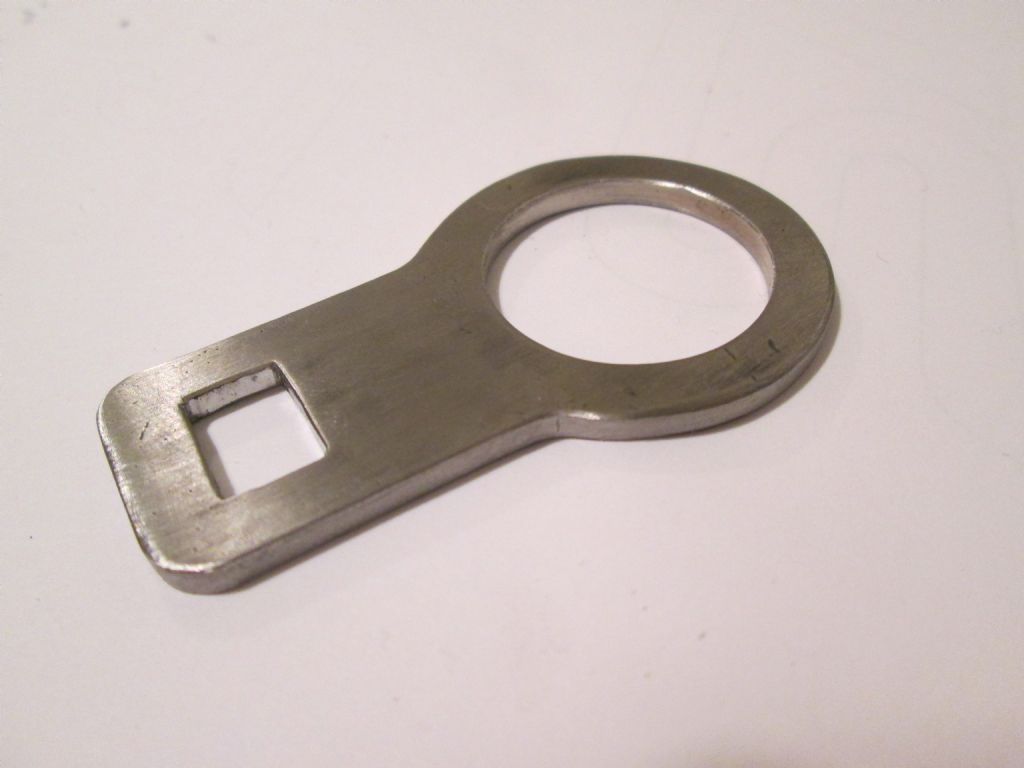

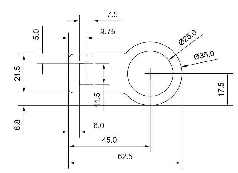

                      Thanks for the replies. This is what I want to make (a means of attaching the dog to a seat belt socket!):
                      I think I'll cut a rectangle out with an angle grinder and put it on the gas ring for a while, quench and see how it cuts with a saw. The square of 3mm plate I bought from the autojumble had been cut with a press brake, so it's obviously cuttable with HSS.

                            Just to wrap up. I used a hacksaw to cut out a rectangle from the 3mm plate, heated it to red on fire bricks and quenched. Result – no softening. I then reheated it and let it cool naturally. Result – no softening. So then it was a couple of hours with the angle grinder with a 1mm cutting disk, disk sander and files and voila – job done. I put it in the 4 jaw in the lathe to drill and bore the 25mm hole. But no more stainless for me, thank you!
