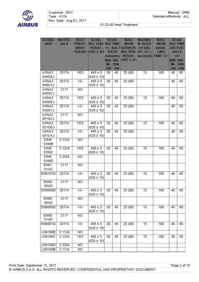

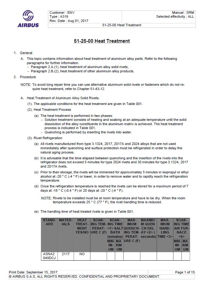

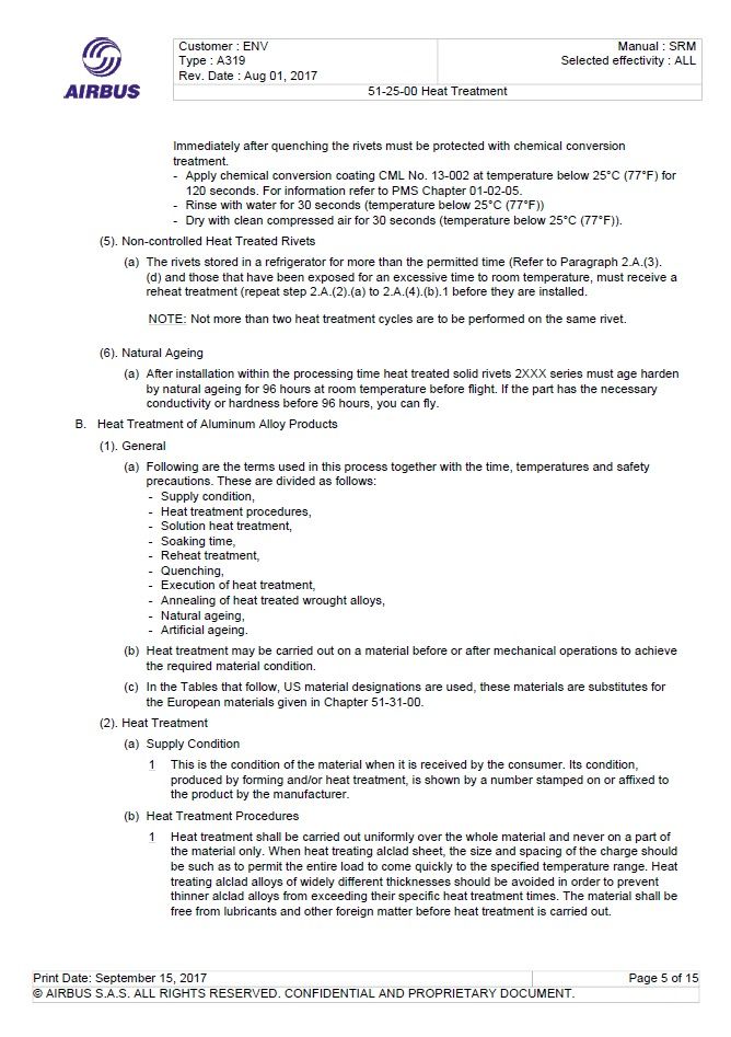

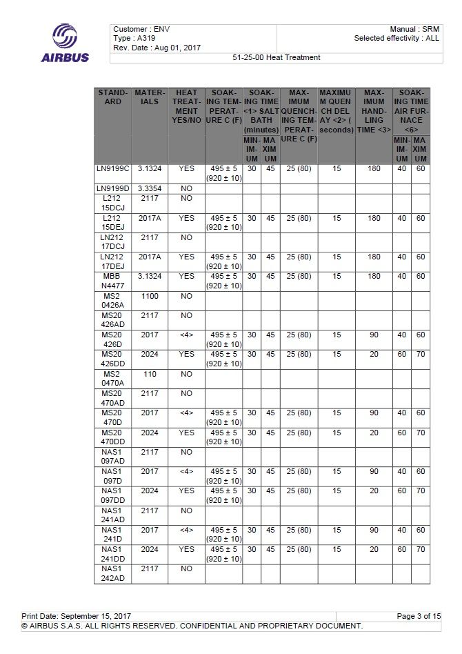

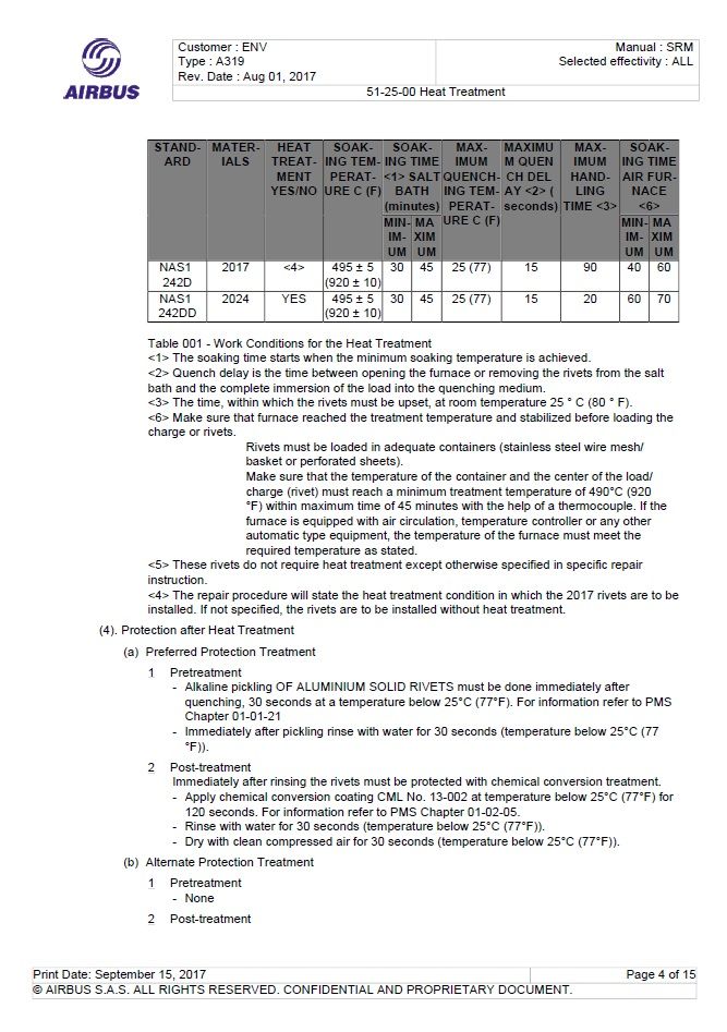

                          All depends on what type of alloy you're using. If you dont have a part number (which will normally give you the material type) you can check the markings on the rivet head. Colours will not identify a rivet material, the colour is the protective coating, so generally a golden rivet is cadmium plated, silver ones are alclad, blue ones are anodized etc. The head marking denotes type of material, so, an unmarked rivet head is denoted as A, a single dimple on the head is AD, a single raised dot is D, two raised dashes is DD….and so on…
                          Below is a procedure form the structural repair manual for an A320, with information regarding material and heat treat temp and duration.
                          If you need further clarification I'm happy to help out wink
