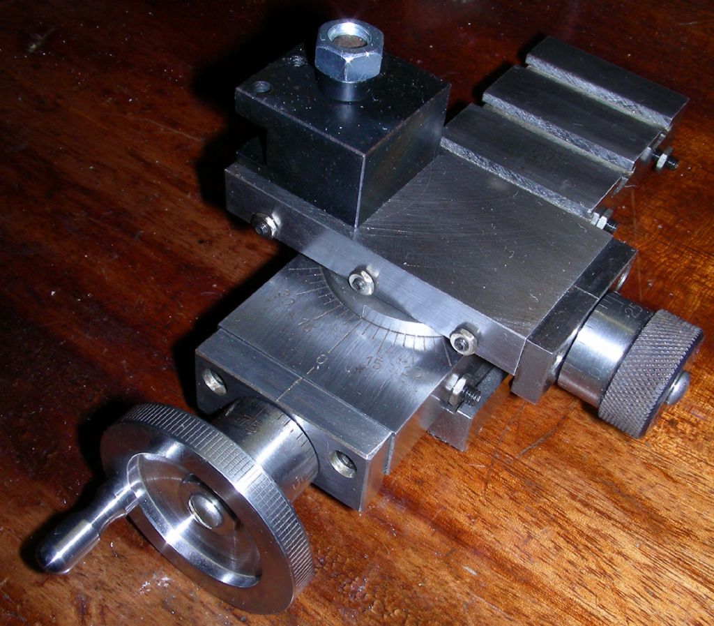

      Just a little preview "teaser" for an article I am working on which hopefully will appear in MEW before too long. I acquired the Cowells lathe shown in the pic below for a very decent price on Ebay recently (well, decent compared with what you pay for a good one!) & am in the process of restoring it to rather better health.
      Cowells 90 E Basic
      The next pic shows the saddle and slides after the application of a bit of TLC.
      Saddle/slide assembly after a bit of TLC

                Actually, nothing I have had to do to it so far has been particularly taxing – it's a simple machine after all – just lots of elbow-grease to get it clean and tidy. Just in the process of fixing the drive system – the original motor was shot (and dangerously so) so mine will get the VFD/3-phase motor treatment.

                      There's no big secret – just lots of elbow grease & judicious use of oil, white spirit (or paraffin if you prefer), Scotchbrite pads and abrasives. What I have discovered with this project is that a machine can look cosmetically apalling (as this one did) and yet once the cr@p has been removed it starts to look like a decent machine in no time at all.
                      It has been very satisfying to return it to (almost) its former glory – removing metal from the ways isn't a good plan, so without a full regrind I did get left with a bit of rust staining on the bed, and my paint job probably isn't up to the standard of the original, but it looks way better than it did.

                          Its coming on…remarkably, after a complete strip down and re-assemble, there were no bits left over…apart from the leadscrew, nut & handwheel that have yet to be fitted
                          Next stage is to sort out a new motor & speed controller & stick the whole lot on a new base.
