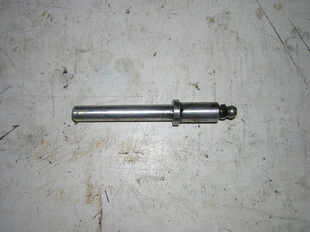

                                        I too have had the exact same problem with Myford oil guns.
                                        On the Myford forum someone suggested good results using a Tecalemit brass grease gun and an adapter designed by (I believe) Simon Collier, (although the drawing is signed Bill). Just received my gun and next job is to make the new adapter and test.
                                        eBay item number:112251173038 is an example.
