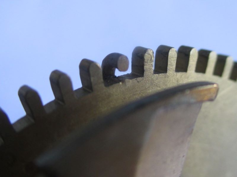

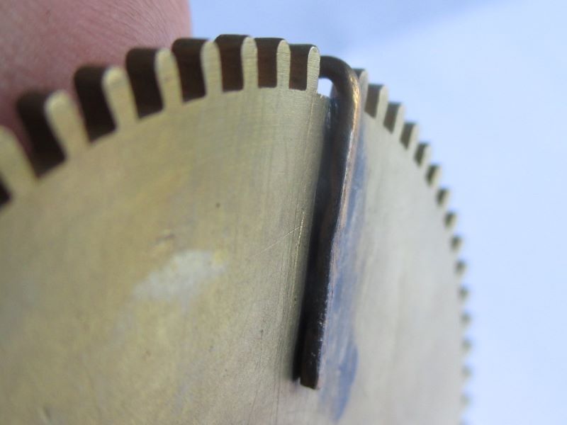

      A friend who is a professional Clock repairer/restorer recently shared these photos of an hour wheel, from a long-case clock which passed through his workshop.
      My initial reaction was:
      “Hideous as it may be … that hour-wheel repair is rather clever.”
      I then obtained his permission to post them here, for your consideration.
      This is neither a ‘how to do it’ nor a ‘how not to do it’ thread … but I will be very interested to see peoples’ opinions.
      Feel free to let the discussion include other scenarios; there are no rules !
      [ and if you don’t like the way the thread develops, please just ignore it ]

          Unsightly not hideous, but certainly clever.
          I wonder how long it has been like that?
          #433068
            Better for the "repairer" to work with what they had rather than leave the clock gathering dust and not working.
            Is the repair soft soldered to the wheel?
            Edited By JasonB on 13/10/2019 13:21:49
            #433073
              Posted by JasonB on 13/10/2019 13:21:38:
              Agreed, Jason … and yes.

                  I think this repair scheme, although not orthodox or elegant , should be high on the conservationists score as it neither adds nor subtract material from the original artefact and if adopted using modern super glue could be reversible with no lasting impact on the artefact. The orthodox repair usually required a slot or dovetail shape to be cut into the wheel and a single or multiple teeth usually donated by a similar wheel to be shaped to fit and soft soldered in place. Another accepted approach is to make and fit a new, signed and dated, wheel and leave the old one with the movement. If taken to the limit one could make a completely new movement and leave the old one in the bottom of the case where at least it won't wear out or need servicing again.

                      I find it quite pleasing aesthetically- but one query for the clockmakers- what is the impact of wheel balance on the movement both rotationally (with that tooth tending to slump to bottom of rotation) as well as altering load on the bearing points?

                        Looking at it from just the tooth side and not knowing anything about clocks I would have probably glanced at it and thought it designed that way and served a function for each revolution of the wheel.

                              I have seen a straight piece of brass shaped like a tooth soldered to the side of a wheel on a thirty hour long case

                                        The pinion is of course wider than the wheel and the repairer understood the principles of operation of a cycloidal gear.

                                          Lantern pinions are used in clocks, so this would probably worked fairly well.
                                          Not necessarily Engineering as we know it Jim, but it does the job. Far better than taking out of service or scrapping an otherwise good mechanism.
                                          You wonder how the original tooth became damaged.
