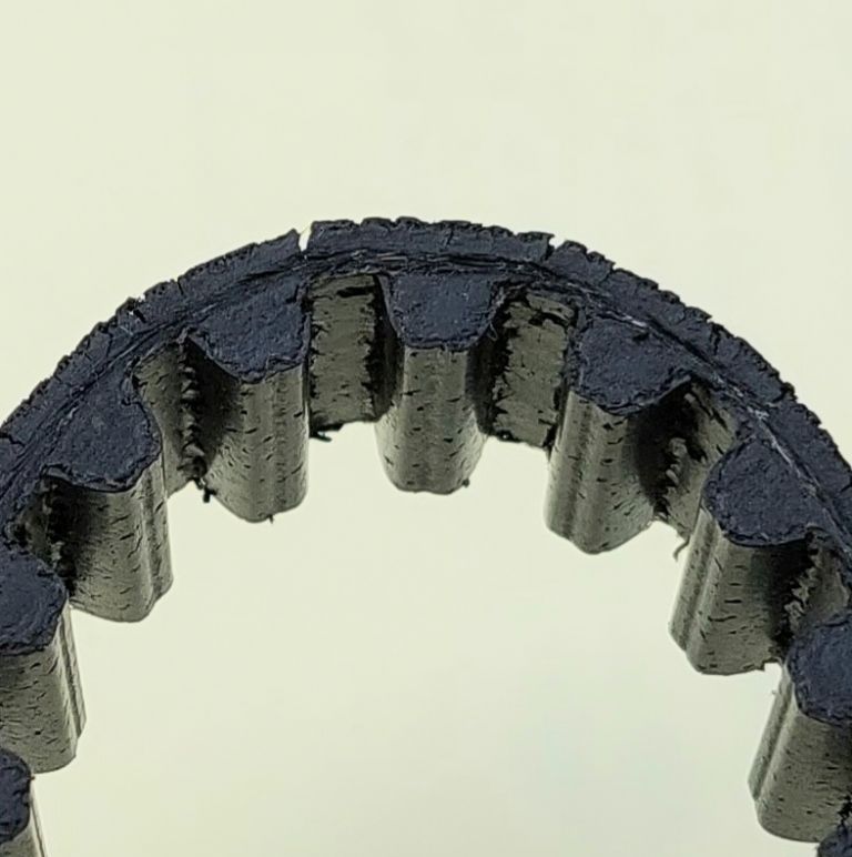

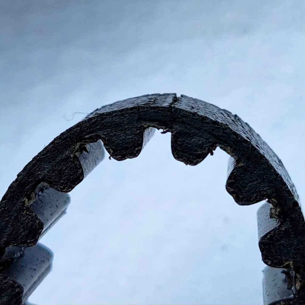

                              Just had the timing and oil pump wet belts changed on our 9 year old 1.0 Ecoboost C-Max at 60,000 miles. Looks like there was a good chance of it failing before the 10 year / 150,000 mile interval! There are multiple cracks half the belt thickness deep, across the full width. Ours has always been serviced by me with the correct Castrol Magnatec Ford approved oil and I never used any additives or flushes that some say can attack the belts. According to the garage and talking to work colleagues there are many wet belts failing after only five years and as little as 40,000 miles, don't know how many as a percentage though.

                                  One wonders how much of the belt has shed in the way of particles into the oil system as your photos show the belt beginning to deteriorate. Dave W

                                      Hi Dave, the sump had to come off for the job anyway so the oil pickup gauze was checked but all found to be spotless. Apparently in worse cases than mine even when the belt debris is picked off the gauze there can be some higher up which causes failure after the belt change.
