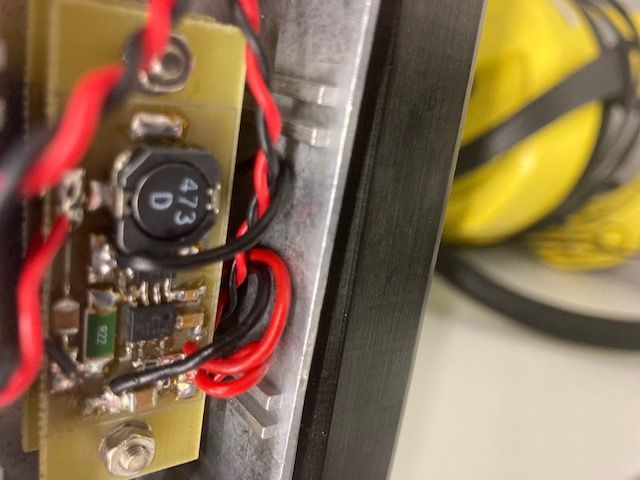

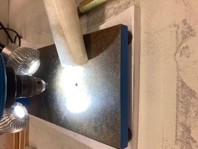

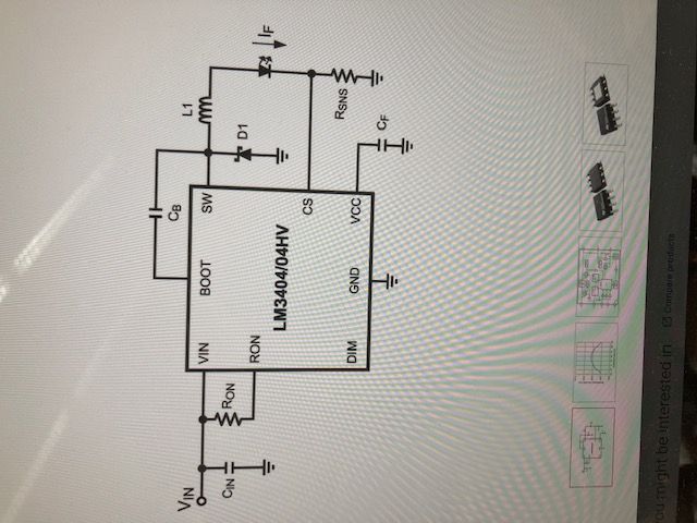

                                Fro your amusement here is a job I did a few years back. Worklighting on a PCB Drill.
                                It uses a Texas Instruments LM3404 and all the control is done by the switcher with the green current sense resistor providing the feedback. Volts in preset current out just connect the LEDs. I generally recon to get somewhere north of 85% efficiency.
                                regards Martin

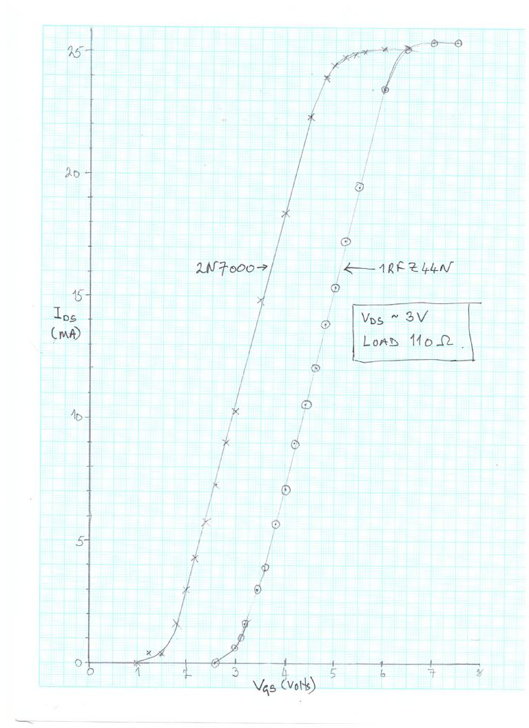

                                    A post postcript – this project rapidly got out of hand. I'd bought some high intensity LED's and after reading replies to my OP got them working with reasonable efficiency. Then I thought it would be nice to have them pulsing on and off in a random sort of way. I remembered that I have an Arduino Uno which I had never used and thought maybe I could do something with that. But maximum current from from the digital pins is a bit limited, so I bought some MOSFETs. No idea what I was doing so tested them:
                                    That gave me some idea of what they do – I'm very much in the shallow end of the pool I know, but I have to reason things out for myself. Slowly these days!
                                    It gave me confidence to to build a circuit which, with C/R timing networks, gives satisfyingly random pulsed lights.
                                    This electronics thing has now become something of an obsession – I can't stick the workshop temperature (at present about 10C), can't afford to heat it at current prices, but I can do this stuff in the house.
                                    My thanks again to those who have patiently given advice – somehow doing this simple thing has opened a floodgate in my mind.

                                      If you want to drive direct off an Arduino you'll do better with logic level mosfets. They manage with lower drive voltage
                                      #627136
                                      Robin Graham
                                        @robingraham42208
                                        Posted by duncan webster on 01/01/2023 00:22:48:
                                        Thanks Duncan – more useful info. I got around it by making a two-stage driver, but shall look at these devices.
