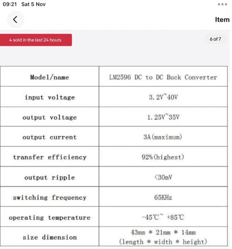

            I am still struggling to understand why the DC to DC converter that I mentioned is not the optimum solution.
            It’s even available from a U.K. seller at £2.35 with free postage
            … probably not worth putting a link here though.
            If the answer is “because I want to learn stuff”
            My response is “read the data-sheet”
            angel

                                  Thanks for further discussion. Tonight I had another bash at at analysing the Zener circuit in my opening post and hypothesised that I could work out the value R1 by adding say 20mA (to keep the Zener happy) to the current drawn by the LEDs. Then I re-read the thread and saw that was (essentially) what Clive said in the first reply. Sorry for not taking that on board earlier Clive. Doh!
                                  Working it out that way I don't gain much in terms of battery drain / heat dissipation in the limiting resistors by using this configuration. Wrong thinking on my part.
                                  Looks like a buck converter might be the way to go. I had never heard of such things until now.
                                  Or I could just notice that the switch I'm planning to use is actually DPST, so I could just go with the original AA powered fairy lights and the 'other gubbins' on 12V being operated by one  switch, which was my starting point. But where's the fun in that?
                                  Anyhow, thanks to all for input. For me this is really more about the journey than the end, and I like to take the scenic route.
