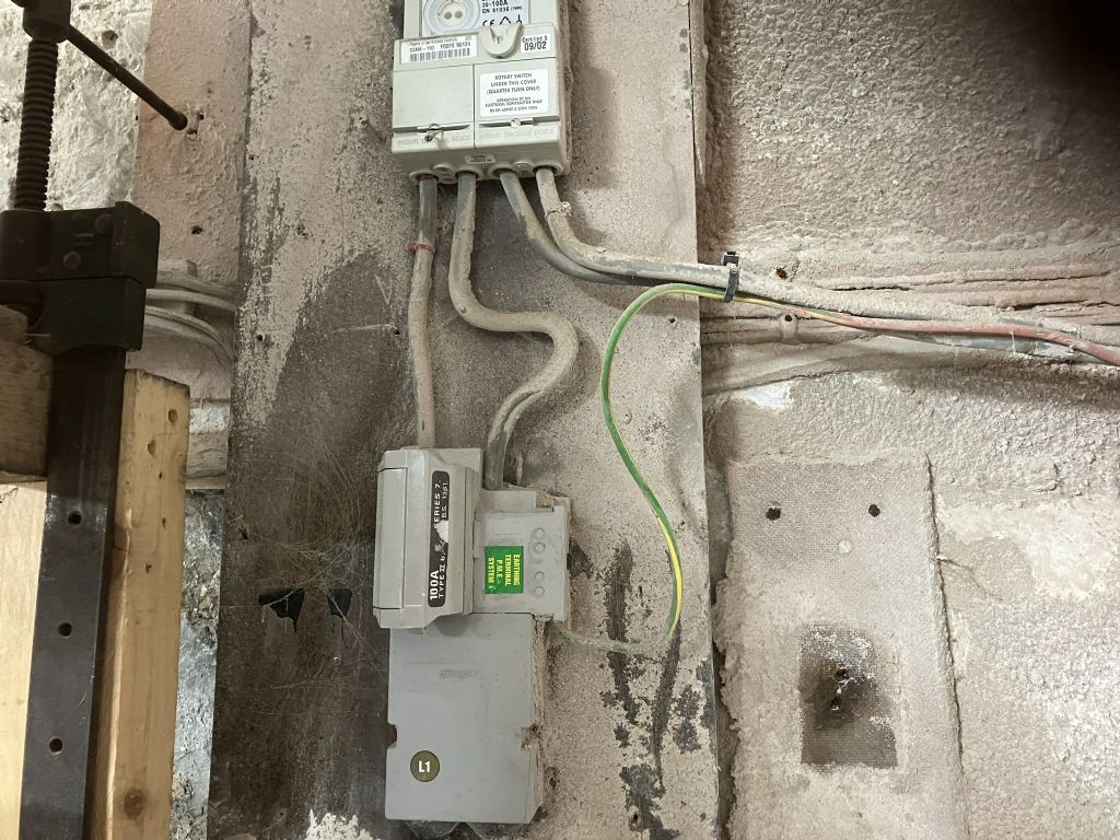

        This is quite fascinating. Much more complicated than I thought. Would I be right in thinking that if it could all be designed from scratch it would be possible to simplify? My house is maybe 200 years old and has seen many changes – the plumbing is crazy, lead water pipes in some places, dead legs all over the place and still after 7 years in here coming across lead gas lighting pipes. The electrics, though obviously more more recent, have clearly 'evolved'. Some black and red, some blue and brown. I suspect that it's a bit of a mess, though when I had the cellars wired up to make workshops the sparks tested the whole house and gave me a piece of paper saying it was OK.
        In the picture below is the bulging out bit before the meter a conventional (ie it melts) 100A fuse? The leccy comes in through the connection labelled L1. Strangely the bulgy bit isn't secured with a seal – I can wiggle it and suspect I could pull it out.

          Hi Robin, yes that is a fuse, and they do normally have a seal.

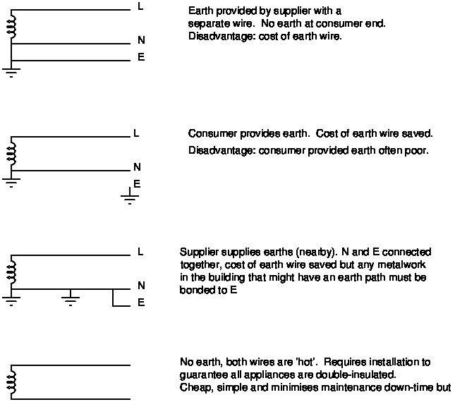

            I don't think so: the systems used are designed to meet requirements, which vary with circumstances. For example, the PME system common in modern homes is unsuitable for a long list of industrial needs. The house being 200 years old is a bit of a red-herring: although it may be wired as a patchwork, it's probably compliant with one of the legal alternatives.
            In the UK, there are (I believe), 4 basic single-phase variants, each with pros and cons:
            These days PME is preferred in UK homes, option 3 above, because it saves the cost of separate earth wires running back to the transformer and avoids the problems caused by dodgy consumer provided earths. Home earths suffer a multitude of practical difficulties – corrosion, difficult to fit in terraced houses with no gardens, water-pipes later converted to plastic, unsuitable geology, and DIY bodges galore. But there are circumstances where a consumer provided earth is essential, like a chemical plant manufacturing TNT. These earths have to be properly engineered, not just a spike banged into the ground.
            The last option, with no earth, isn't general purpose. An electrical engineer would recommend it for needs not met by more conventional solutions.
            I'm dimly aware what goes on abroad electrically may be different. For example, although rings are beloved in the UK (reduced cable costs), the rest of the world prefer spurs. Differences occur because the engineers who consider risks and requirements before setting standards respond to local needs. In the UK we were happy to risk 250V in the home (reduced cable costs again), whilst the US wimped out and went for 110V. The rest of the world decided we were both wrong and standardised on 220V. Similar local considerations led 50Hz vs 60Hz.
            The engineering logic isn't obvious, not least because standards rarely explain the background thinking or history. In truth most practical earthing systems are a compromise between safety, cost, and convenience. There isn't a single simple right answer that meets all requirements.
                The seal fairy must have stopped off and removed it.
                The seals are the property of the DNO and must not be removed by unauthorised persons. Some DNOs will permit registered electricians to remove them subject to certain conditions.
                Whatever you do, do not be tempted to remove the fuse. First, if you do it under load, you may suffer an injury from an arc. Second, you would feel pretty foolish if removal of the fuse carrier pulled the service head off the wall, or even worse, displaced one of the cables.

                    The type of supplier's earth depends largely upon the type of cable. PME (TN-C-S) is standard but a factory, for example, with its own transformer may well prefer TN-S.
                    It is safest to assume that all domestic supplier's earths are PME.
                    In the countryside, there may be no alternative to TT because of the distance from the transformer.

                          PME/TN-C-S. You can tell because the earthing conductor comes off the side of the service head.
