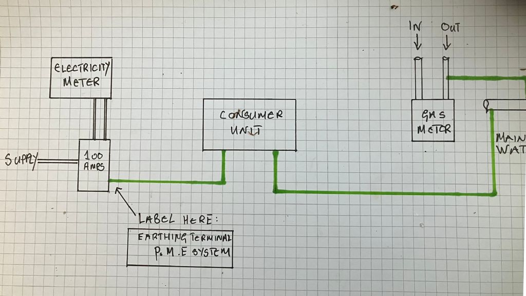

              Robin Graham
                @robingraham42208
                As often happens here, a question is asked, an answer is given, then a more general conversation starts. Which I like!
                I'm now wading my way through the acronyms (yeah, I know, initialisms if you prefer) in an attempt to understand how my house is wired.
                The earthing is like this:
                Ah, that's a bit truncated on the right, but gas meter goes to water main which goes to the CU.
                The CU seems to be locally earthed via the gas/water pipes, but if I've interpreted the label (Earthing Terminal P.M.E. System) on the box connected to the supply correctly my local earth is bonded to the grid neutral at this point. Is that right?
                Robin.
                Edited By Robin Graham on 09/04/2023 23:46:54

                Stuart Smith 5
                  @stuartsmith5
                  Robin
                  Your main earth is still provided by the earth terminal at the main fuse.
                   With a PME (protective multiple earth) system the neutral is connected to earth at the substation and the mains cable and individual service cables to each house have a combined neural/earth conductor rather than separate neutral and earth. At the meter position, the main fuse unit (cutout) has a fused live and the combined neutral/earth is connected to two terminals – neutral and earth to give the separate neutral and earth for the internal wiring. The neutral is also earthed at the end of the mains cable.
                  With a traditional system, the neutral is only connected to earth at the substation ( although it may also be connected to earth at other points if the cable has more recent alterations using combined neutral/earth cables or if PME type services have been connected to the main).
                  The earth bonding cables to the water and gas services are to ensure that the electrical earth and any other metalwork in the house are kept at the same potential. The downside of a PME system is that if there is a break in the neutral conductor , the voltage on the earth terminal in the properties past this point will be floating relative to true earth. The additional earth at the end of the main is to provide an alternative path and restrict this voltage.
                  Stuart
                  Edited By Stuart Smith 5 on 09/04/2023 23:55:53
                  Edited By Stuart Smith 5 on 10/04/2023 00:00:03

                        Robin Graham
                          @robingraham42208
                          Thanks for your detailed explanation Stuart – very useful. I had assumed that the connections to the gas/water mains constituted a local earth in that the pipes are (or were) metal and buried in damp earth.
                          Robin.

                          Emgee
                            @emgee
                            Posted by Robin Graham on 10/04/2023 23:50:48:
                            Robin.
                            If the supply type is a PME system the incoming water main if metal must have an insulated insert fitted to break the path to earth.
                            Emgee
                            #640879
                              Posted by Emgee on 11/04/2023 09:47:48:
                              Robin.
                              Emgee
                              I believe that's true, but why?
                              Not having studied the subject, I'd have guessed that an extra earth through a metal water pipe would only add to the safety of the system.
                              Is there a way a dangerous potential can develop between two earths in a PME system? Or is the ban in recognition that domestic supply pipes make rotten earths, and should always be avoided. Gas and water pipes are both likely to corrode, be insulated, have poorly conductive junctions including at the meter, and then be connected to a plastic mains in the road. Gas pipes are banned outright as safety earths because gas leaks and electrical faults don't mix.
                              Not an academic question. Radio amateurs living in PME houses often need multiple earths, for example: to stop static electricity building up on antenna; to ground electrical noise on the exterior of feeder cables before they enter the building; and again where cables connect to equipment. And what a sparky thinks is a good earth (between 25 and 3 ohms at 50Hz) is inadequate by radio standards! For example, a 3 metre whip antenna at 1.8MHz has a radiation resistance of about 0.2 ohms; connected to a 10 ohm earth, it can't be more than 0.2% efficient. This means a radio earth might be considerably lower resistance than the supply earth, but not engineered to take a heavy mains fault current.

                                  #640911
                                  Steve Skelton 1
                                    @steveskelton1
                                    Chris, yes it certainly would do no harm to put a plastic section downstream of any outside tap supply.
                                    The fitting of an insulating section to an incoming water pipe would, I have thought, be counter-productive on the failure of the neutral supply to a PME property. If any supply ie lighting, is switched on then the neutral and hence the earth cabling would become live. This would then cause the metal casing of all appliances and other earthed metallic class 1 fittings to rise to phase potential with the obvious result if touched whilst standing on a potentially earthed floor.
                                    If the water pipe is connected to the earth (via bonding) then the fault current is likely to pass down the water pipe through the class 1 items on the water/heating circuit and would likely cause disconnection of the over-current protection device on that lighting circuit – this would (if the only circuit switched on was lighting) very likely disconnect the phase from earth I.e cause the fuse/mcb to blow.
                                    Admittedly if a number of higher amperage circuits were still connected (through appliances that were turned on when the neutral was lost) then the resistance of the water pipe may not be adequate to disconnect all of the circuits.
                                    The solution to all of this is to fit RCD’s (or RCBO’s) to all circuits. I wonder how many people regularly test their RCD/RCBO’s????
                                    As a matter of interest, a company I have dealings with that test RCBO’s and RCD’s say that up to 10% of the units they test fail – even some new uninstalled ones have been known to fail.

                                        Chris Pearson 1
                                          @chrispearson1
                                          In response to Steve Skelton …
                                          The particular risk with an outside tap is that a user may be scantily dressed including no shoes and therefore be in good contact with the general mass of the earth.
                                          Indoors, a householder is more likely to be shod and standing on reasonably insulating materials such as a suspended wooden floor, or a solid one with a damp-proof membrane. So in the event of a lost neutral AND contact with an exposed conductive part such as the case of a toaster or your favourite machine tool, the householder may well get a nasty tingle.
                                          If the neutral is lost in the service cable to my house and I have plastic gas and water services, the leccy reaches the break and the voltage rises to 230 V, but it has no further to go. It backs up along the circuit protective conductors so they also are at 230 V. Everything is at the same potential – i.e. 230 V.
                                          However, if I have a metal gas supply (which I do) and my neighbour also has a metal gas supply, the neutral current can jump across to my earth at the intake and thence to the main earthing terminal, which is usually a plated block by the intake, but it can be in the consumer unit. The current now goes along the main protective bonding to the gas pipe along which it can pop next door. Then it goes along their bonding to their MET and then back down their neutral back to the tranny. The only evidence of this may be warm main bonding. So, in short, there are advantages in not inserting an isolating segment.
                                          Neutrals have not been fused for years. Should a neutral fuse blow, but not the line fuse, you are back in the realms of a lost neutral.
                                          It is important to realise that not only will an MCB or main fuse not protect you in the event of a lost neutral, neither will an RCD of any sort.
                                          If you live in the countryside with aerial cables and there is a storm and the telly goes off and the lights go dim, it may well be a lost neutral.Turn off the main switch and leave your lathe well alone!
                                          #640921
