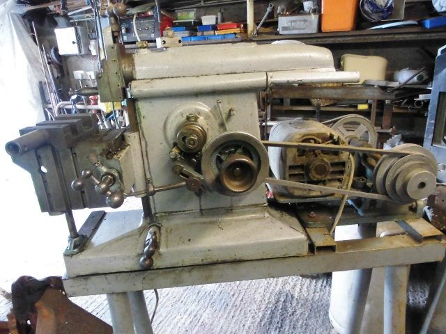

                    This was the machine as I got it. I don't have the original vice. As you can see it's pretty rough but it cost me very little and it was local.

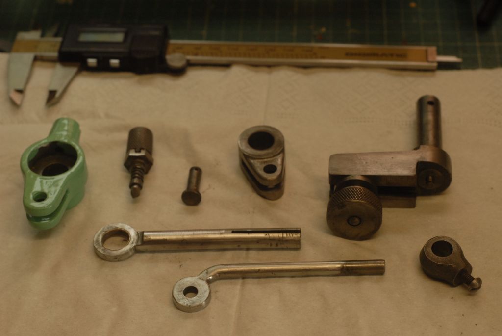

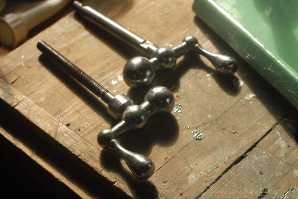

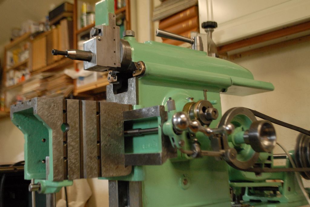

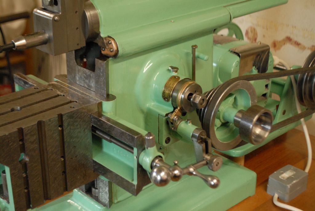

                          dsc_0104.jpgdsc_0093.jpghi John, I have all the brochures and the manual thanks all the same. Which parts of the feed are you lacking? Pic attached. Also pix of paintwork and polished ball handles.dsc_0095.jpg

                            @johnolsen79199
                            Mine is missing all the bits shown in your picture. They have been replaced by a very home made looking setup, which includes an extension on the end of the main shaft with an eccentric on it. Still, I don't think there is anything in your picture that I could not make.

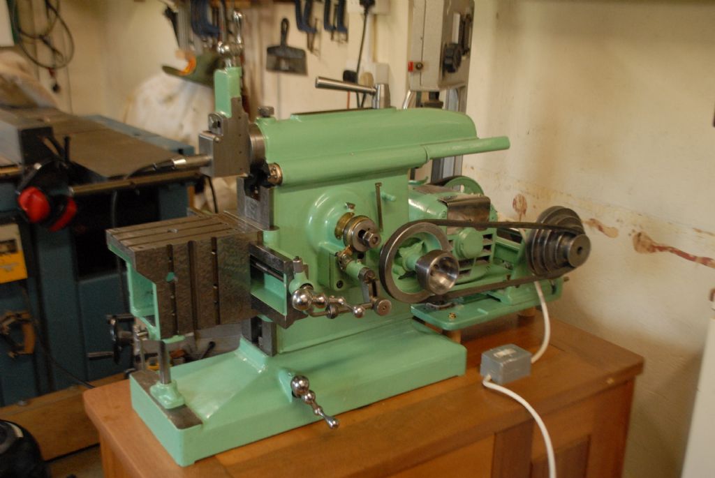

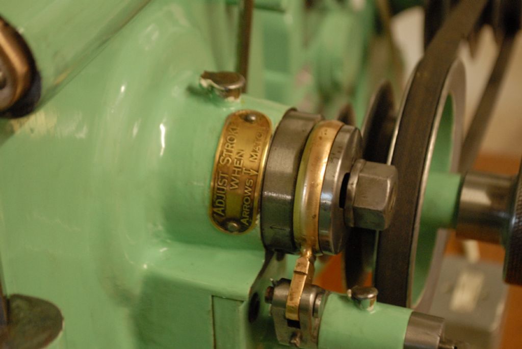

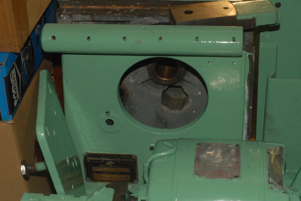

                              dsc_0068.jpgdsc_0040.jpgdsc_0039.jpgdsc_0036.jpgdsc_0031.jpgI've just got it back together but not tried cutting anything yet. There is a problem with the auto feed. It does not feed because the backlash in the screw is sufficient to permit it to just swing back and forth. It would need another ratchet like a lubricator has to prevent the backward [ very difficult to describe!]
                              #496636
                              John Olsen
                                @johnolsen79199
                                Usually with shapers when you change direction you have to turn the handle in the new direction a little to take up the backlash. After that, the friction in the nut is enough to stop the screw coming back. If it is not, then adding a little more friction to the screw would be the way to go. You may be able to do this by adjusting the end float. Another ratchet would be complicated and would also need reversing when you reverse the drive, which is why they didn't do it.
