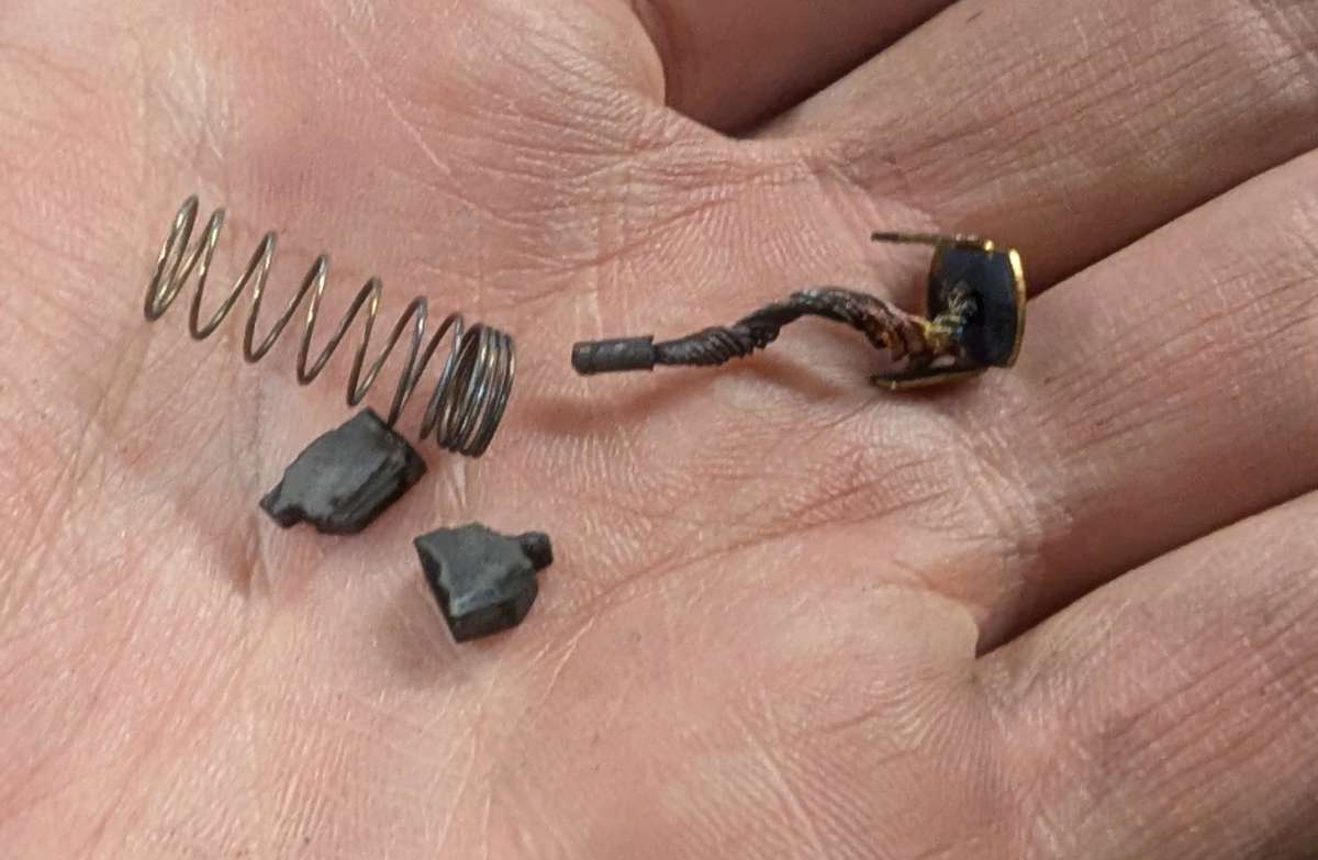

      i was machining some cast iron on Saturday when the mill suddenly went pop.
      It tripped the power, skipping the garage breaker and tripping the house breaker instead.
      Once I had sorted all that out, I found the fuse had blown, so I replaced it.
      I then found that the mill would not start. Multimeter out, the motor was still getting voltage to it so the controller was okay.
      So I took the motor brushes out to have a look- one had broken completely, and the other was looking fine.
      I have ordered replacements from amadeal so will be able to test in a few weeks when I am home again.
      Is uneven brush wear common in DC motors? Or does this look like a faulty brush?
      It is a 2014 model and I think I’m the 3rd owner, don’t know how much it’s been used, but minimal use from me.
      I did notice a while ago that the mill did not run in reverse at the same speed as it did forwards, could this have been related to the brushes? About a month ago it wasn’t wanting to start immediately, but once it warmed up it seemed to run just fine.
      Any thoughts?

        Looking at the old brushes it looks as though they are contaminated – oil ? The brushes need to be clean, run free in their holders and long before they get in this state changed OR they will wreck the commutator and then you will need a new rotor as well. Noel.

            Those brushes in the photos look to be quite badly worn and the one that is broken probably became too short to properly locate in the brush holders causing it to tilt over and break.

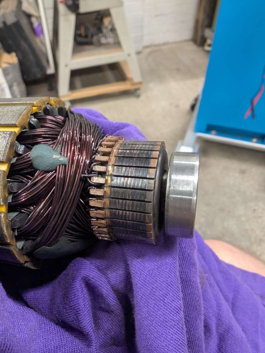

            Hopefully a new set of brushes will get it going again but I would also want to clean and undercut the commutator to clear any burning and remove carbon deposits from the commutator slots.
            If you feel competent to do so I suggest thst you remove the rotor, chuck it in the lathe and carefully clean (or indeed skim the surface if any burning is present) the commutator followed by cleaning out the slots that divide the copper to remove carbon deposits which will cause shorting if not removed. This can be done by using a piece of HSS (hacksaw blade?) to scrape the slots.

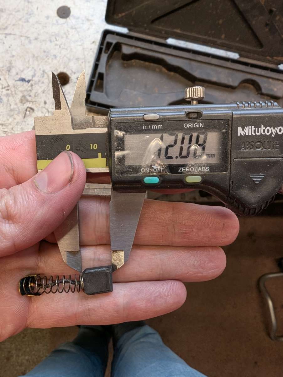

              Kent- Good idea with the commutator, I do have a lathe so I will consider this, I imagine a very very light cut just to clean the surface? The brush that is still intact is currently 12mm long, from my research the originals are 3.5x10x17mm. So it has only worn 5mm since the mill was made in 2014.

                I wouldn’t “skim” the commutator unless there is damage or burning to the surface. You can use some fine abrasive cloth to get a clean surface. When I was an apprentice we were all given a “com brush” which was a very tightly bound bundle of glass fibres about 6″ long – I’ve still got one somewhere. You had to press the end grain hard against the surface of the commutator whilst the motor was running. These brushes worked wonders to keep the surface clean. Bear in mind that this was on very large 110v and 400v DC motors of 19th century vintage – whilst they were running and in service. Can you imagine the H&S implications in this day and age?????
                It’s important though to make sure the insulation between the segments is clean and does not protrude above the copper segments, this will lead to arcing and commutator damage.
                It’s not so much the amount the old brush is worn, more the percentage length of unsupported brush protruding from the brush holder. If more is protruding than is captive the brush will become unstable and tilt when the motor spins, often causing the brush to chip at the end or break.

                    I guess the brush broke and shorted to the metal frame of the motor.  The short blew the machines internal fuse.  But, because the motor is earthed, the short also caused an imbalance between L and N that was detected by the trip, and it cut the power.
                    Not sure what causes uneven brush wear, which I’ve seen a few times.   I think if the brush material or spring is slightly different one of a pair might spark a little more than the other.  Once a brush starts to erode, I suspect the imbalance might cause faster wear on that brush, especially if the motor is worked hard.  Not a quick process, my examples had all done at least a couple of year’s work.

                        Uneven wear is common as manufacturing and assembly tolerances are loose. Slight misalignment of the guide and its dimensions, different spring rates, and that little copper braid can interfere. When you fit the new ones make sure they are not sparking or they and the commutator will soon die.
                        Avoid using abrasive paper to clean things as the particles will remain to continue grinding. The glass fibre brush mentioned above was to avoid this. You can get them in a pencil like form for cleaning printed circuit boards.
