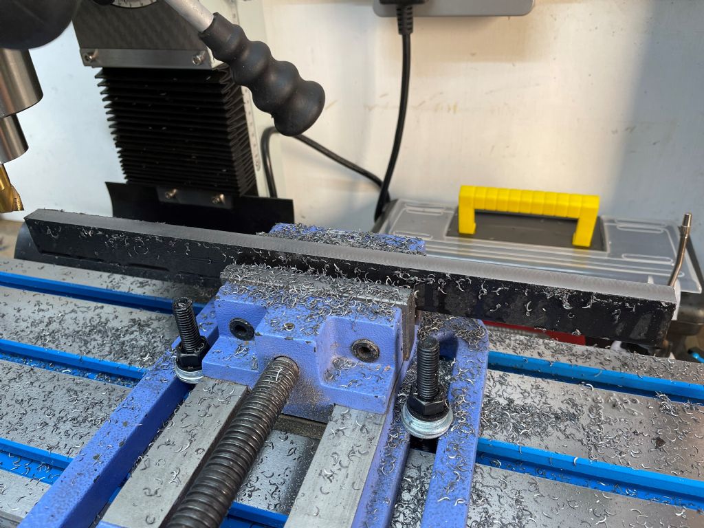

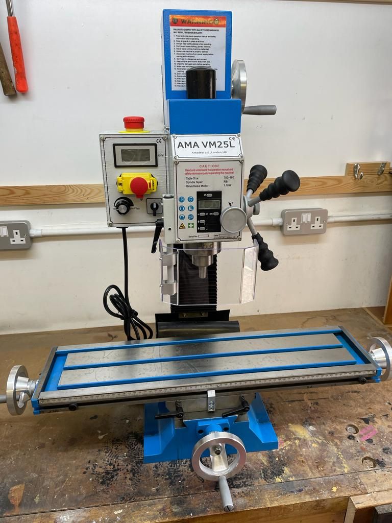

      Hello everyone,
      I have recently taken delivery of my very first milling machine an Amadeal VM25LV R8.
      My first impressions as a complete novice is that it seem pretty good, especially for the price. I can detect no play in any of the movements. I made my first cut on a piece of 12mm steel which came from an old shop display fixture, so the specs of the steel are completely unknown (not that it would mean much to me anyway).
      the steel was 350x350mmI and I wanted a piece 350x25mm finished size so made a rough cut with an angle grinder (don't buy Aldi cutting discs) and cleaned it up on the mill. I only have a small 4" bench drill vice so fitted this and levelled it as best I could by eye using a small steel rule.
      The result of this first cut is a variance of less than 0.5mm from one end of the piece to the other, which I think is pretty good for my first cut, especially given my rough & ready setup and all that overhang.
      I plan to drill a small hole on one end of this 350mm bar to hold a piece of 12mm steel bar, which will go in the collet and then attach a dial test indicator to the opposite end and use this setup for the tramming.
      I'm sure I am doing loads of things wrong and would be interested in any comments on this. I know I still need to securely mount the mill to the bench but I haven't decided its final exact location. Plus I want to rig up a drip tray of some sort so all the setup only gets done once (hopefully). I have a piece of aluminium sheet and have been watching some videos about hammer forming metal so we shall see.

          Nice try…..now to address the over hang, you could make some machinists jacks that would fit underneath the bar at either end….

              Please buy a proper milling vice, they are so much easier to use.

                Definitely get a milling vice. A totally different beast to the drilling vice you are using now and will help you to get more accurate results quicker. A rotating base vice is not necessary, in 12 years modelling I have used my rotating base just once and its not even thick enough to use as a doorstop in the workshop so if I knew then what I know now I could have saved a bit.

                  I have an Amadeal too – very satisfied. You will soon learn it's capabilities but 'start easy and work up' rather than down!
                  Strongly advise you follow the advise of all the comments but contrary to Jim Nic I would say that if you do get a vise with a rotating base then you have an 'attachment' that when wanted is an absolute godsend.
                  I agree – it's not used very often but when you want to swivel your vise you can guarantee the bolt holes wont align with the tee slots at the angle required. Yep you can clamp the vise down but if you have the base that's so much simpler.
                  Remove it as soon as you get it and store it under the bench – the vise will be much more rigid without it and less high

                    A drill vice is not rigid enough for milling.
                    Milling is effectively a series of interrupted cuts, the work need to be held securely.
                    Aligning the vice along the table, with a clock can be a time consuming task, so I made an alignment tool.
                    Look at the first photo in my albums (Dated 18/11/2020 )
                    The only parts requiring any precision are the bottom end of the pillars. they need to,be a really snug fit in the T slots (If they are not, the fixture will not align the vice very accurately )
                    The "cross bar" needs to be fixed to the pillars so that it is positively located and cannot move.
                    The trick is that having assembled the complete "goalpost" on the mill table, you take a light cut along the cross bar. In that way, when you clamp the fixed jaw of the vice to it, it will be against a face that is that followed by a cutter.
                    The only other things that need to be made are two T nuts, and two studs to clamp the whole device into mplace.
                    I used a couple of long M8 bolts that were waiting "To come in handy", but for another smaller vice, I used some M8 studding and flanged nuts.
                    Alignment time is less than 5 minutes, compared to possibly 20 minutes of winding to and fro, tapping to align,and probably getting very frustrated.
                    Using mine, and checking with a clock, the vice is usually within 0.001" (0.025 mm) over the 100 mm length of the jaws.
                    If your mill is decently trammed, you should be able to produce a part where the thickness varies by almost nothing.. A set of parallels, will help where the work is shallower than the vice jaws, and needs to be packed up to protrude above the top of the jaws by a distance slightly more than the final depth of cut.
                    You are generating a surface by moving the workpiece under the cutter, rather than forming it.
                    (As a guide, using HSS end mills, your fed rate should not exceed 0.002" (0.050 mm ) per tooth. So you will need to work out how fast, or slow, from speed of rotation and number of flutes.
                    It is a hobby machine, with limited power, and rigidity, do do not expect to remove metal at the rate which a powerful heavy industrial machine can. Overloading the machine will cause wear, at a minimum, or damage to motor, or gears as a worst case. Having said that, don't let the cutter idle on the work. That can can cause the cutter to rub,and overheat, which will ultimately blunt it.
