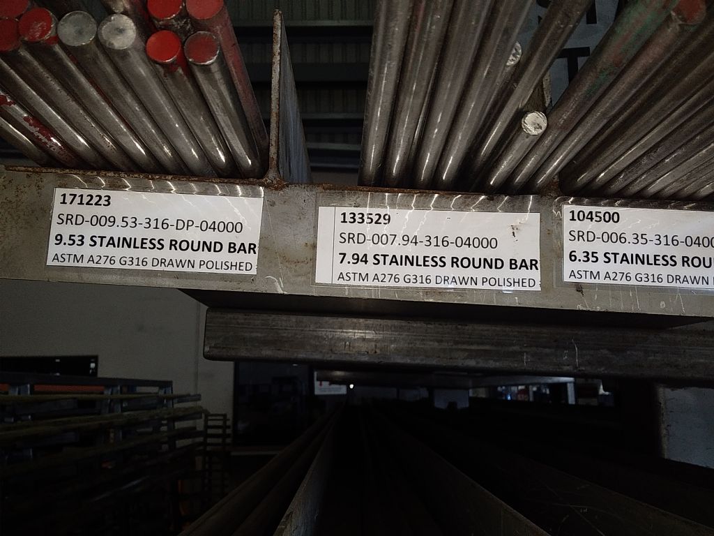

              Same thing at my local steel dealer recently: "We don't have imperial sized stock anymore. Gone completely metric."
              Yeah.
              Not sure if there is an ISO standard for 9.53mm bar, or 7.94mm or 6.35mm?
