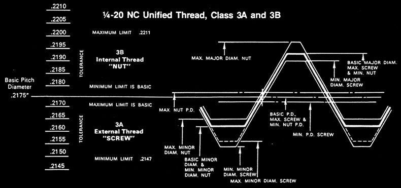

            Posted by Tim Stevens on 20/02/2022 21:00:18:
            And if you can tell the visual difference between a bought-in component with UNC threads, and one with Whitworth, please tell me the details of your optician.
            Cheers, Tim
            dont know
            It’s very easy with suitable visual magnification, Tim … [assuming, of course, that you buy your components from someone that actually makes them to spec.] … but I’m sure you know that.
            As requested: **LINK**
            https://www.moransopticians.co.uk/oct-eye-scan
            As evidence : This is a wax impression from the lens mounting ring of a Leica camera … which I photographed to demonstrate that the 39mm thread has Whitworth form:
            https://www.model-engineer.co.uk/wp-content/uploads/sites/4/images/member_albums/79913/897301.jpg
            The Whitworth profile quite recognisable to the assisted eye.
            Edited By Michael Gilligan on 20/02/2022 23:04:16

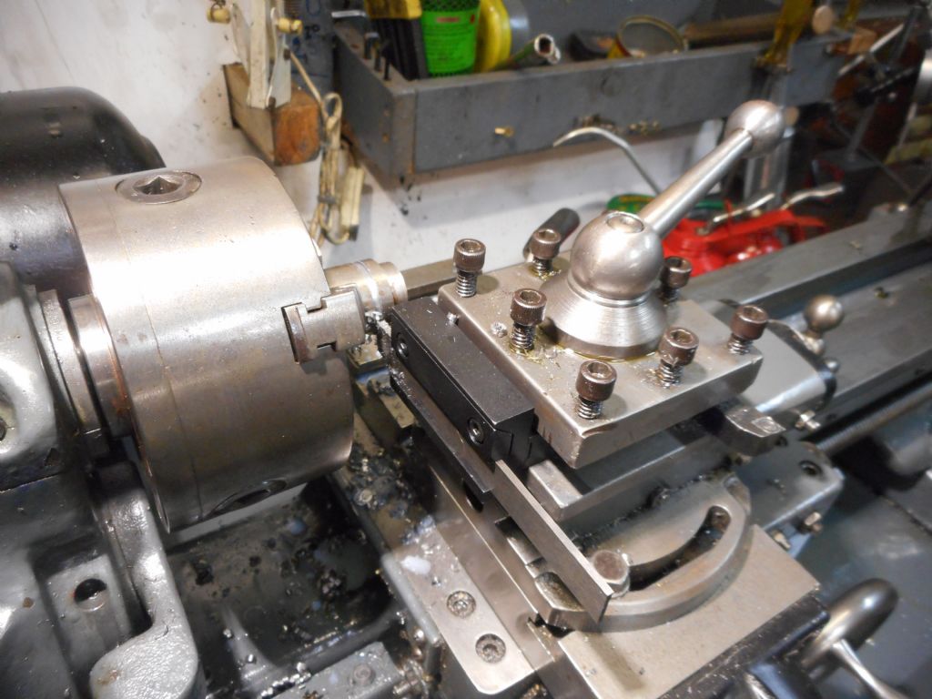

                    #586519
                    Hopper
                      @hopper
                      PS here you go. Brand new 1/4 UNC cap screws screwed straight into the original BSW toolpost holes as tapped by Myford at Beeston in 1957. Never a problem.dscn4314.jpg
                      And 5/16 UNC cap screws screwed into 5/16 BSW holes I tapped myself with a BSW tap on this four way toolpost I made for the Drummond.

                          Posted by Hopper on 21/02/2022 03:57:26:
                          Posted by Emgee on 20/02/2022 22:22:54:
                          Absolutely not so.
                          I screw UNC bolts into BSW tapped holes all the time and have never had one that did not fit. Mass produced nuts and bolts are made to loose tolerances and BSW/UNC fit together just fine as a result, as long as TPI is the same for the diameter. That is why when you screw say a UNC nut onto a UNC bolt, you will feel the nut is free to wriggle about. They are not made to tight enough clearances where both sides of the thread flanks are in contact.
                          … and there’s the rub [or lack of it]
                          “Mass produced nuts and bolts are made to loose tolerances.”
                          The UNC system allows one to specify the ‘Tolerance Class’
                          Edit: __ A useful illustration of class 3 [which has tighter tolerances] can be found at:
                           https://www.newmantools.com/taps/taptech.htm
                          and I have reproduced here with due credit
                          Edited By Michael Gilligan on 21/02/2022 08:56:33

                                      Hopper
                                        @hopper
                                        I wish they would send us UNC threads with BS heads! At least you only need the one set of spanners per vehicle then. As it is now, all too often an old bike will have a mixture of BS, AF and metric hexes dotted about it.
                                        But I am guilty of creating my three penn'eth of confusion, making tooling for my Myford I find myself making things like a rear toolpost mounting stud with a 7/16 UNF thread because that is what taps and dies I have, but I machine my own nut for it with BS sized hexagon so it matches the Myford standard spanner set on the wall behind it. Someone in the future will be scratching their head over that one.

                                        Emgee
                                          @emgee
                                          From what Hopper shows in the pics it seems I have to dump my old 1/4" W taps as they must be worn beyond the limits, or buy some low cost UNC screws when needed.
                                          Emgee
