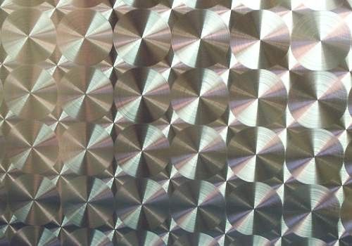

        Russell Eberhardt
          @russelleberhardt48058
          There's no problem using steel or aluminium other than cosmetics. Steel will need some rust proofing unless it's stainless. Aluminium needs to be a hard alloy so as not to distort and could be finished with graining like this:
          If using ball bearings make sure you use stainless steel bearings and wash out all the grease with white spirit before use.
