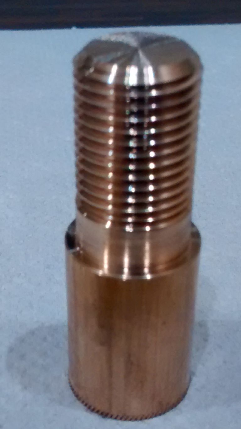

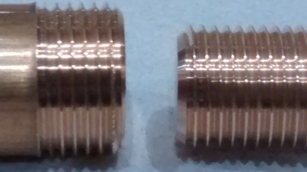

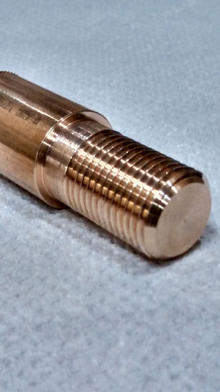

                            Some pictures to show a few test threads done with a PlanetCNC controller running on a Denford Starturn 8 lathe of 1985 vintage and were generated via the lathe wizard in the software. Both pieces are 1.5mm pitch, one at 19mm diameter and the other at 16mm.
                            I did video the process, but the frame rate is very slow and doesn't do justice to the smoothness of it all. In reality, the movements are very similar to those in Steve Blackmore's video of his dedicated lathe controller, shown earlier in this discussion. I'll try to redo the recording with a better camera, but what was interesting to me at the time, was that I was able to cut these threads whilst recording the camera to the same computer without a hiccup.
                            Setting up the controller software was quite straightforward except for one thing, which was that I found it necessary to enter exactly twice as many pulses-per-rev for the spindle encoder than the number of slots within it – mine has 100 slots, but this caused a specified 1mm pitch thread to be cut at 2mm pitch – maybe because channel A+B count 100 slots each per rev?
                            Martin.

                            #260071
                            Anonymous
                              Pretty darn impressive threading. thumbs up
                              Andrew
                              #260072
                              John Stevenson 1
                                @johnstevenson1
                                Martin, which card did you use please, the 4 axis or the 9 axis ?
                                #260073
                                blowlamp
                                  @blowlamp
                                  Andrew. Yes, being brass helps, but still not bad at all for a small lathe, I'm very pleased
                                  John. this is the Mk3/4 board, so just 4 axis.
                                  Martin.
