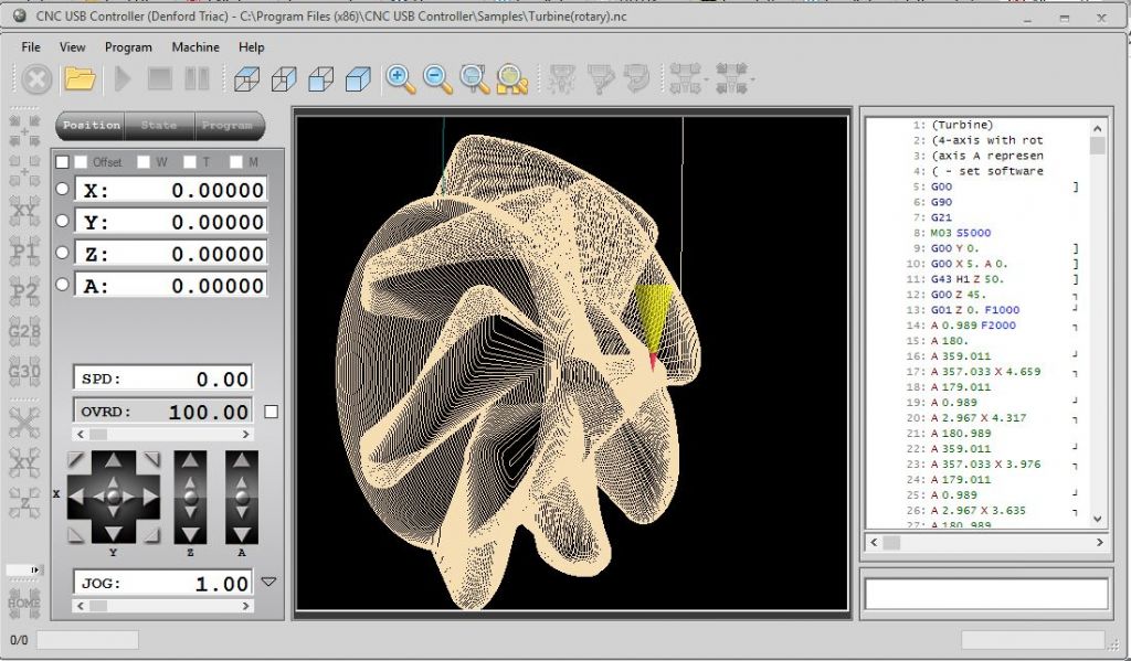

                                #259059
                                blowlamp
                                  @blowlamp
                                  Posted by Rod Ashton on 03/10/2016 18:36:41:
                                  Martin – On the upcoming todo list. Wondered if it was easy to setup.
                                  Rod
                                  Rod.
                                  I just changed my configuration settings for you.
                                  I haven't cut anything or even run the machine, but it was just a matter of changing the machine type to Rotary under Settings > General and then adding the 'A' axis under Settings > Axes.
                                  Here's a demo rotary axis screen shot of a turbine.

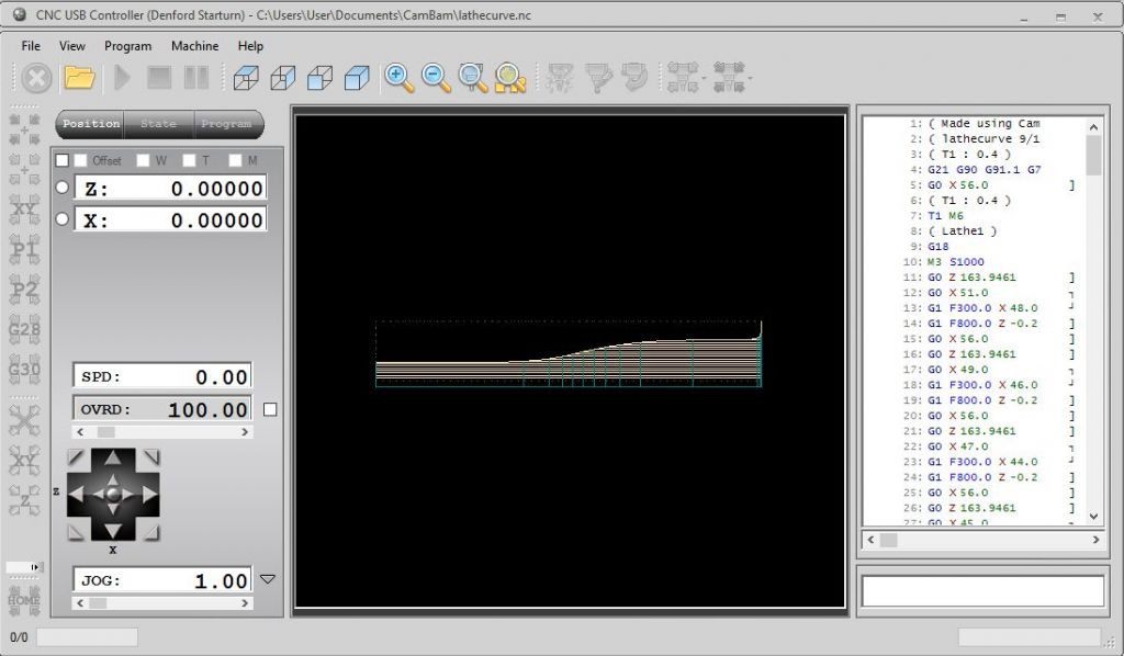

                                  #259062
                                  blowlamp
                                    @blowlamp
                                    For the lathe folks, here's a pic of the controller set up for use with a lathe.
                                    To get the Z & X axes in the right orientation for a lathe had me scratching my head for a while, but I got there in the end by going to Settings > User interface and entering 270 degrees into the X & Z boxes under Rotate. The manual suggests entering 90 degrees in the Y box although this means having to use Front View, whereas my way allows Top View to be used, which is more intuitive to me.
                                    Martin.
