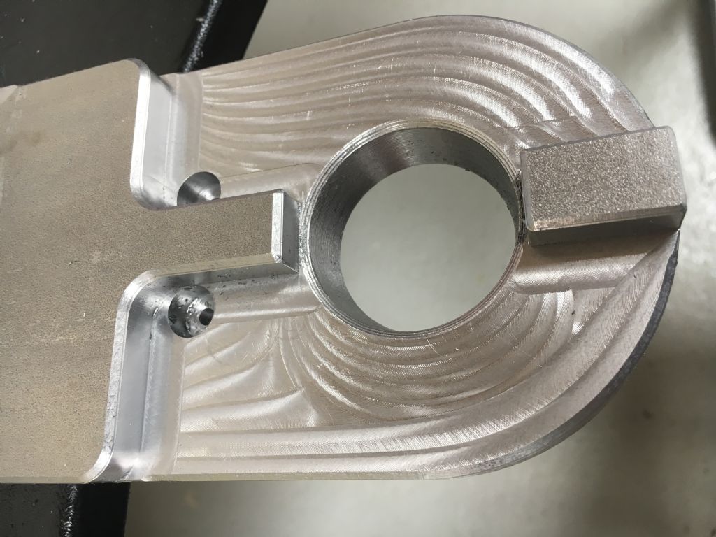

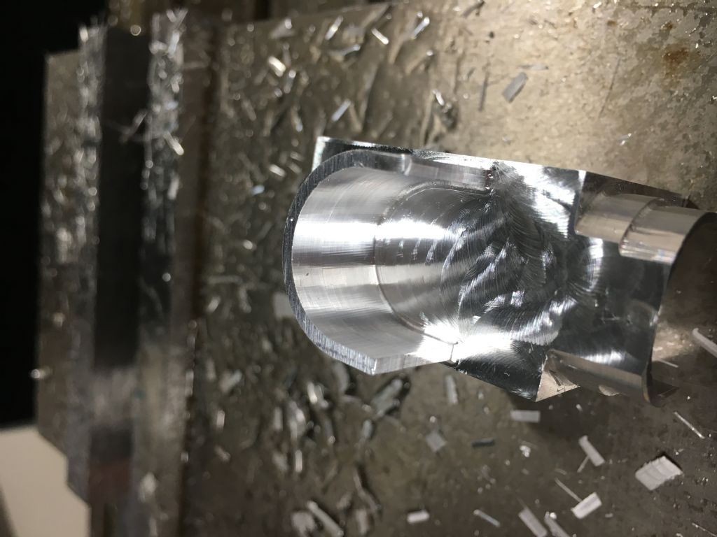

                                        #304017
                                        Muzzer
                                          @muzzer
                                          Quick update on recenet progress – a major woohoo milestone was achieved yesterday. I managed to complete a moderately complex part using 6 operations and 5 tools, making use of the prepopulated tool table to set the tool lengths:
                                          1. 3D adaptive clearing with 20mm YG-1 rougher (done)
                                          2. 3D adaptive to clear up with 9.5mm carbide (actually 3/8&quot end mill
                                          3. Bore out the counterbores for the cap head fixings with the 3/8" end mill
                                          4. Drill out the clearance holes for the cap head fixings (4mm drill)
                                          5. 3D contour to clean up the taper bore with Mitsubishi BP300 indexable tool (0.8mm radius) using fine stepdown
                                          6. 2D chamfer to clean up the top edges (1/2" carbide tool) – where the tool can get in.

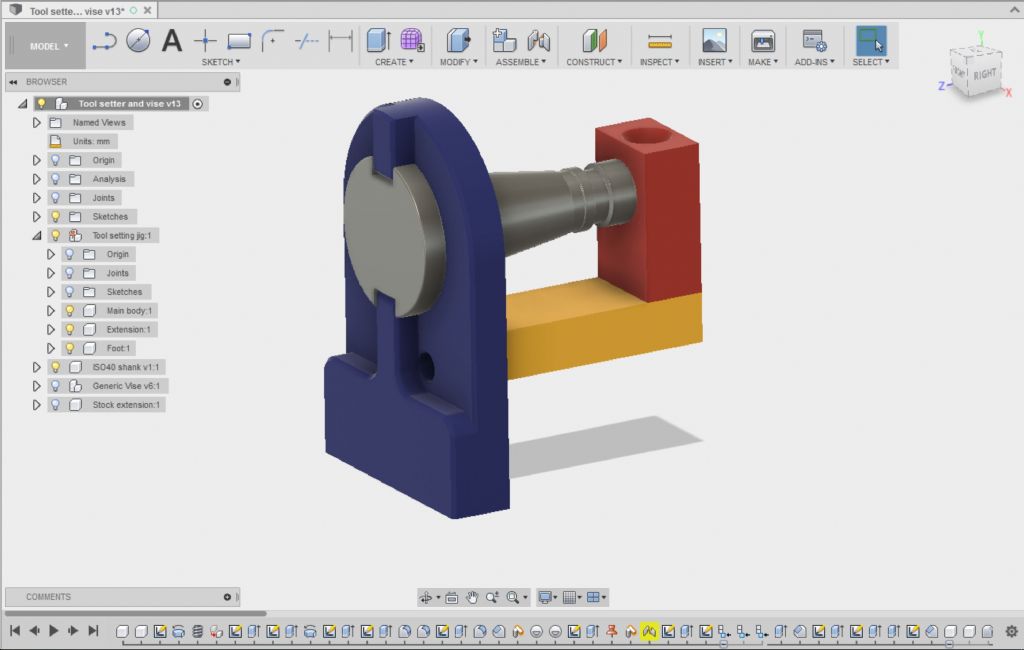

                                          The CAD model and CAM toolpaths etc were made in Fusion 360. Tool lengths were previously set up semi-automatically using the in-built macro and the electronic tool setter I made a couple of weeks back.
                                          I ended up loading and running each operation one at a time, to allow blood to drain back into my knuckles and buttocks after each success.
                                          I've ended up with the part looking pretty much like the CAD model, no tool breakages, no mud made(!) and a feeling of great relief and satisfaction. It's the blue bit in this assembly:

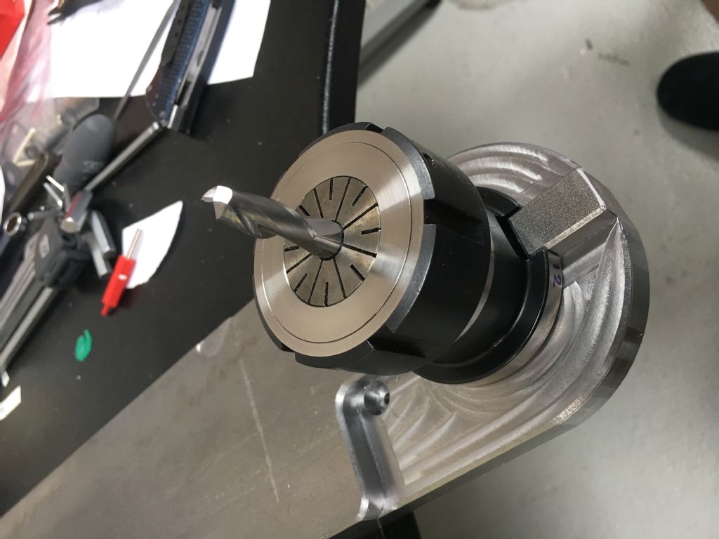

                                          Complete assembly
                                          It's a fixture that holds a ISO40 toolholder while the collet etc is tightened. It could also be used to set and measure tool stickout etc but with the tool table macro feature combined with the electronic tool setter, the latter function doesn't look necessary. To finish it off I need to make up the extension piece and foot. These allow me to secure the toolholder with an M16 finger screw while tightening the collet.
                                          After I'd completely finished designing all the parts, I rotated the main component to do the CAM work and noticed it looks like a Startled Man. So that's how I now refer to it! Completely unintentional.
                                          Startled Man
                                          Trial fit:
                                          Trial fit

                                          #304109
                                          Anonymous
                                            Posted by Muzzer on 24/06/2017 14:55:12:
                                            Bl00dy hell; got to be worth at least a triple woohoo, plus beer! I'm mighty impressed; nice finish too. Is it hot rolled steel?
                                            Andrew
                                            #304113
                                            Muzzer
                                              @muzzer
                                              Yes, they (Jenkins Steel) only had hot rolled steel in this size (25×100). Funny how the finish looks a lot better in the flesh than in the photos. Pretty pleased with it as a starter.
                                              The bummer is that I'm off to China for 3 weeks (flying tomorrow), so that's it for the moment. Back to the armchair / hotel workshop….
