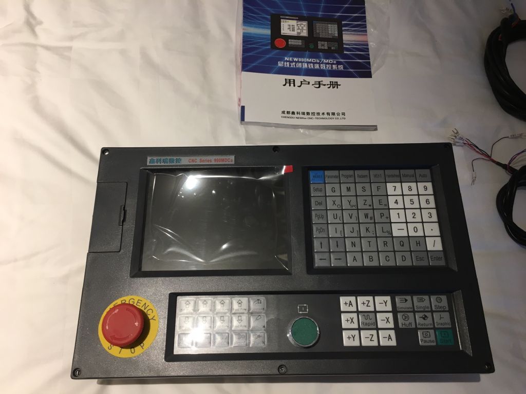

        I've just indulged in some shameless chequebook engineering. This is a 4-axis controller of a similar type to the lathe controller JS mentioned earlier in this thread. Obviously it's set up for 4-axis CNC milling rather than 2-axis CNC lathe control. This is a kind of self indulgence to make up for spending the last 2 weeks in China and should reduce the time and cost of carriage, as I brought an extra suitcase with me. Total cost for this was pretty much bang on £400, which compares favourably with the cost and ball ache of assembling a PC, BOB, monitor, software, keyboard etc.
        Newker 990MDC
        Overall, doesn't look too bad. I haven't opened it up to look inside but it claims to have an FPGA for the fast stuff and a 32 bit ARM cored processor and DSP. Also comes with a set of connectors with labelled cable tails. Time will tell how well it works but if not obviously I will blame JS.
        I've already started to translate the user manual into something readable. The Chinglish is very strong. If it's a Fanuc clone as I think JS suggested, I may have to download the equivalent Fanuc manual to see if it helps.

          Posted by Muzzer on 13/03/2017 10:58:06:
          I've just indulged in some shameless chequebook engineering. …………..
          Nowt wrong with that. A definite woohoo, and should keep you out of trouble, and in the workshop, for a while.

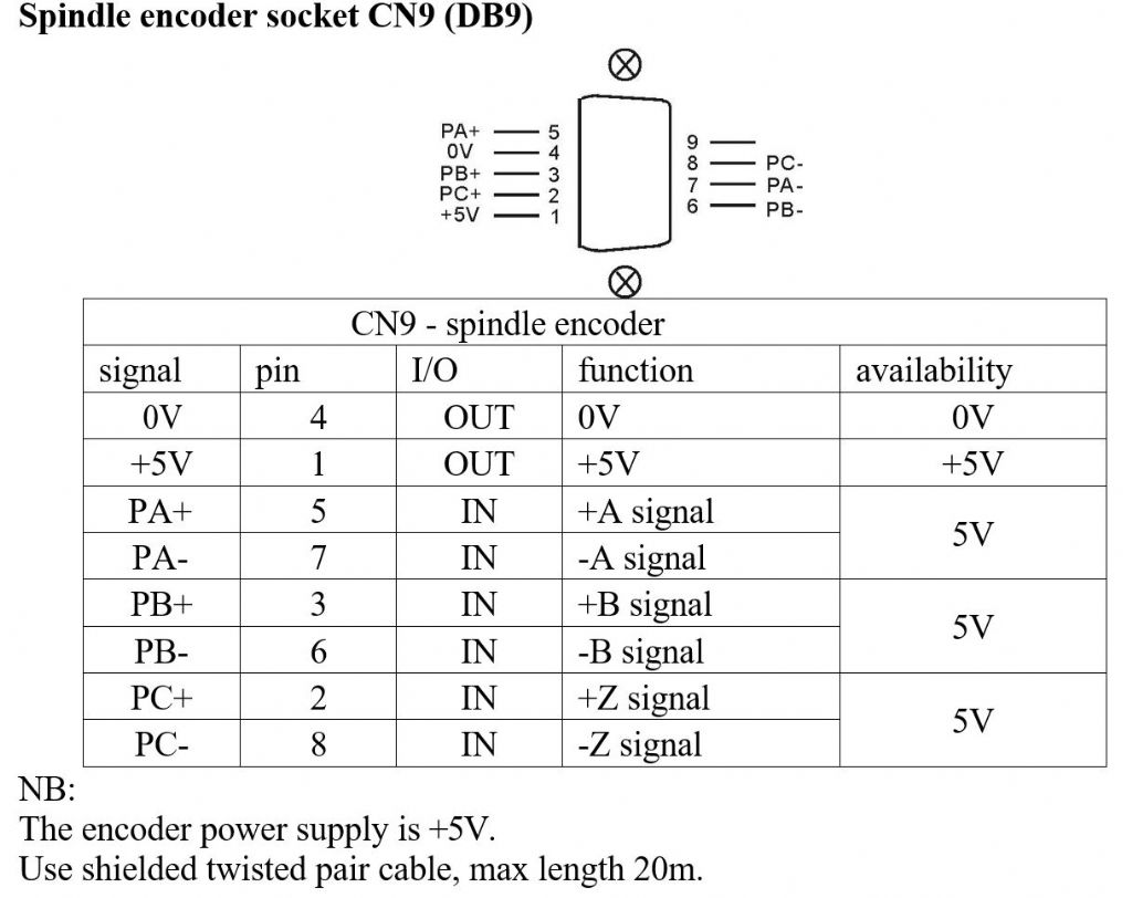

              Are you sure about that, Richard? This is from the manual I've been cleaning up and digesting recently. There are also quite a few "electronic gear" functions for driving one axis from another, including the spindle.
              Do you have the manual? I can send you a copy if you PM me.
              Murray

                Murray, you are correct because Steve Blackmore has had his threading straight out the box, even done some triple start threads.

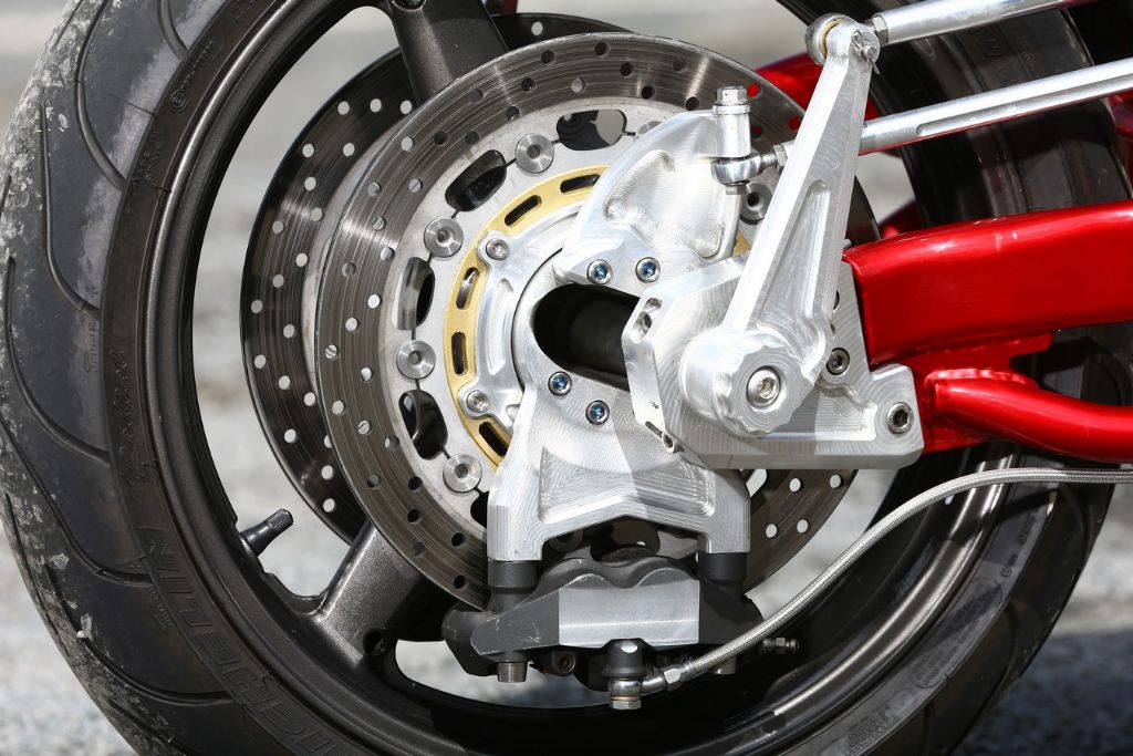

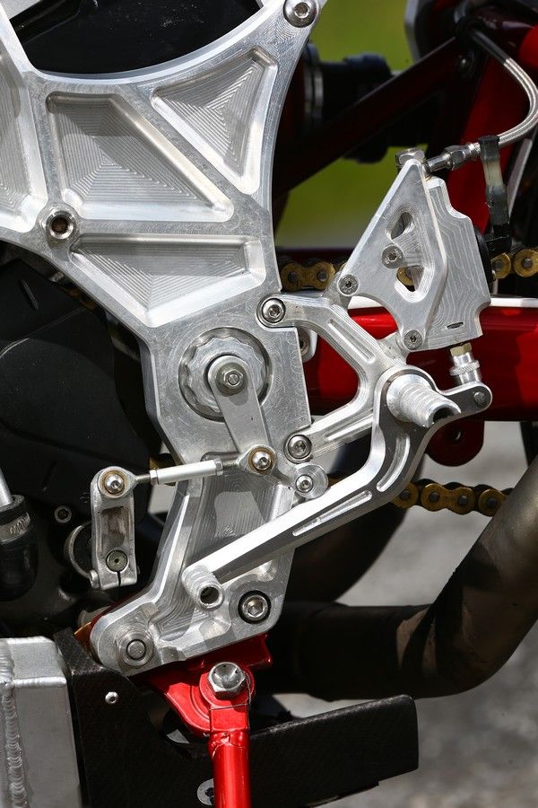

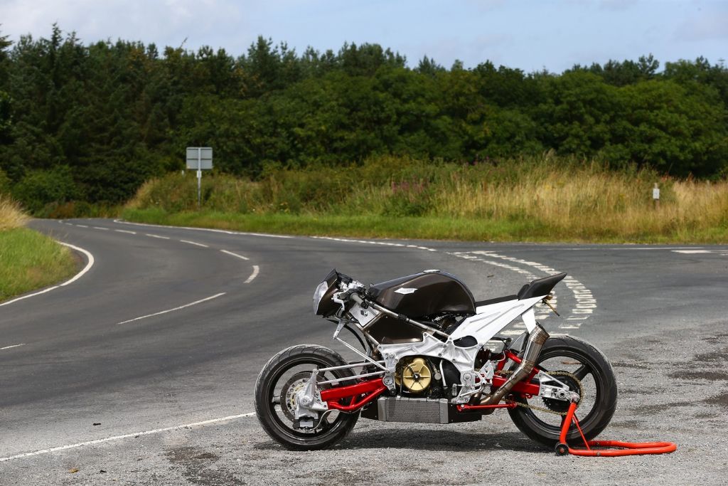

                            I'm looking to upgrade my kit, I already have a pretty good 4 axis CNC mill setup at home I just want to get away from the PC keyboard etc.
                            I'm starting to get to grips with it now, here's somat I made earlier with it………….wink
                            For interest I've put a few more images of this in one of my albums

                              Posted by Involute Curve on 15/03/2017 18:12:12:
                              Shaun
                              I hardly dare look, Shaun … that is magnificent !!

                                Shaun, that looks spectacular.
                                And seriously uncomfortable for long journeys!
                                  Crikey Shaun, that's really, really sweet!
                                    Shaun
                                    That looks A1!
                                    Would you be willing to send me a few hi-res versions? I'd love to print an update on your article written when it was half-done! I reckon most readers wouldn't begrudge a page or two plus a few words about the machining setup!

                                                Cut my first air on the Shiz this evening using the new Chinese controller. Woohoo!!
                                                Neil – hold on to your dinner. BTW, you still haven't sent that tripod you promised me last time.
                                                More details at http://www.murraye.com
                                                Murray
