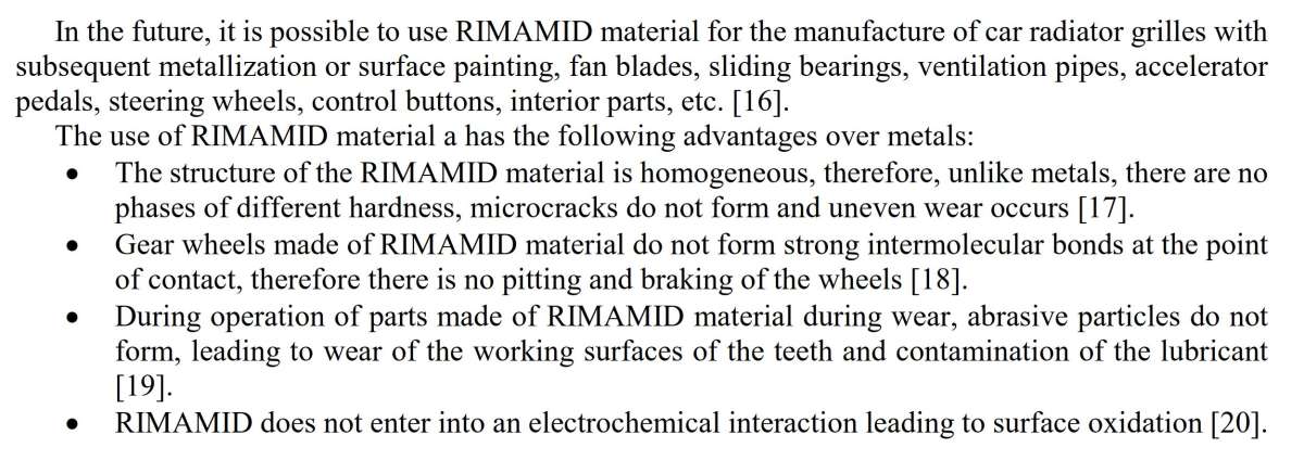

                  Its supposed to have 10x the wear resistance of bronze.
                  Some stated advantages over metals:

                          Based on the name I would assume that the compound in question is an aromatic polyamide or aramid, as is Kevlar. It is likely however that there are differences in molecular structure between the two – if only for patent reasons.
                          Perhaps more critical issues are how the amide fibers are bonded, epoxy? nylon? acetal? to create a fiber filled solid and also how much fiber is in the mix. These will affect both wear and slipperocity (new term for the occasion).
                          From a quick internet search Kevlar seems to be readily available in solid form as Kevlar filled nylon – at eye wateringly high prices!

                              […] Perhaps more critical issues are how the amide fibers are bonded, epoxy? nylon? acetal? to create a fiber filled solid and also how much fiber is in the mix. […]
                              According to the bullet-points that Bill posted … it’s homogeneous
                              I wonder: at what level of detail ?
