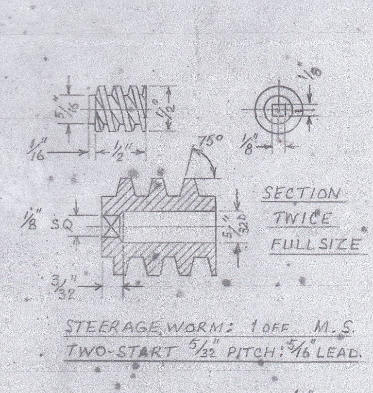

      The worm and wheel steering gears on my 1.5" Allchin are commercial items, bought, years ago, from Reeves. They are 4-start. This makes for quick steering action but don't look very prototypical with a worm of rather small diameter and this has always irritated me, so I'm considering making new ones which seems to be an interesting mini-project.
      The Hughes' design calls for a 2-start worm of 5/16" lead, of which he writes "screw-cut in the ordinary way". Same for the hob. Even single start at 5/32" lead seems daunting to me. Has any-one done this on a typical model-makers lathe? Seems a recipe for possibly chewing up the change gear train.img_20220927_0001.jpg

            In general single start is prototypical; anything else will back drive. On my engines I threw the drawings away and designed my own single start worm and worm wheel. On my 4" engine the worm is 1.5" OD, so 1/2" seems a little small for 1.5" scale. Can't help with the screwcutting as I CNC milled my worm. These are finished gears:

              Prof. Chaddock suggested driving through the leadscrew for the Quorn column thread, but he used a milling spindle for the square thread form rather than a single point tool, which would still require a lot of torque through the gear-train to turn the chuck. My Boxford has Tufnol tumbler gears and I don't want to break them.
              Nice work Andrew. Hughes suggests 2-start as a compromise between steering and appearance. I'm inclined to go for single start to make things easier, but the job's still at the "thinking about it" stage.

                Posted by Clive Brown 1 on 27/09/2022 16:54:44:
                Jumping off from your observation above, could you use a milling machine to thread mill the worm?
                Let us assume it has a 5 (or 25/5) tpi leadscrew: the required tpi of 5/16" lead is 16/5 tpi. So you gear between the leadscrew and a simple spindle holding the blank (e.g. spindexer, vertical rotary table with worm out of mesh) in a 16:25 ratio (32/50, 48/75 etc.). Any old idler gear(s) to make up the height between leadscrew axis and workholding spindle axis.
                It is like a very basic version of spiral milling using a dividing head.
                You could rough out the blank using a normal mill no bigger in diameter than the root of the thread. Then make a D-bit or buy a tapered endmill with 30 degree included angle. As your gear ratio has an even number in it, it is easy to index for the second start by disconnecting the gears and rotating 180 degrees.

                  The drawings for my engines called for a 2-start 1/2" pitch, 1" lead worm and a mating spur gear but with teeth on a slant. However, the dimensions didn't add up and information was lacking, so I re-designed, sticking with a 2-start worm. My lathe will cut a 2tpi thread, but not 1tpi. So I decided to use the CNC mill to make the worm. On another forum it was pointed out that a 2-start worm will back drive. So I changed the design to single start and also a single enveloping worm wheel to match full size. I stayed with using the CNC mill for the worm, as I was concerned about using the lathe to cut an Acme full form 2tpi thread; the lathe leadscrew is 4tpi.
