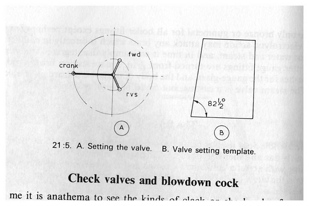

      I'm not at all into TEs but am intrigued with mechanical motions. I've just been looking at a simulation of Stevenson (not crossed) that shows the eccentric pins at 80 degrees either side of the crankpin. Am I mis-reading Nigel's pictures because to me the eccentric pins look as though they are at 100 degees or more eitherside of the crankpin.
      Nigel, Where is your 82 degrees referencing to and from?
      Is this something to do with the crossed eccentric links that is not yet apparent in Nigel's setup?

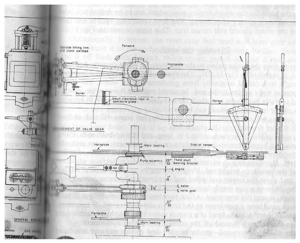

        Hi everyone
        Thanks for all the interesting replies.
        I am not sure what you mean by normal or crossed eccentric links but I hazard a guess that these are normal and crossed would have the eccentric arms connection to the reversing link swapped over.
        For your reference I have attached some info from the Allchin book which I hope answers your questions.
        For now I have to leave it a few days. I feel confident it's OK and will run it on air a a couple of weeks.
        Thanks
        Nigel

          As I said at the beginning the eccentric should lead the crank by 90deg plus 7-8deg , Hughes says 7.5.
          So the angle between crank and eccentric is 90+7.5 = 97.5
          The angle of the template is 82.5deg being the complementary angle of 97.5
          This is the drawing I have given several people on how to get the initial timing of a TE, which is basically the same. based on a 4 shaft engine where the flywheel turns clockwise in forward gear. The template is held against the horizontal boiler top.
