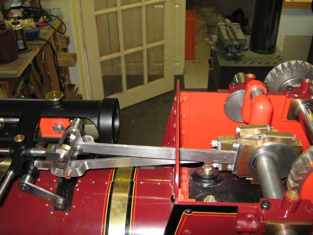

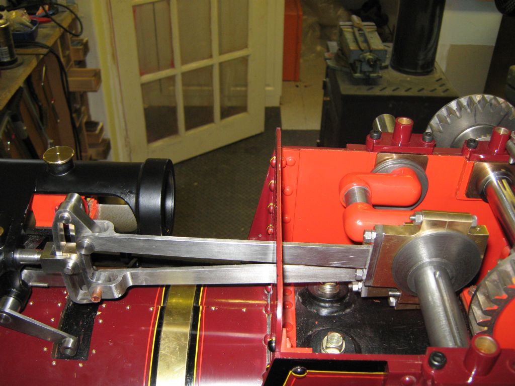

                    Hi everyone
                    Thanks Neil for your additional post.
                    At the moment I am doing a relatively rough check and I am along way from the published information.
                    According to the book the eccentrics are set at 82.5 deg and with the die block central as the crank is rotated I should see the thin black line. For this to happen the slide valve would need to move about 4.5mm but only moves 1mm. Furthermore when I put the valve gear in forward or reverse the inlet port does not open until the crank has gone about 45 deg.
                    These pics show this set up.
                    crank set at approx TDC, dieblock approx mid position.
                    img_1264.jpgCr
                    Crank through approx 90 deg.
                    Slide valve moves only 1mm as crank is rotated with the die block in mid position.
                    I tried playing about with the eccentrics and, with the valve gear in forward or reverse position, and the eccentrics set at approx 70 to 75 deg I am some where near the inlet port starting to open as the piston moves away from top or bottom dead centre. This is a significant deviation from the published information.
                    I have decided to leave it for now and study some more about this valve gear arrangement.
                    In the mean time appreciate your feedback/thoughts.
                    Many Thanks
                    Nigel
                    #126656
                    John Baguley
                      @johnbaguley78655
                      Hi Nigel,
                      Does the valve only move 1mm over a complete rotation of the crankshaft or just the 90 degrees?
                      #126660
                      GoCreate
                        @gocreate
                        Hi John
                        From the TDC position through to 90 deg ithe slide valve moves 1mm, moving on to BDC it reverses back 1mm.
                        Just been having another look, set at about 75 deg, it all looks to work OK, only approximately at the moment but not far off however, that's a lot different from the published 82.5 deg.
                        Many thanks
                        Nigel
                        #126667
                        John Baguley
                          @johnbaguley78655
                          Hi Nigel,
                          That's strange, you should be getting something like 9mm travel on the valve when the crank moves from front dead centre to back dead centre. If the eccentric throws are correct (0.75", 19.05mm) then the only thing I can think of is that the eccentrics are not set correctly. I can't see anything obvious from your photos though frown
                          Edited By John Baguley on 11/08/2013 01:22:14
                          #126672
                            With your expansion link in the mid position as shown in the photos you won't get much movement.
                            Put it into a full gear position eg up or down and you will get more movement
                            #126675
                            GoCreate
                              @gocreate
                              Hi John / Jason
                              I originally set the eccentrics accurately to 82.5 deg as per the Allchin book (it does say somewhere between 80 and 85 deg) The book says that with the die block in a central position in the reversing link (I guess this is mid gear?) rotation of the crank should move the slide valve so that you see a thin black line on each inlet port. This would require the slide valve to move 4.365 mm each way ,8.73mm total (+ a few thou). As Jason says the slide valve movement is actually very small, only 1mm. When in say forward gear, the inlet port does not open until the crank is well past the 0 deg which is not correct.
                              Referring to the info Jason pointed me to, I have played around with the eccentric positions. With the eccentrics set at 65 deg I am very close to the valve events described in the info Jason showed me and the Allchin book. At this angle, when with the die block is in the centre of the reversing link I do get 8.73mm (+ a few thou) movement of the slide valve and see the thin black lines at the inlet ports. Also in say forward gear the inlet port in beginning to open when at 0 deg., when the crank gets to about 100 deg the inlet port is shut (allowing steam expansion).
                              Ok, this is very much by eye at the moment so the 65 deg I mentioned above may be a few deg out but what I do know is that all seems to work as it should but with the eccentrics at an angle very much less than the 82.5 deg specified.
                              I guess I just need to do some accurate adjustment of the eccentrics to get the thin black line described, (this would appear to give the correct valve events in forward and reverse gear) and run it on air to see how it performs.
                              Frustratingly, work commitments and MOT time are going to divert my attention so it will be a week or so before I can get back to this.
                              Thanks very much for your help and info.
                              Nigel
                              #126683
                              Sub Mandrel
                                @submandrel
                                NIgel,
                                Read Jason's short post carefully. In the photo the reversing link is set near to mid travel.
                                I suggest you read up on how 'stephenson valve gear' works. Essentially to move between forward and reverse you move the link up or down so that the motion of one or other eccentric is passed to the valve. At points in between the valve motion is a mixture of the two movements. Exactly on mid travel valve movement will be zero.
                                This allows you to control speed and direction without using the regulator, and is much more economical of steam usage when running with the valve travel redudced somewhat ("notched up&quot.
                                You need to have the die block at one end to set the valve. Use the direction for forwards motion. At this position you will effectively only be dealing with the position of one eccentric.
                                When you have that eccentric correct, move into reverse and set the other. You may need to repeat the exercise a couple of times as there is actually a small interaction between the two eccentrics.
                                I made a small (and rather odd) stationary steam engine with stevenson gear, just to find out more about how it works. Simple in action, complex in effect.

                                  #126704
                                  John Baguley
                                    @johnbaguley78655
                                    Hi all,
                                    Even with the die block in the central position (Mid Gear) you should still get enough valve travel to just crack the ports. The expansion link does not merely pivot about the mid position – it physically moves backwards and forwards due to the difference in the positions of the two eccentrics. Moving the gear towards full gear just increases the amount that the port opens. Have a look at any of the valve gear simulators to check this out.
                                    Edited By John Baguley on 11/08/2013 12:03:11
                                    #126708
                                    Sub Mandrel
                                      @submandrel
                                      Hi Nigel, when you say the inlet ports doesn't open until the crank is well past 0-degrees, what are you using as the reference point for zero degrees? Zero should be taken as top dead centre which is actually with the crank more or less HORIZONTAL and pointing FORWARDS as it means with the piston as far into the bore as it can go.
                                      If you are measuring from when the crank is vertical, then the valve won't crack open until nearly a quarter of a rotation past this point.
                                      John you are right, but I would not expect as much as 4.3mm travel at miid gear?
                                      #126712
                                      John Baguley
                                        @johnbaguley78655
                                        HI Nigel,
                                        Right, I've put your dimensions into a valve gear simulator and you are quite correct – the valve will not crack the ports with the eccentric settings given by Hughes. The angle needs to be something like 65° for that to happen. The other alternative is to shorten the valve to reduce the lap but the question is:
                                        Is the 82.5° angle correct and the valve dimension wrong, or
                                        Is the valve dimension correct and the angle wrong?
                                        #126722
                                        GoCreate
                                          @gocreate
                                          Hi Neil / John
                                          Neil, my reference point is TDC crank horizontal, with the eccentric at 82.5 deg the inlet port does not open until the crank ha smoved 40 deg or more.
                                          John, thanks so much for checking the dimensions on simulator, I hadn't thought of looking for such a thing.
                                          I set up the eccentrics by adjusting them in full gear so that a thin line appeared. As I rotate the crank the inlet port shuts of at about 110 deg (by eye) which seems Ok. Once everything was set I removed the crank and eccentric assembly from the engine and set up on the face plate to check the angle of the eccentric which measured 65 deg,
                                          In mid gear the inlet ports remain covered but only just, so I probably need to reduce the width of the slide valve a few thou. For now I am leaving everything as is until I am able to run it in air.
                                          I am delighted the 65 deg agrees with John's simulator calculation so I am now confident everything is OK .
                                          I think the Allchin book has lead me a stray, I am sure many successful models must have been built to the drawings so the drawings must be OK.
