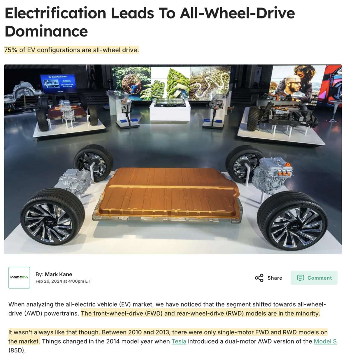

      This is another positive for me about BEV’s. When I learnt to drive, RWD was commonplace and my first few cars were RWD. I found them bad on slippery road conditions. Apart from a couple of AWD cars (which were great in the wet) all my later cars have been FWD. it’s so much easier to make a BEV AWD than an ICE car so I’m glad some manufacturers are taking advantage of this.
      IMG_3360

            The AWD is mainly for the manufacturers convenience. It’s easier to make and fit in two 60kW motors than one 120kW.
            AWD has always been popular in full hybrids and plug-in hybrids just stick a motor on the currently undriven axle. Als gives the performance aboost in terms of acceleration.

                      That’s why some Teslas have the logo “twin motor” on their most powerful cars, accellerating close to what a big bike can manage. Mind you, the battery milage and the drivers licence would be likely to be at risk.

                          One thing I hadn’t considered is better weight distribution of two motors. Downside of having a motor in the back though is probably reduced boot space?
                          Two of my old Honda’s had automatic AWD, that is to say they were front wheel drive only until it lost grip, then the rear wheel drive kicked in. It seemed to work well. One was conventional five speed manual, the other CVD automatic.
