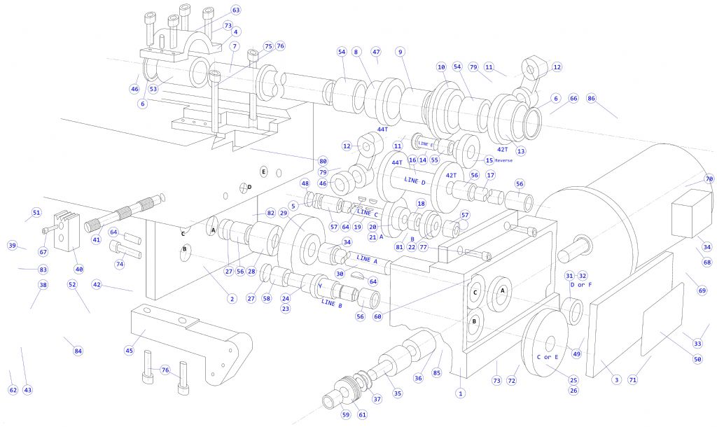

          Here is an uncompleted QCAD drawing/tracing of the expoloded view of the VBRP II table (X) gearbox. On later MkII's a modified version of this gearbox was used on the (Y) carriage. It's an exported boitmap but anybody with registered QCAD is welcome to the DXF for their own use. The table drive version is shown being stripped down in the VBRP MkII restoration thread.
          Yes, I know the perspective of the caphead screws is wrong, nothing looks right however I do them!

            Now that is impressive! Despite being a committed Qcad fanboy I've never attempted any that complicated. Just shows what can be done.
