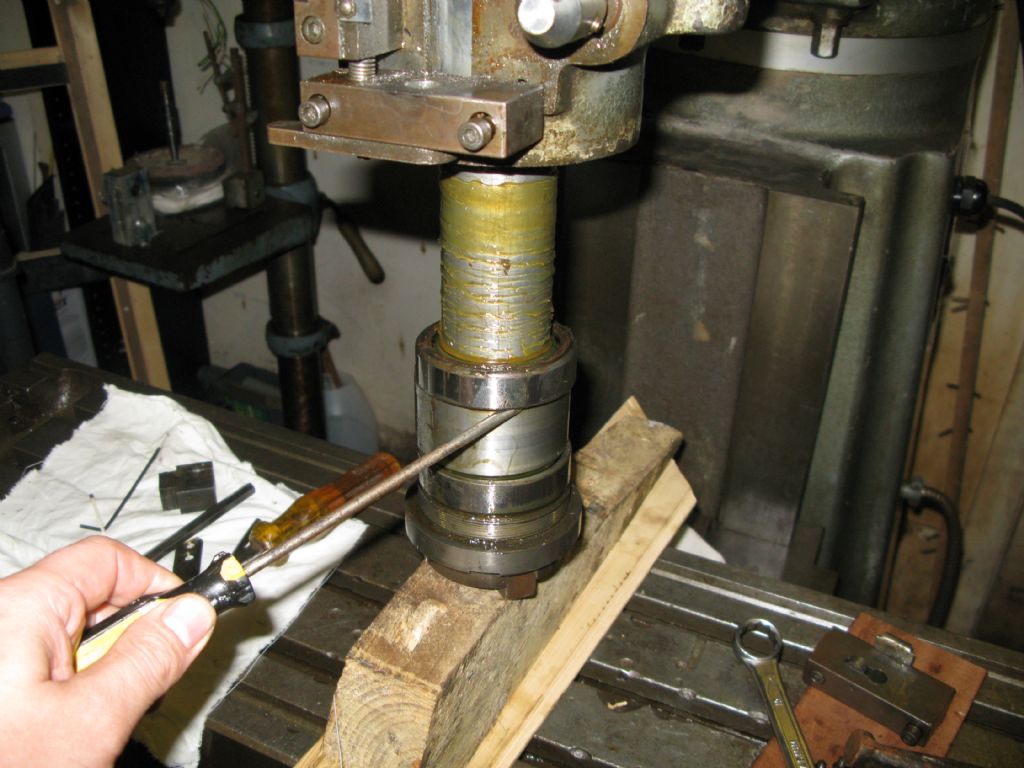

                    #298715
                    Bob McDougall
                      @bobmcdougall63250
                      Play in the spindle, Yes that would be because the upper bearing (middle?) was like it was filled with jelly beans. I dropped the spindle this morning. Watched bridgeport spindle removal , but the Beaver was slightly different, ,With the quill at its normal fully up position. the locking ring on the Quill end had two square recesses. each had a grub screw going vertically up into the quill which I loosened then unscrewed the ring anticlockwise. I locked the quill with the downfeed lock clamp. I had to use a screwdriver and small hammer to get the ring moving. Its a very fine thread and was maybe 20 turns, then the ring dropped slightly but didnt fall off. I thought I hadnt unscrewed it fully but I had.
                      Then like the bridgeport video I used the drawbar top tube to tap down , I just tapped the top of the drawbar and the spindle slowly dropped out , bearings and all, the drawbar went below the top and I had to use an extension, as it is now, ive dropped the spindle onto a wooden block on the two main bearings visible. I put my hands on the bottom one, felt ok, the top one wobbled like drunken sailor . There might be another bearing even further up , but I lost heart .When I bought this machine I looked the man in the eye and said, Is there anything I need to do to it . No.
                      So I need a new set of spindle bearings, any recomendations ? Much appreciated. img_0484.jpg

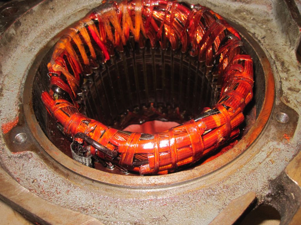

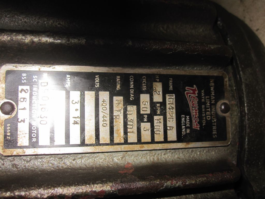

                                Bob McDougall
                                  @bobmcdougall63250
                                  VBRP motor 2HP 240V conversion not possible
                                  Newman motor 1 The motor did not have a junction box and I hoped to find the star point by distmanteling but all I could see was lots of shellac and cloth tape.
                                  Beaver VBRP motor
                                  to dismantel I dropped the head 90 degrees, and undid the three retaining hex bolts which allowed the motor and triple pulley wheels to come out as one. The wires had to be cut. to split the motor casing the bearings are held by a plate inside both shells so I had to undo every nut and screw visible before the back came off. I couldnt get the key out of the shaft but it did fit through the housing, the front housing was on a lip and only came off by knocking it out after removing the rotor from the rear.
                                  Cant find the star point so will re-assemble and sell as whole and buy a 1HP 180V DC ex-treadmill motor for £50 on ebay and a 8A 180V DC controller for £50 . But I need to fix the bearings first,
                                  The spindle bearings which first took me here , Ive had the spindle looked at (thank you ) and it has some high spots like a bearing was put on crooked, now smoothed off with a stone. so Im optomistic.
                                  #299777
                                  John Stevenson 1
                                    @johnstevenson1
                                    Bob save your money and hassle and take that stator to a decent motor rewinder and they can easily find the star point and bring it out safe ly in minutes
                                    #299879
                                    Bob McDougall
                                      @bobmcdougall63250
                                      John i cant find any way to disagree, so yes i will , there is a rewinder 30 mins away, but the dc motor looks so lovely, and as a tinkerer i want to re-create. but you are right , I bet the rewinder will have it done in 5 minutes for £20.

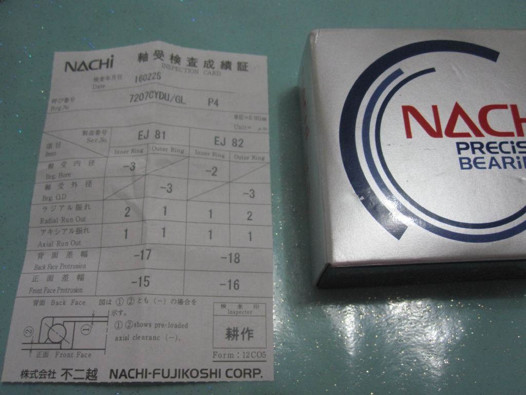

                                      Bob McDougall
                                        @bobmcdougall63250
                                        Received the new spindle bearings today, nice to see they have a spec sheet. Watching you tube bridgeport spindle bearing replacement I noticed the bearings are thick side inward, DB style. Mine were thick side out when I removed them as my video shows ,DF style. I assume they were put in wrong and hence the looseness but I'm only going off that one video.
                                        Also found someone who worked at Newman motors to have a look at mine to see if the star point appears .
