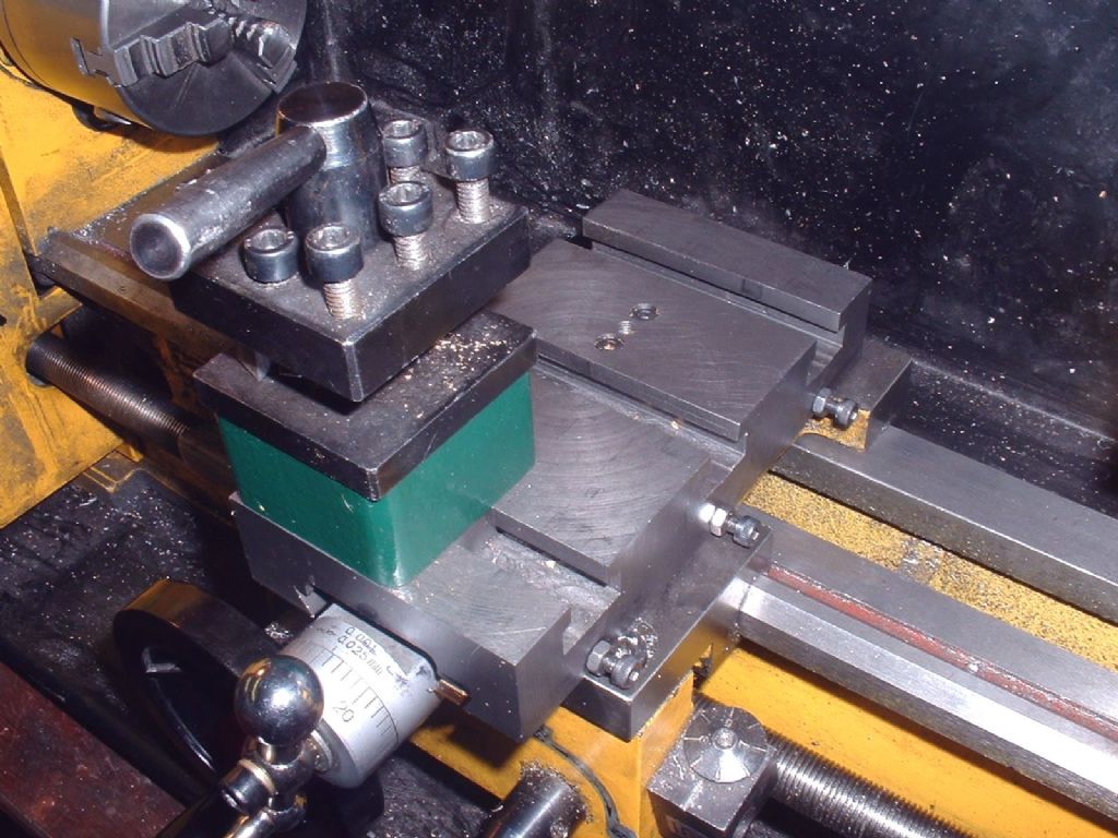

                                While we’re on the subject of the CL300, anyone out there know of a source for a T-slotted cross slide for this machine? Grateful for any help.

                                  Don’t know a source for slotted c/slide. But can recommend drilling and tapping existing slide, M6 in my case. this was recommended to me by someone on this forum, I think Quite easy to do, especially if the slide is out for fettling.

                                    A tee slotted cross slide is not that difficult to make. A description of mine is on my website:

                                      Thanks to Gordon and Michael for the two replies. The mikesworkshop site is well worth a visit – some super ideas, including his cross slide of laminated construction.

                                        My solution for a t-slotted table was from a slab of continuous cast iron:
