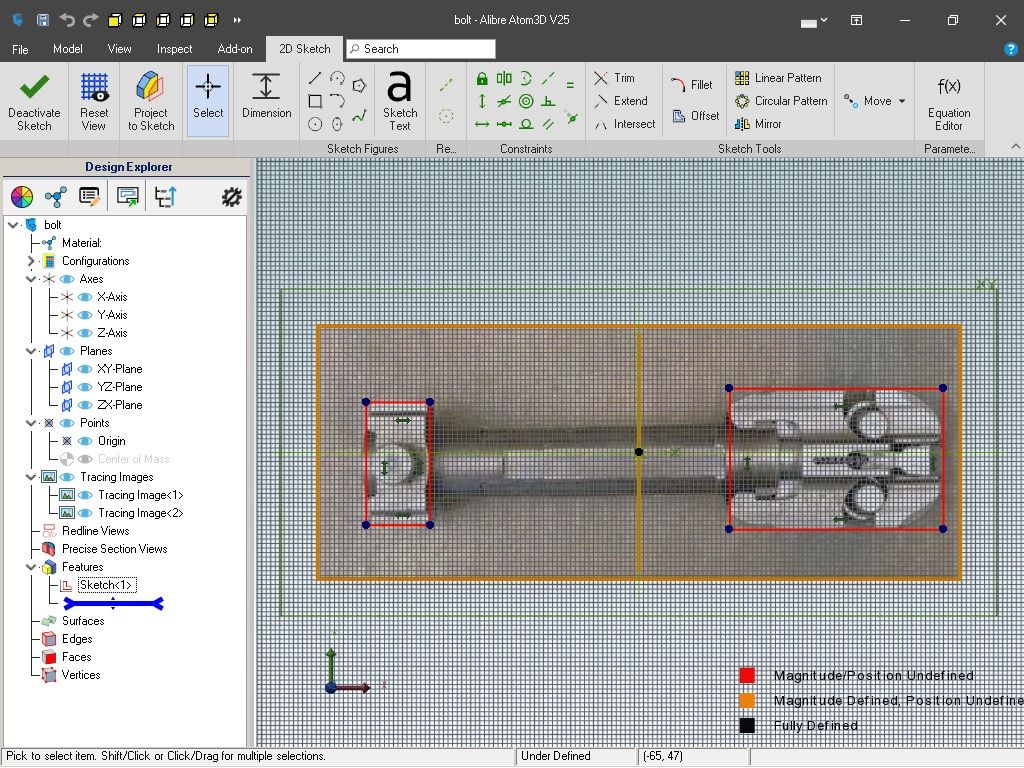

    Ady1
      @ady1

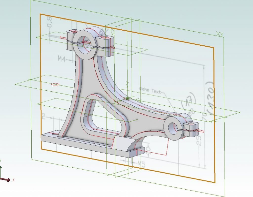

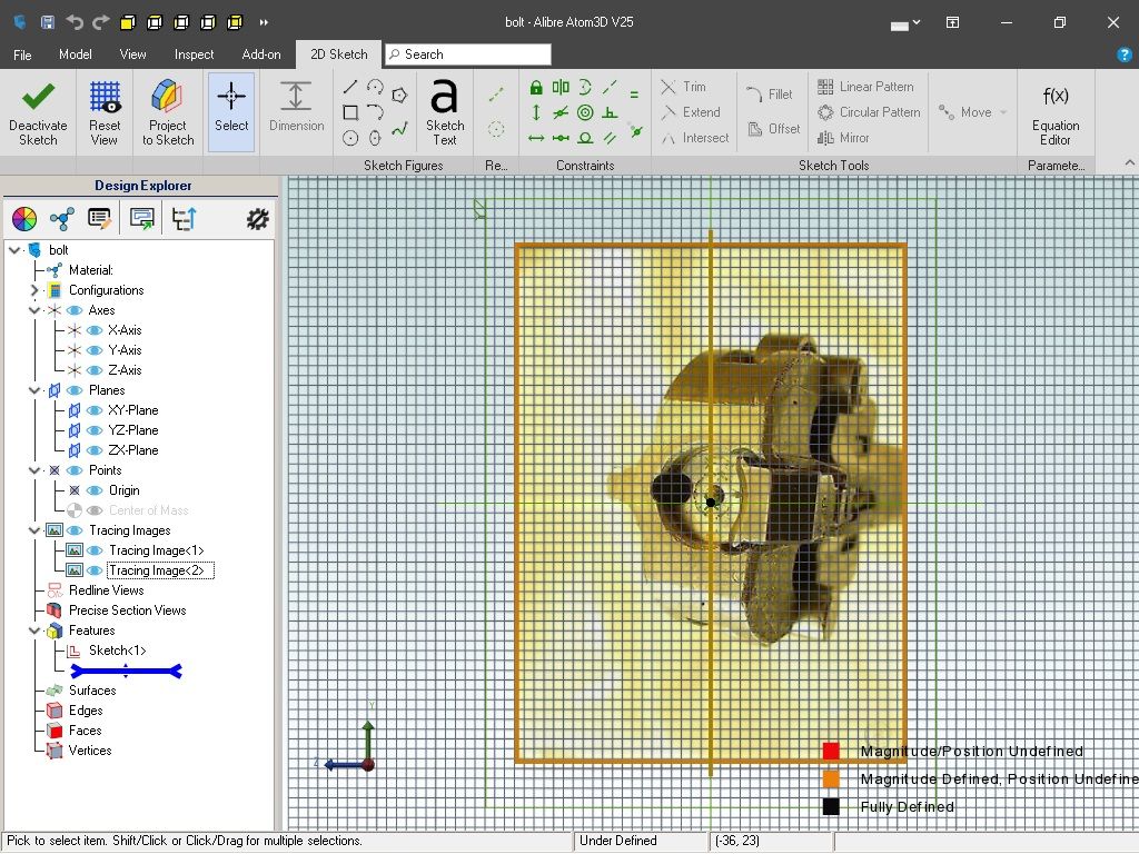

      I finally got this to work by apparently clicking "legacy display" to disable it (didn't work anyway), then unclicking legacy to make it ok (yes I know, weird)
      in file-system options-display-general
      #21418
      Ady1
        @ady1

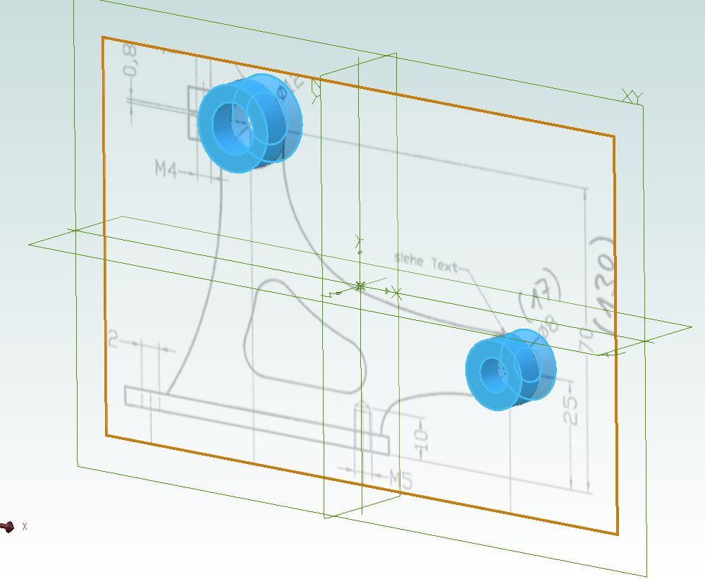

        insert a picture, scale it, then start drawing
        #643444
        Ady1
          @ady1

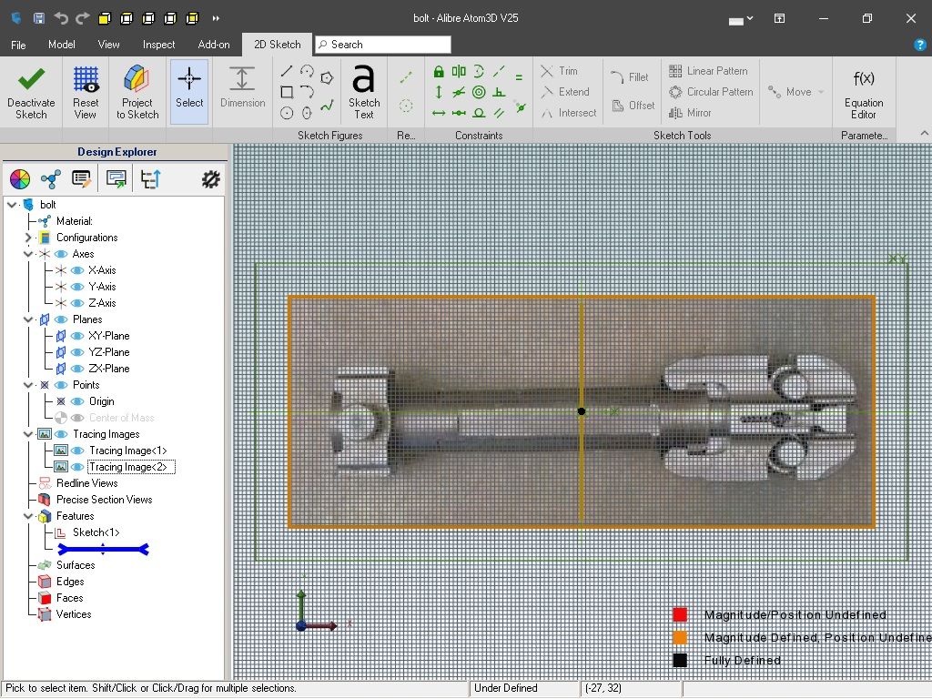

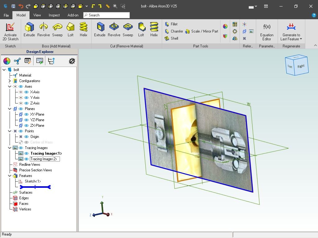

          So you scale the pictures of the different views in their respective planes then start to draw the bits you want
          I had put my Drummond dwg on hold because it would take lots of work to run about and measure it all up
          if you can take your own pictures then you only need one measurement and the rest will fall into place because you've got all the aspects you need and you only need to scale your jpegs
          Only got this fixed an hour ago, has never worked for me previously, its probbly ok for most folk

            It's a useful tool particularly if you want to draw a cast part that has curves and angles, can be done with photos or scans of drawings where you usually only get the machined parts dimensioned.
