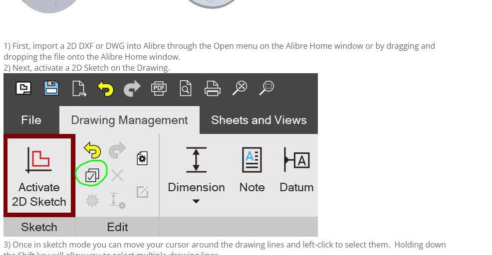

        I’m not sure if Atom has “select all” but I have ringed it in green, if you do that after clicking “activate 2D sketch “in these instructions that will pick up all the lines etc. that can then be copied and pasted into a new part file.
        select all

          Thanks Jason- I’ve seen those instructions but Atom doesn’t have ‘select all’ and the shift-select option doesn’t do anything.
