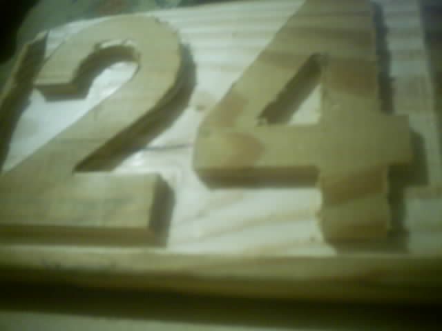

                      You export your Alibre file to .stl and load it into cambam for toolpaths and g-code (another 100 but most of these CAM programs want 500)
                      I use GRBL 32 bit
                      Edited By Ady1 on 20/08/2023 23:30:13
