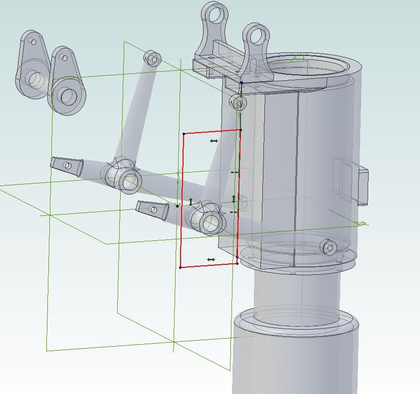

      Ah – so is the Reference Line to give the rectangle a definite location on the "curved" surface?

          Posted by Nigel Graham 2 on 13/05/2023 10:34:14:
          Actually there is a flat on that side of the cylinder as you can see from this view. I was sketching on the central plane so the ref was also placed on that plane so in the middle of the flat surface. Also note that the assembled parts come up transparent making it easier to sketch without solid items getting in the way and you can also see hidden features

            Ii see. Thank you. It was not so obvious in that pure elevation.
