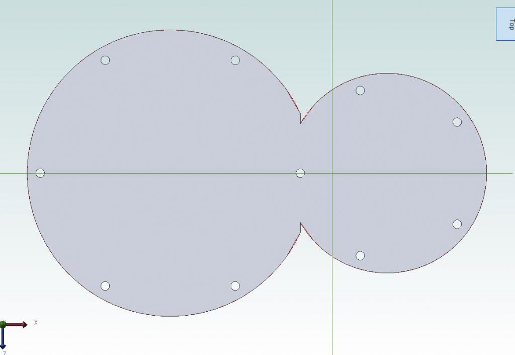

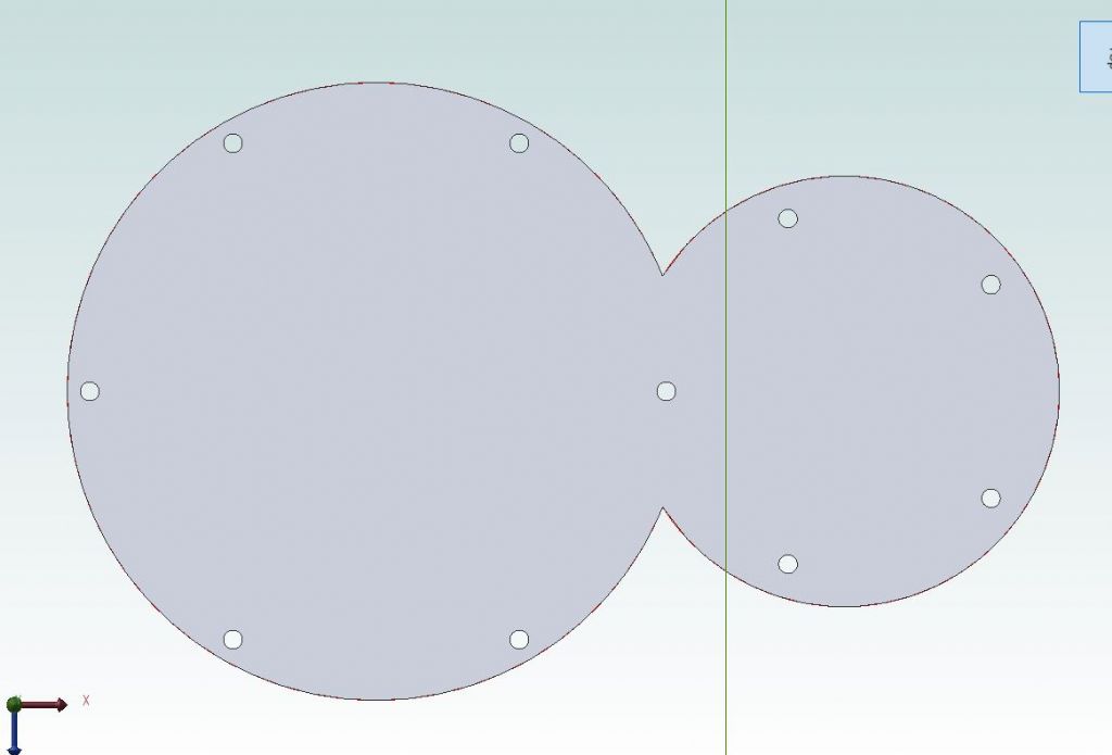

                        Here are two options for those cover studs, Alibre won't tell you which one looks better but it makes the job of deciding which easier.
                        Stud placed mid way between the two cylinder bores and flats on covers "cut" through that stud ctr. Leaves an nasty looking step where the two different dia covers meet
                        Stud position derived from where the tow outer diameters of the covers meet
                        Done buy using a couple of guide circles and a few known dimensions of the cylinder. There is a third option which is to place the stud hole central and then derive the cover diameters from that but not got time now to do it.
                        What was used above is really just basic schoolboy geometry except instead of using compass, set square, rule, etc CAD provides those tools. So if you had problems with maths which includes geometry lessons then you are going to have problems with CAD too.
                        Edited By JasonB on 09/05/2023 08:05:18

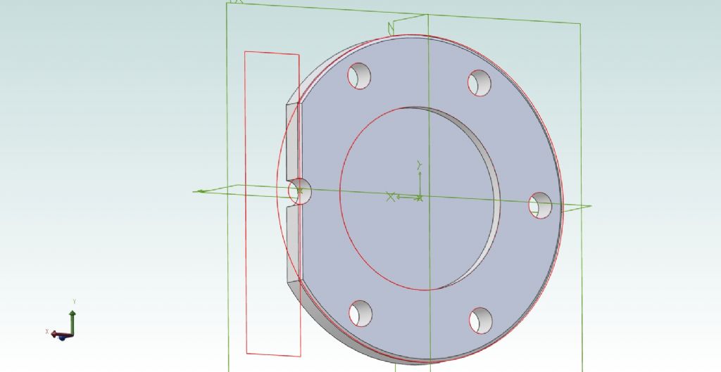

                                        I opened the drawing so far: the basic disc with 6 holes plus recess and register.*
                                        Opened the initial Properties menus, found and switched off the grid and grid-snap.
                                        Then cut the slice off as Jason had described: through-extruded rectangle of no special size but located by radial distance from the centre.
                                        For good measure I lightly chamfered the edges (0.03" ), once I realised the interrupted edges needed special treatment.
                                        *(In practice the latter is not necessary on the top end covers, but is on the crank-end. I'll also give the top covers a small screwed plug for injecting oil to protect the iron cylinder when out of use.)

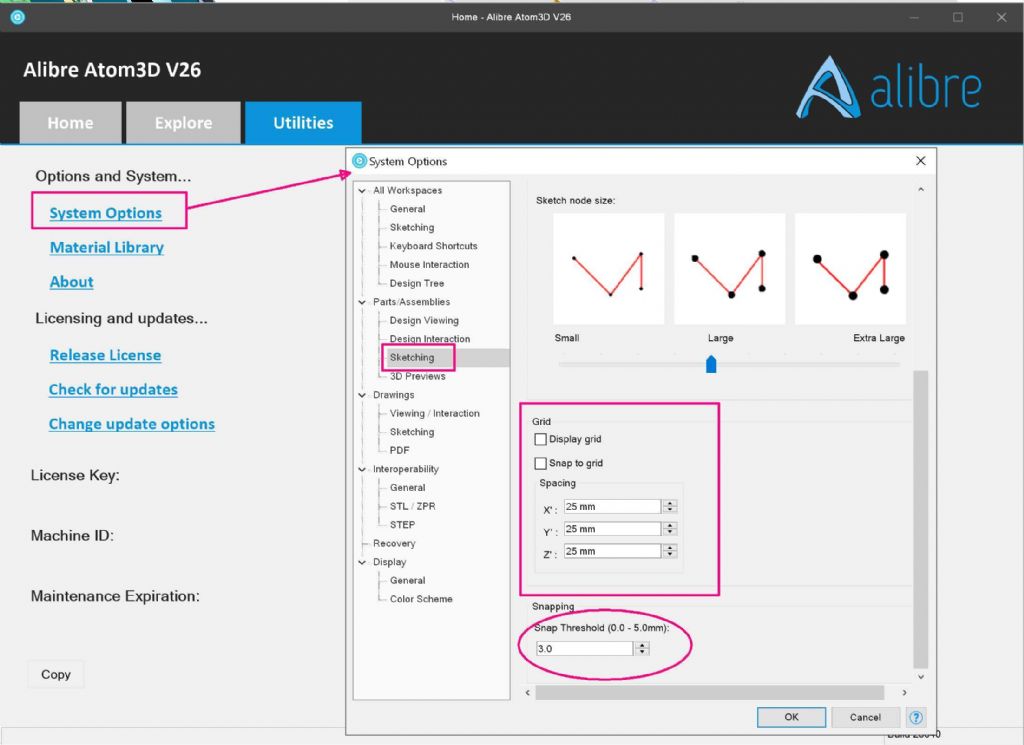

                                            Jason, how do you get the "sketch options" on the 2D Sketch Ribbon
                                            Thanks
                                            Steve

                                            David Jupp
                                              @davidjupp51506
                                              Steve,
                                              Jason is using Alibre Design Professional – Atom3D doesn't have the same options on the Sketch Ribbon – it is deliberately simplified.
                                              #644544

                                                  Steve, if you are looking for Grid & Snaps settings they are accessed via 'System Options' – see image. Note that there is another set of Grid options for the 2D Drawing workspace sketching.
                                                  The Snap Threshold setting below the Grid Area is for inferential snapping to lines, nodes, axes etc. Have it too small and you have to be extremely precise to select anything, have it too large and it may end up offering items you'd rather not have. Best setting for you may depend somewhat on your screen size/DPI.
                                                  #644550
                                                  Steve Skelton 1
                                                    @steveskelton1
                                                    Thanks David/Jason. I tend not to use the grid options it was more the other tools in the sketch options I was more interested in and what they do.
