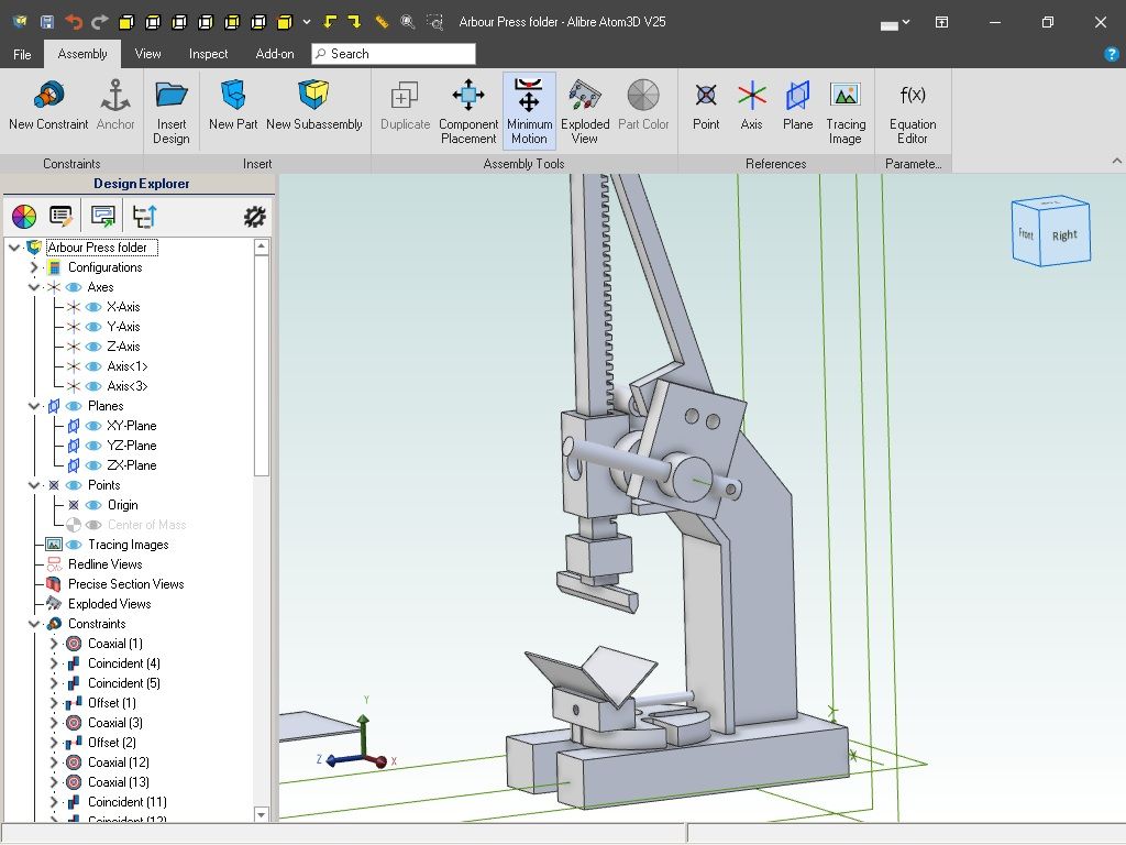

            Nigel
            One of my "homework" jobs was a scale drawing of my arbour press which is a relatively simple tool
            Now I use that drawing for building all my modifications and for solving any problems
            no need to go scrabbling about in the workshop trying to build stuff any more, just sip a cup of tea and ponder the task in comfort while at my computer desk, then draw the idea-parts, bring them in and check for fitments and build issues. I've already been saved from a few wasted jobs/ideas.
            When I go back into the workshop I know exactly what's needed (well 90% of it anyway)
            The time spent learning to use Alibre now really does save you huge amounts of time and effort later on
            In this example the square adapter on the nose of the ram for holding the former is too big and fouls the sheet metal being folded to 90 degrees in the die press, so that's a dead plan but Alibre meant I never had to make it to find out it was a failure
            Edited By Ady1 on 06/05/2023 10:59:40

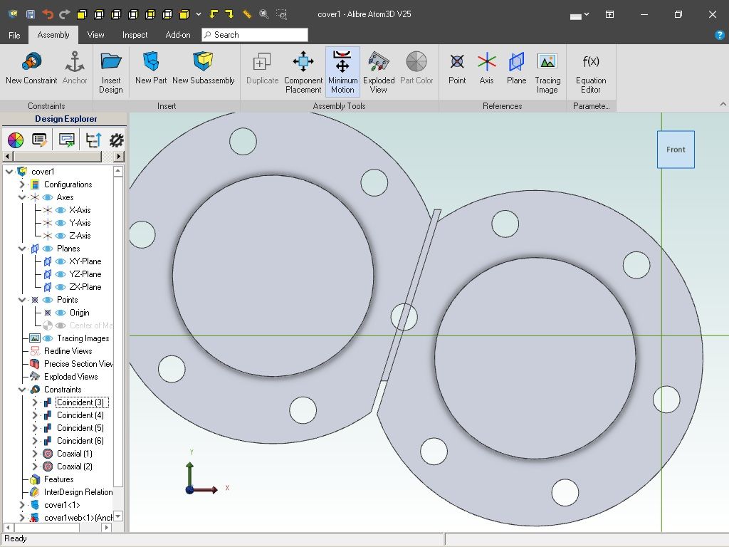

                  Did you not just make a cover with a right angled cutout then put it all together in assembly?
                  It will attach at any angle you want
                  Try drawing it in a single file and you'll go bodmin getting there
                  Edited By Ady1 on 08/05/2023 03:27:22

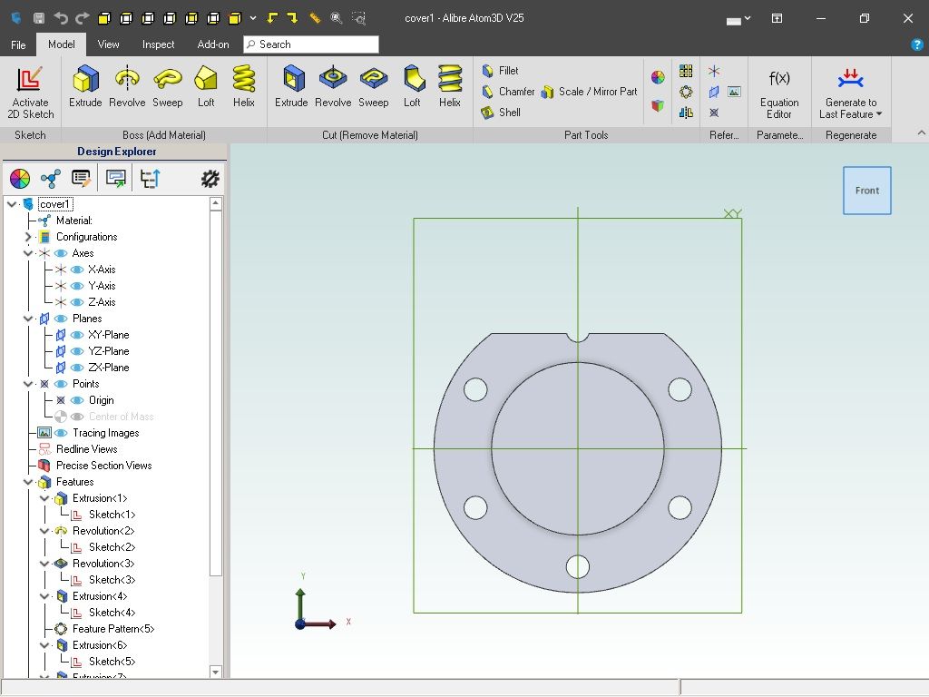

                    Assuming you know the ctr distance between the two cylinders and the stud PCD then that should be all that is needed. Is it a compound or double high? As teh cylinder would likely have been drawn first the cover dimensions could have been taken from that.
                    Your problem with placing the dimensions all along the axis is either not picking the right two points or simply poor mouse control, Atom will place the dims where you click so after clicking the two points move the mouse away and then click to enter the dimension.
                    #644352

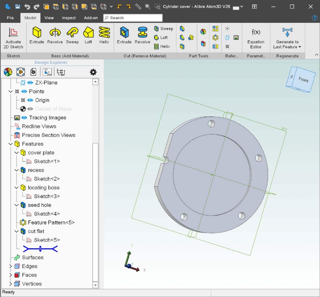

                      Here is one way to draw it, I have done it with each feature as a separate 2D sketch so it is simpler to follow though several could have been combined eg overall circle, holes and the cut edge.
                      Recess and spigot are just circles drawn on the surface or plane and extruded or cut as needed
                      You can see that the box to enter the dimension in can be placed where ever the user wants and I drag it about quite a bit to show that. Then when entering the position of the hole I show what happens if you just click after defining the two points – the dim gets added between the two. I then delete that amd do it again but move my mouse out of teh area of the part.
                      Also notice I enter the dimension as 60/2 because I want the radius but am using a 60mm PCD
                      Finally what was learnt on the scribing block exercise can be put to use for creating the cut off edge. I use "project to sketch" selecting one of the hole sand that gives me it's ctr point. I can then constrain the rectange to that and cut the edge off. That way if I were to change the hole PCD the cutoff would move accordingly.
                      Edited By JasonB on 08/05/2023 07:34:50
                      #644354
                        Doing it another way round where the distance to the cut edge is known and placing the first stud hole on that edge.

                            If the engine block is already modelled, it can be placed in an assembly, then a new part created in the assembly for a cylinder cover. Edges and hole locations can be transferred from block to cover.
                            Maybe a bit advanced for Nigel until more experience is built up, but all readily doable in Atom3D.

                                    Keep sketches simple – I strongly advise against having the cover outline and the holes in a common sketch. I'll send you a file with my own approach where you'll see I use multiple features, each with a very simple sketch. See image below – this approach keeps each step simple, and makes it much easier to edit a step (or even delete and start again) without throwing away all the stuff that did work.
                                    Extending your trial licence can be considered, but only if you accept help.

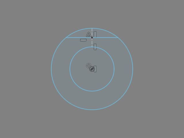

                                          Nigel Graham 2
                                            @nigelgraham2
                                            Jason, David –
                                            Thank you for that tip about dimensions.
                                            I'll open one of those drawings and try it…. It's the most basic of those cover drawings, just the outline circle and the first bolt hole.
                                            Sketch mode on, Correct plane (XY) on. Cleared the Undo buffer by stepping back until the arrow turned grey.
                                            Select tool highlighted (blue background) but I can't select either circle. Clicking on them merely raises that summary tool-bar.
                                            The Dimension tool is OFF (pale grey).
                                            The Definition indicator says both circles are UN-defined in both magnitude and position. The main one is concentric with the displayed axis though.
                                            Can I dimension the circles? NO.
                                            Right, can I draw a line, anywhere? NO: Select 'Line', click somewhere on the image, nothing.
                                            Click on the axis though, and I can draw a line apparently at any angle but always starting at the origin. The cursor has that little crossed-out circle stuck to it – don;t know what that tells me.
                                            I drew two lines of set lengths, one along the X-axis, the other Y (by entering 90º ). The X-axis line is defined by magnitude but not position (yet it's on the axis and origin?); the Y-line is fully defined.
                                            Can I draw a line from their end nodes?
                                            Yes from the Y-one.
                                            Oh – the X-one is now shown as fully-"defined" (how did that happen?) and I can now draw a line from it.
                                            Something turned on Dimensions too.
                                            I've now a peculiar thing with two pairs of +ve and -ve going, straight lines of equal lengths, like steps, and a line joining the extreme ends, through the origin. I can't dimension that though, because it hits that "parametric" thing I know nothing about.
                                            I tried dragging the dimensions left on from drawing the first two lines, but could not move them. I only made them collapse onto the axis. Then found by selecting the Dimension tool again they jumped back to their original places.
                                            Dimension the circles? No. They are still Undefined.
                                            Let's try re-drawing the main circle….
                                            I should have really deleted the first but since I can't select it had to leave it. I've now a fully-defined new circle but the dimension I tried to place did not respond to my attempts to place it neatly. All I did was scrunch it up on the axis, and I could not click and drag any of the dimensions anywhere.
                                            Finally, I tried to close it, which opens the Analyse menu. This revealed 27 faults, all but one being described as incurable! (Except by Nature giving the operator an IQ of 140 and learning ability to match…….)
                                            Then you all wonder why I find the thing so difficult and frustrating: I can't make the simplest drawings..
                                            I will re-iterate…
                                            ….. I do not denigrate the software!
                                            In fact of the three makes of CAD I have tried, Alibre seems the easiest to learn, at least to a fairly useful level even if I could never construct a 3D image of something like that engine on the publisher's own web-site. Or of my steam-lorry.
                                            It's me, not it, that has the problems. Perhaps I am physically unable to learn such software; just as I was unable to learn Mathematics or French, to play the piano, or be any good at sports and games. That is me, by Nature, not the programmers' fault, not some mysterious artefact of CAD!
