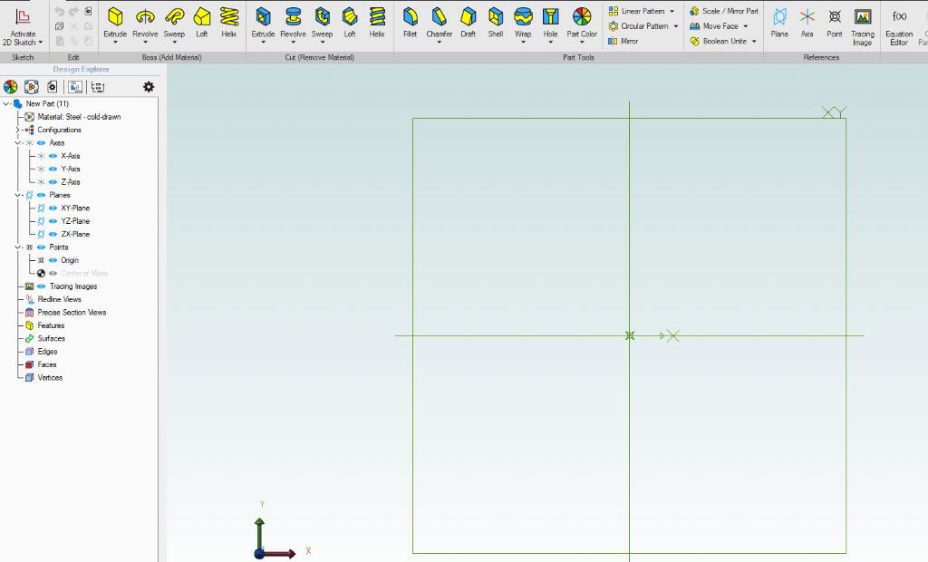

                Nigel Graham 2
                  @nigelgraham2
                  Just tried again.
                  My drawing's plane indicators don't match the diagram in tutorial and I can't make them to do so.
                  The little boxes at the top just move the figure around. The plane selectors in Design Explorer don't seem to anything at all, as far as I can see, apart from using the little beady eyes to turn them on or off.
                  Even so, I can still select the edge, but the Project thing just ignores it no matter what I do.
                  #642823
                    Can you post a screen shot or photo of the screen of what does not match.
                    If you are having a job with using project to sketch to place that reference line then you can leave that bit out but draw your triangle at the other end and then the XY plane can be used to position the edge of the triangle using co-linear constraint which is (–)
                    EDIT
                    Just checked mine and I get exactly the same planes come up on starting a new part as they show in the series, mine is not altered from the default settings. It should look like this when the part modelling screen comes up
                    If it does not show the same green plane lines then click the view tab and make sure you have th etwo arrowed icons at the top right clicked as these will also toggle the planes and axis lines on and off.
                    Edited By JasonB on 27/04/2023 18:44:51
                    #642825
                    David Jupp
                      @davidjupp51506
                      The MEW tutorial was produced before Alibre introduced the individual 'Eyes' (visibility icon) for each plane in the Explorer . More recent versions of Atom3D add the Eyes into the Design Explorer.
                      The instructions in the tutorial are still valid; BUT do NOT click on the Eye when selecting a Plane, as that will just toggle the visibility. Instead click anywhere else in the name of the plane or the planes icon to the left of the Eye. You can also select the plane by clicking on it in the 3D workspace, instead of in the Design Explorer.
                      Pay very close attention to which plane the instructions tell you to select.
