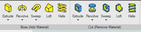

                            Until you set up your master working interfaces for metric and Imperial and get a decent mouse you're pretty much up the creek without a paddle
                            Tapered stuff is easier if you draw 2 circles, one at at each end and use the loft command, but you can use revolve-cut
                            Use the box viewer in the top right corner to manipulate your 3D view about

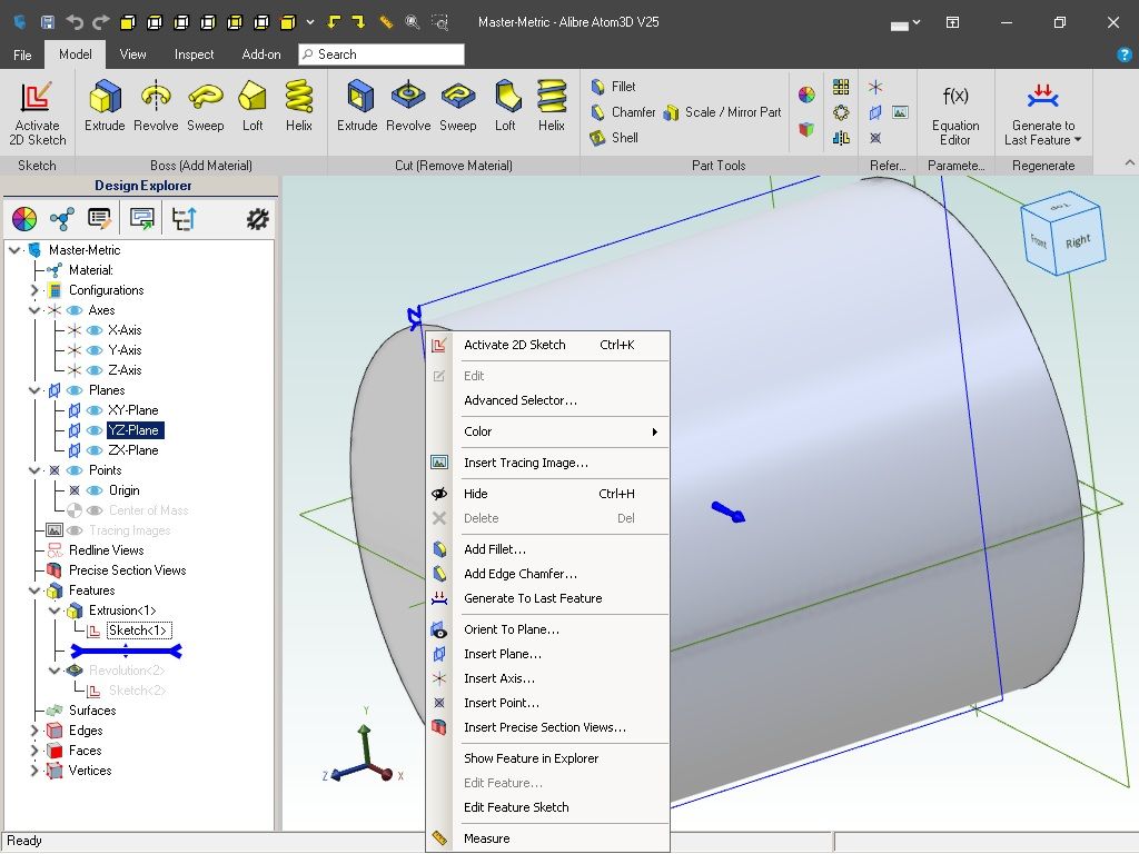

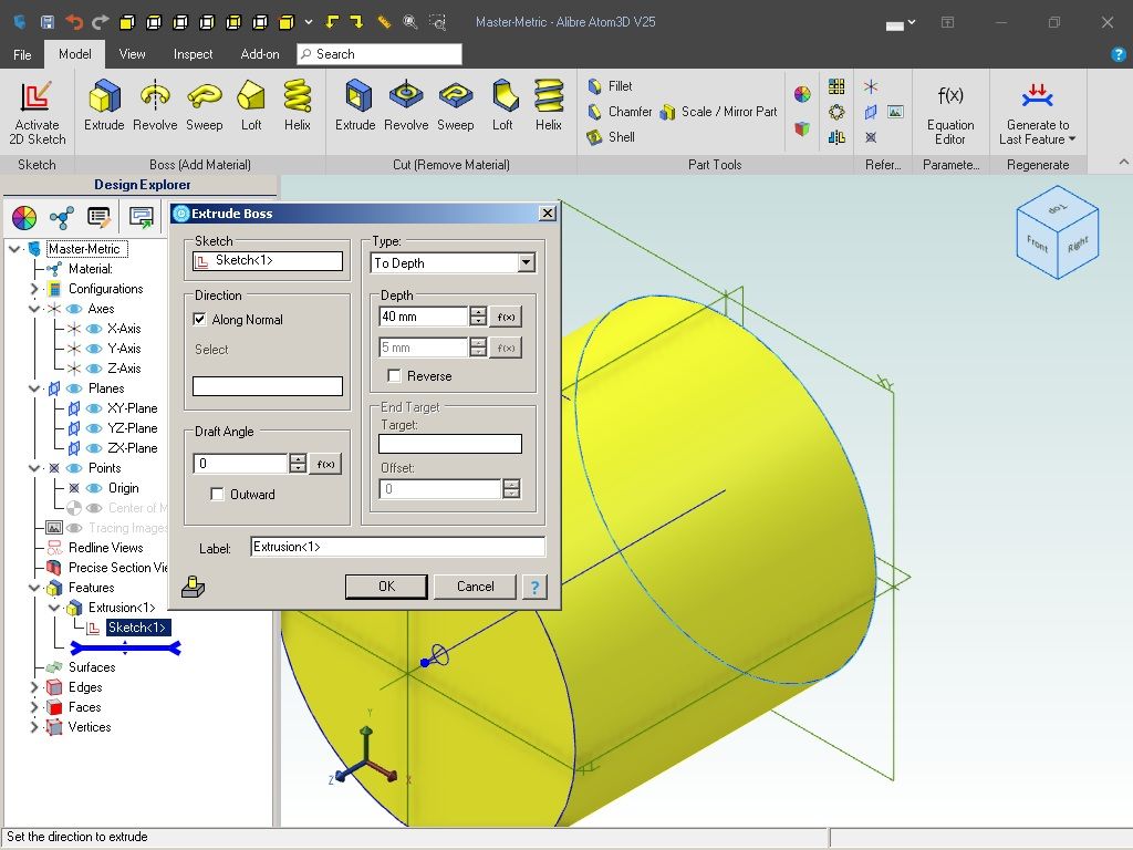

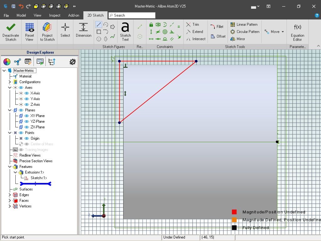

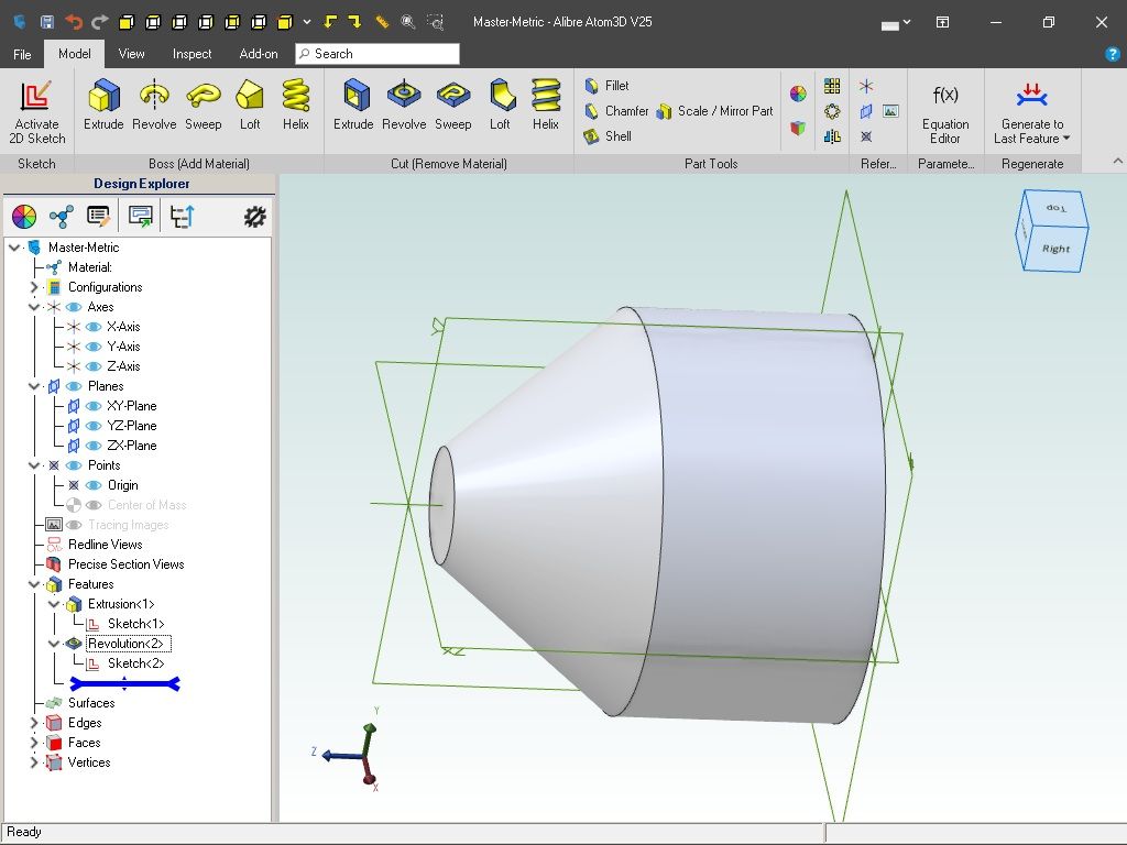

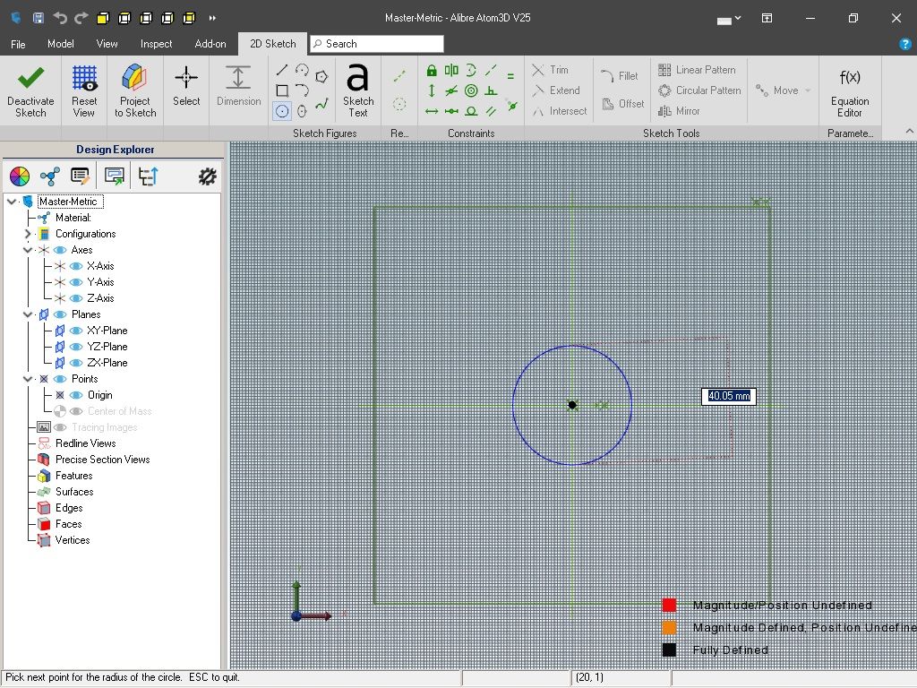

                                Try practicing with a simple example, we're only taking a chunk out of the top
                                Draw a simple cylinder slap bang in the middle 40mm
                                exit 2d and extrude boss to 40mm

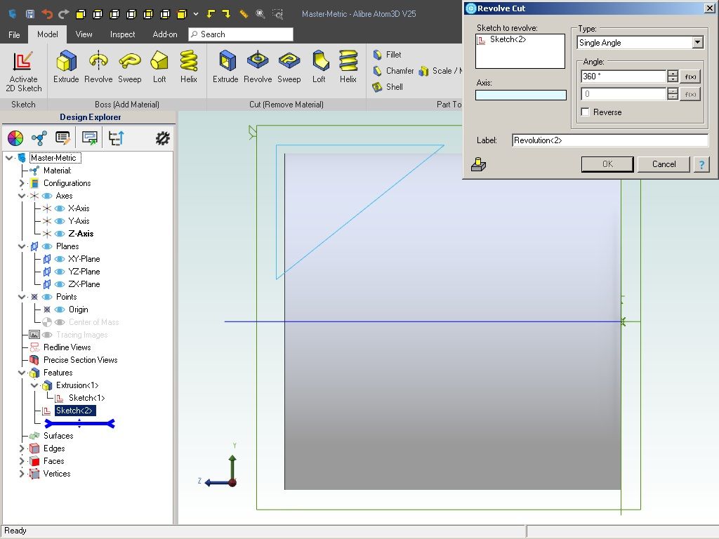

                                Highlight the plane that cuts it in half (goes blue), right click and click "activate 2d sketch"
                                This is the view down the middle

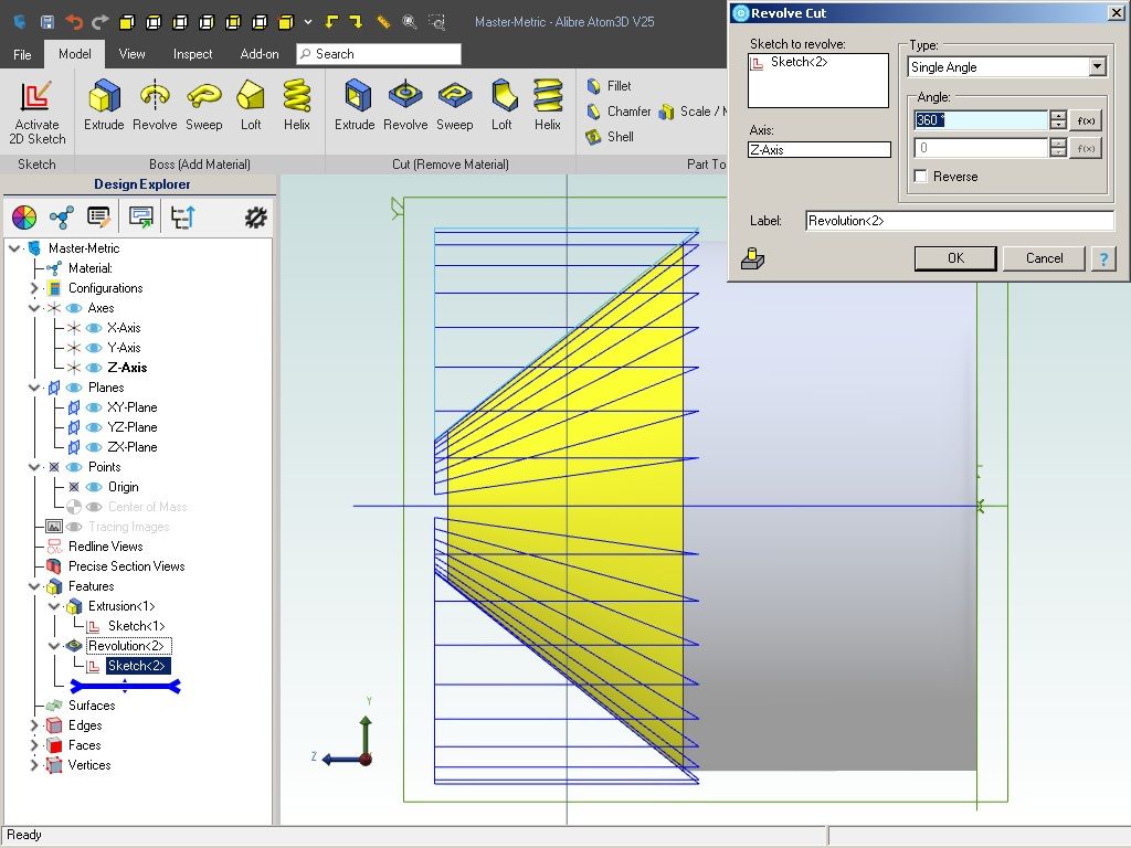

                                Draw any old triangle you like
                                Come out of 2d sketch and click revolve cut
                                The box has your triangle (sketch2) and is asking for the axis that rotates the sketch via the blue highlighted box
                                Click on the axis going through the cylinder from left to right and it shows you the realtime cut
                                click ok and you will be returned to the 3d view
                                Edited By Ady1 on 27/04/2023 02:53:51

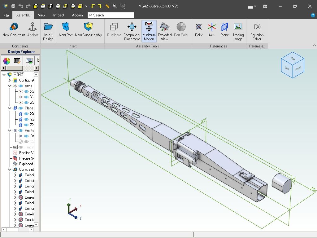

                                                Jason:
                                                Once you start doing arty-design type stuff where the edges merge and curves need adjusting it can start getting processor intensive and if it falls over it can't always undo, it just hangs. So I just stick with blockwork. It may be my crappy computer but I just got a decent 4GB graphics card and the issue remained
                                                I'm doing an MG42 as an exercise to build my skills, the square nose part merging into the muzzle as part of the shaped sheet metalwork has given me a lot of hassle for example
