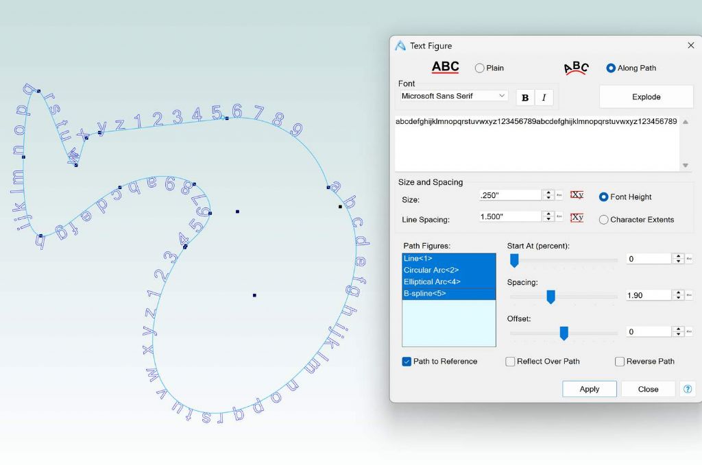

        I'm told that 'text along a path' should be available in all software levels in version 27. There's perhaps a small chance that could change before release.
        Jason did all those nameplates the laborious way, placing each letter individually.  He uses Alibre Design Professional, but text tools same in all levels.

                          Another option, DeskEngrave (an old piece of free software) can provide a way to do text on curves and transfer to CAD via DXF.
                          As mentioned, from Alibre v27, Jason will be able to do his curved text much more easily.

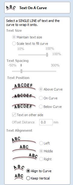

                              I do have Vectric's Cut2D which came with the CNC and will do text on a curve but I don't use it.
                              The advantage of placing individual letters is that you can tweak the spacing and angle which I had to do a lot on those name plates to allow the 0.5mm ended cutter to get all around them, using the computers standard spacing is not always ideal

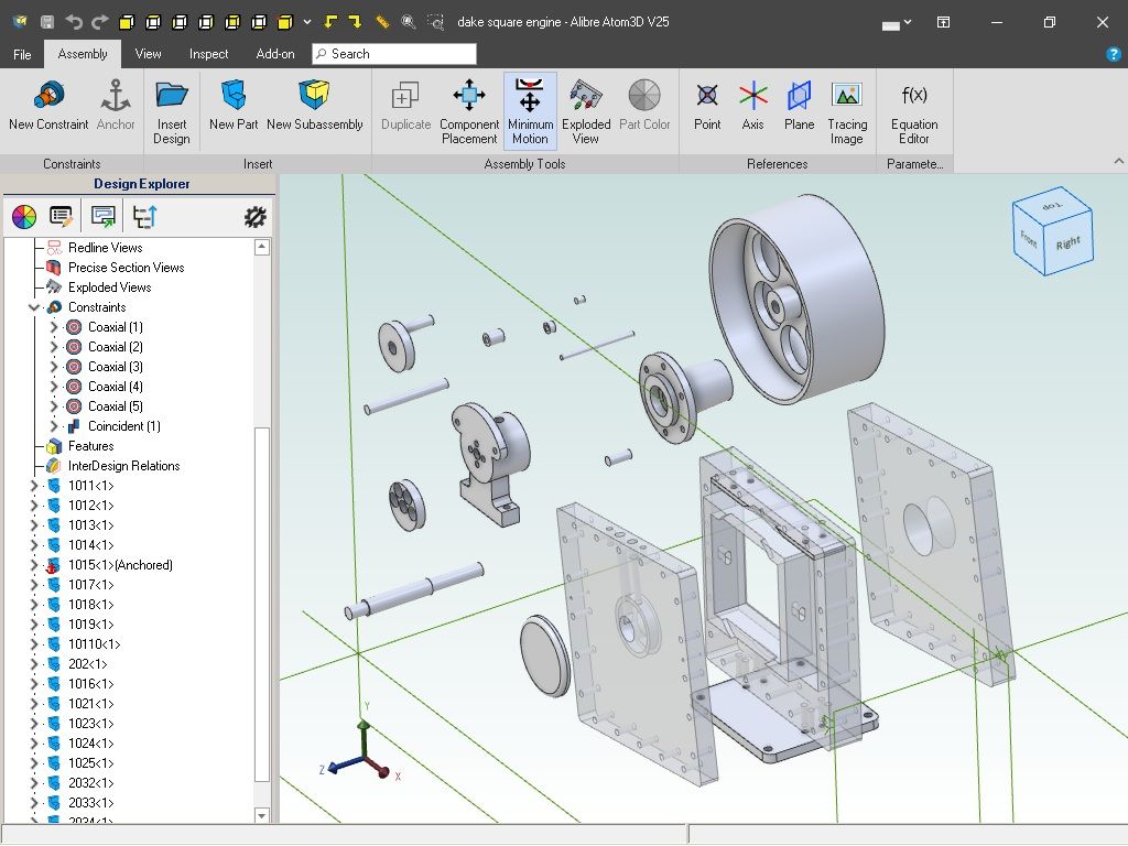

                                The biggest advantage is project speed, you can build something before you build it
                                I've made 90% of the bits for the Dake square engine in just one day using the excellent plans by Mr de Waal
                                Now most of the donkey work has been done I will get the last bits done at my pleasure and leisure then go for fitting and figuring out how it ticks

                                        The upgraded text tool for Alibre v27 (taken from a post by Alibre CEO on Alibre's user forum)
