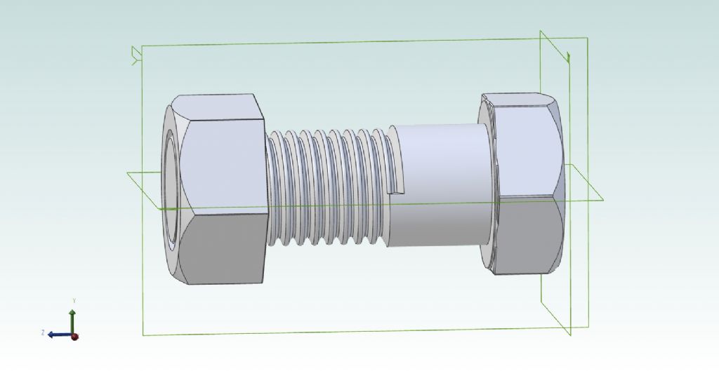

        Had another go at the Revolved Cut tool to see if I could cut a thread….
        It's not an easy tool to use though the scribing-block exercise says it is.
        The nut is still plain, but after a lot of mistakes, puzzlement, referring back to the tutorial document and experimenting I managed to make something looking like an M25 thread on the bolt. I've over-rounded the crest a touch but at least I managed to round it off.
        (I had based this exercise on rule-measuring an M24 nut and bolt I have lying about. I found later that the actual ISO standard is indeed M24 not M25, but don't tell anyone I'd not looked at the thread-charts first.)
        #644815
          You are getting theresmiley

                I too have now installed the trial version of Alibre Atom3D Nigel. At least I can now follow along with what you are doing.

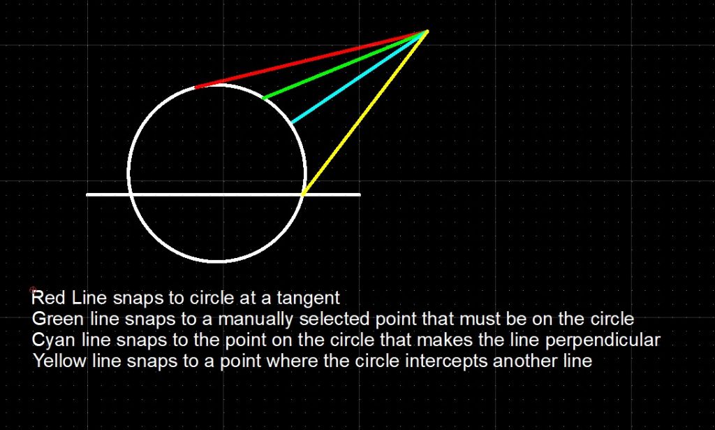

                                  Posted by David Jupp on 13/05/2023 14:18:11:
                                  Posted by Nigel Graham 2 on 13/05/2023 14:06:16:
                                  Remaining concerns.
                                  I think my main one is knowing when not to use Grid Snaps and when I should.
                                  Personally I would say NEVER use Grid Snaps.
                                  As you've found snaps can cause unexpected problems – so I'd turn them off. If you do come across a case where you decide they'd be really beneficial, you can turn them back on for that project.
                                  I wouldn't go so far as to say NEVER, but my experience on other 3D-CAD software is that grid-snaps are mostly counter-productive. They're much more useful in 2D-CAD, where it often doesn't matter whether or two lines join correctly as long as the drawing looks OK to the human eye. 3D-CAD is different; it's vital that lines join correctly, because solids can only be generated from valid 2D loops.
                                  Snaps automatically create or enforce accurate connections of various types. Worth practising for an hour or two with them to understand when they're useful, and when they're not. Snaps are tools, and using the wrong tool by accident always causes trouble. Most software does a good job most of the time selecting the appropriate snap automatically, but not always. The operator may have to override the computer's choice.
                                  This example from QCAD illustrates 4 different ways a line might be snapped to a circle. QCAD offers a few more, but the point is which of several snaps is correct depends on what the operator is trying to achieve. If the software makes the wrong choice one or more times and the operator doesn't notice, his sketch won't do what the operator expects, no matter how good it looks!
                                  All CAD tools allow the operator to control which snaps, if any, are active. For example, when a line has to join a circle at a tangent, which can be tricky, it's useful to temporarily turn all the other snaps off. Doing so ensures the line can only join correctly at a tangent, and not just look like one!
                                  Zooming in on sketches is one way of detecting otherwise invisible connection errors. When CAD tools refuse to work, despite everything looking right, it's often because the sketch has a tiny mistake, perhaps because the wrong snap engaged. Snapping to the grid caused me more trouble than all the other snaps put together, but it's well to understand other snaps can also cause trouble.
                                  Snaps are simple enough once understood, but have the potential to cause much confusion. On a drawing board, the draughtsman has to know how to draw tangents. A computer deskills tangent drawing by creating them with a few clicks, but the operator has know when to tell the computer exactly which snap is required when there's any ambiguity.

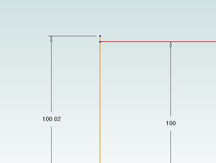

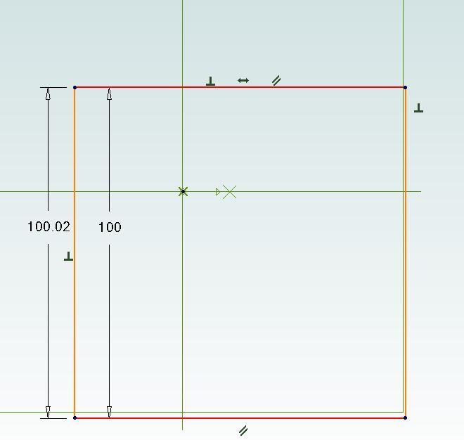

                                    Have you never had the need to send a DXF or DWG file off to anyone Dave? in those cases it DOES matter if the lines join crrectly.on your 2D. Even if just for your own use if lines don't meet and you use thos elines to produce working 2D drawings what will the computer put as the dimension? the drawn line length or the length of the line it is meant to meet up with.
                                    This is a square of equal sides, 90deg corners but the line on the left was drawn a bit longer depending on wher you click to generate the dimension you may get the 100mm of the squares side or the 100.02 of the line
                                    Only by zooming right in can the difference be seen, may be OK for you in the "near-e-nuff" workshop but could affect which way your pendulum swingswink 2
                                    I like to be the one designing not letting the 'puter put the lines etc where it wants so never use the grid or snap to it.
                                    Edited By JasonB on 14/05/2023 12:31:34

                                      As I've said before – no single 'correct way', and people have their own preferences.
                                      The question related specifically to Atom3D, where toggling grid snaps on/off requires a diversion into System Options, it isn't easily doable from the workspace.
                                      The question was also specific to GRID SNAPS, not other types of snap.
