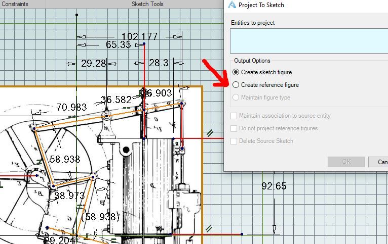

                  I downloaded Atom and have been having a play.
                  I couldn't make any progress beyond drawing circles and other shapes for quite a while, which was frustrating, but eventually I realised that once you have completed a sketch in Atom, you need to apply some kind of Boss or Cut function, and from what I can presently tell, that function will act on all geometry within that particular sketch. I think this is why keeping a sketch simple is important and you probably shouldn't include geometry that isn't needed at that point.
                  Anyway, I made a video of where I keep getting stuck on Nigel's cylinder cover – it's the extruded rectangle that's used to slice off part of the flange that throws an error message for some reason. I can't think what I'm doing differently, because previously it just seemed to work.
                  Martin.

                    Just a guess Martin, but when you selected the project to sketch and clicked on the circle, you chose sketch figure instead reference figure. I think this confused Alibre because you were then trying to extrude cut the two of them. Try selecting the circle as a reference figure.
                    As I said, it's just a guess!
                    #644599
                      When "project to sketch" was used that is a bit like copy and paste so your hole has become part of the sketch.and needs to be removed using "trim" so that you just have the rectangle to cut. You can see the red or blue outline of the sketch is a rectangle with one side slicing through the hole so it is not a solid outline.
                      Ticking the box when project to sketch comes up to use as a ref rather than part of the sketch will save having to trim the circle.
                      When that box popped up saying there were problems, if you clicked show rather than ignore it lists the errors and as you click the errors down the list they are highlighted in red so you know where to go looking for them
                      I seldom use project to sketch but put it there as it shows a practical use for it and it was in the article so again shows its use.
                      There are several ways that the part could be drawn as I mentioned earlier. You could do the circle place a line 30mm from ctr and trim to get the overall shape and also do the hole pattern in one sketch, the recess and spigot as two others. But for now Nigel is probably better doing each bit separately.
                      Also doing it the way I did will move the "cut" rectangle's edge if the PCD of the stud hole sis changed as it takes it's position from the stud hole. If it had just been dimensioned at 30mm from the ctr then it would nee dto have that dimension changed each time the PCD was changed and as the PCD seems a bit of a variable in Nigel's design that seems the best way to do it.

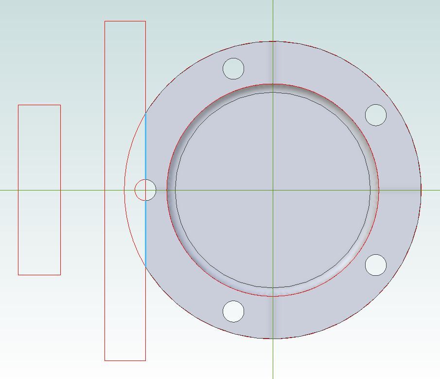

                                  Just a guess based on doing similar with other CAD but sketches usually have to be attached to a Face, and your rectangle might not be. I notice the rectangle starts being drawn in mid-air is mapped to the face later. (Terminology varies! By mapping I mean a tool that takes a sketch drawn in one face or plane and sticks to another.)
                                  The technique is useful, but – in other CAD – it can create a situation where the sketch looks right, but it hasn't attached properly to the face, perhaps hovering a few microns above it. When asked to take a cut, the program knows the sketch isn't attached to a solid, and can't cut empty space.
                                  For that reason, I prefer to sketch directly on faces, not starting them in mid-air. This ensures the sketch really is on the face and not floating nearby.

                                    Dave, Lee and myself have identified the problem, Martin did not click "create reference figure" so the circle became part of the sketch
                                    See me select the ref on the video, the circle does not become red like it did on Martins as it is not part of the sketch
                                    To initiate the 2D sketching you have to select the surface or plane first so the rectangle may look to be in mid air but is actually co planar to that surface/plane
                                    Edited By JasonB on 10/05/2023 09:13:33

                                      Nothing to do with faces/planes or 'mid-air' – Jason's diagnosis above nailed it.
                                      Sketch was not closed due to containing a circle crossing the long side of the rectangle. If the projection of hole edge had been a reference figure, it would have worked.
                                      Martin did show sketching on the face. Not sure what you mean by 'starting in mid-air'… If you mean on a plane, that is actually 'best practice' in 3D CAD. It is more robust than sketching on a face, but at expense of taking extra time.

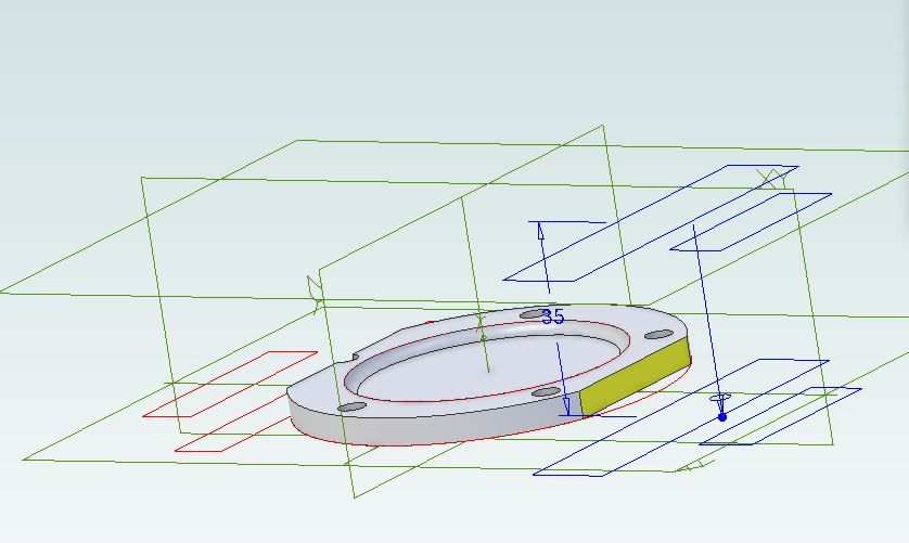

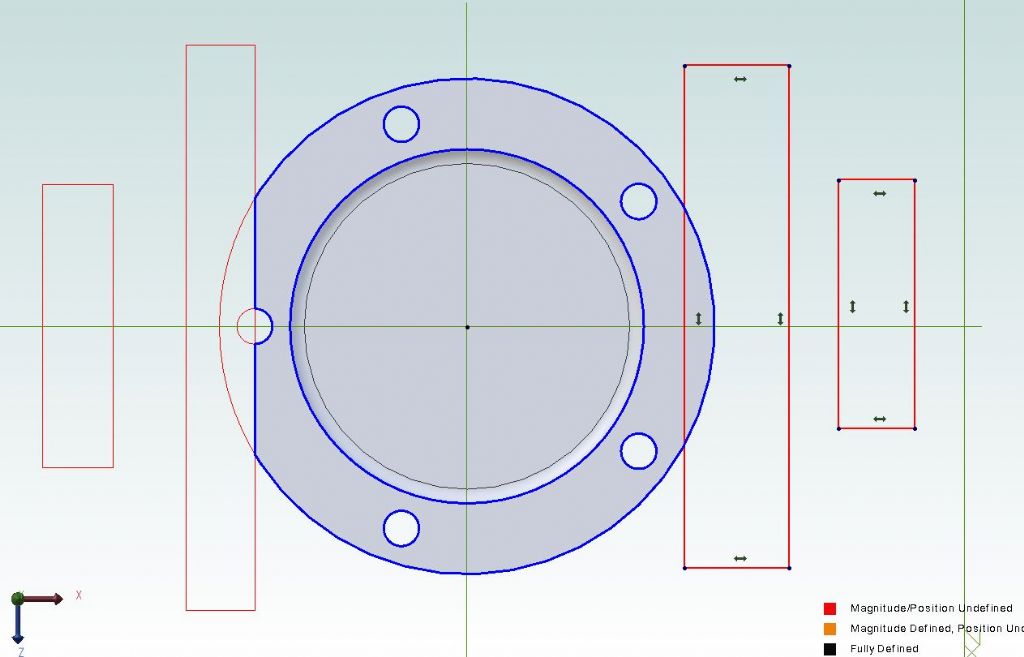

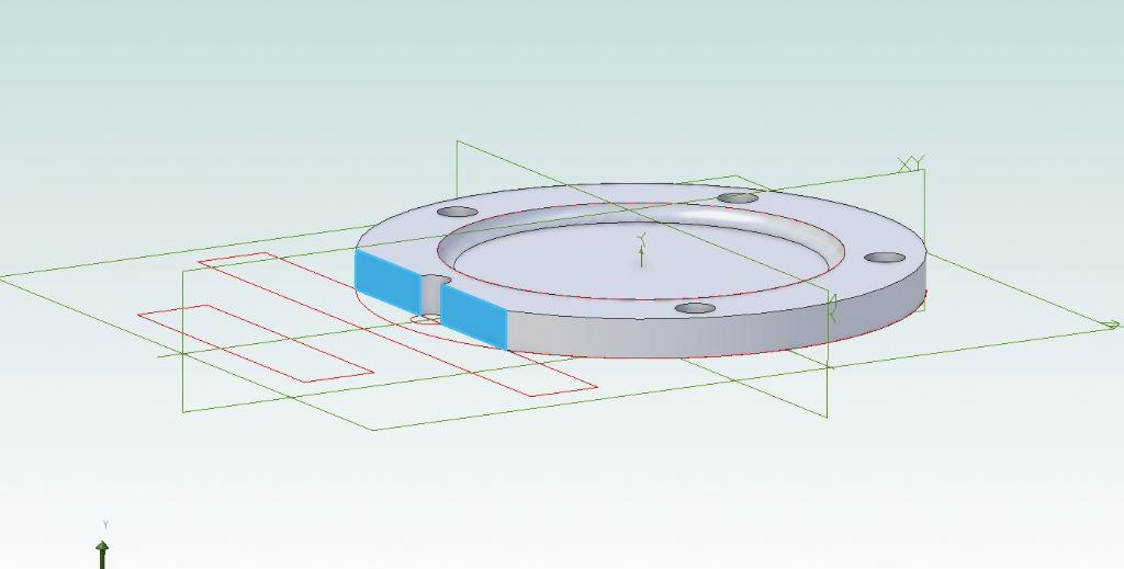

                                        Dave, regarding your floaters, I have added another rectangle that in the 2D sketching mode may look as though it is floating about in space
                                        However when viewed from a different angle you should be able to see it is co-planar with the Xz plane as that is what I selected to initiate the 2D sketch so it is fixed in that dimension, if I constrain the sides of the rectangle in the sketch that will constrain the other two dimensions so it is then fixed in all three.
                                        Even if the rectangle were sketched on a plane that is some distance from the previously created part
                                        Provided the extruded cut were long enough it would still cut the edge off.

                                                  Thanks to everyone for providing the solution – special mention to Lee for being first with the answer. yes
                                                  I didn't think to swap those two options because I can't remember changing them in the first place, but maybe I did that inadvertently.
                                                  I'll keep playing.

                                                    You didn't change the option – it defaults to Sketch Figure (which is often, but not always, what is needed).
                                                    If you get the wrong figure type, simply right click on it and 'Convert to Reference Figure' or 'Convert to Regular Figure' depending upon the offered option.
