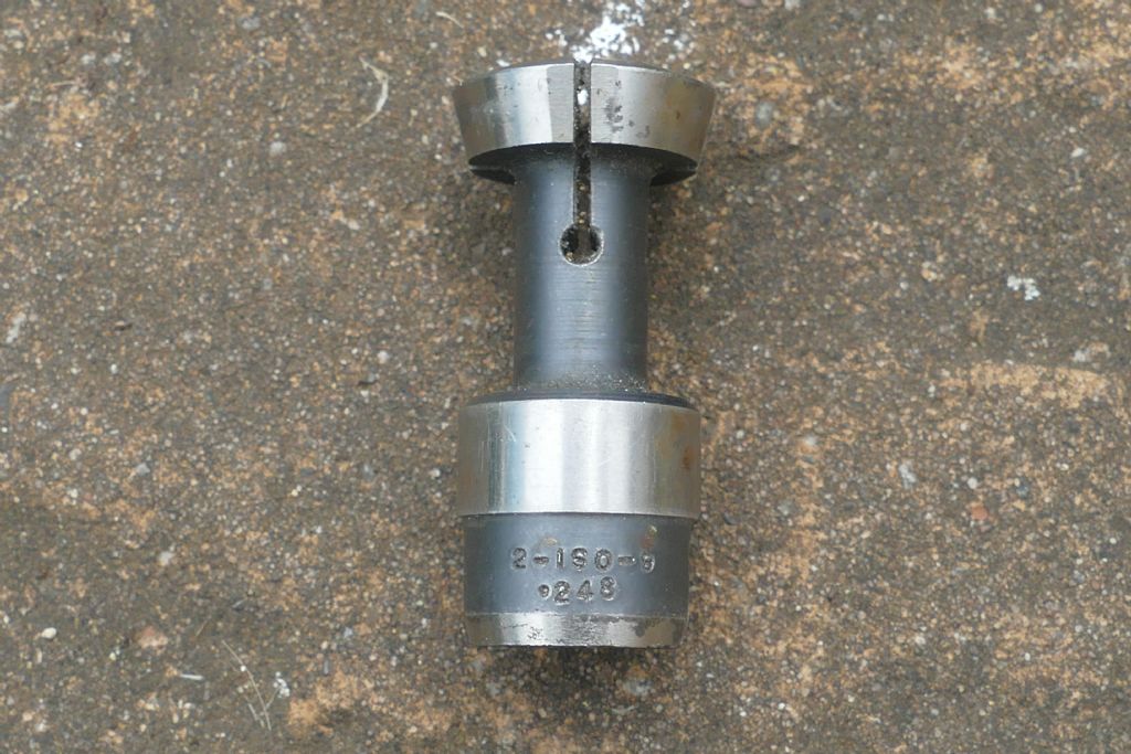

              #547372
              Martin Connelly
                @martinconnelly55370
                This is what I have got. The etching on the body does say SafTap as opposed to SafeTap but neither used as a search term gets any useful information from the web.
                The top one has the collar I made to stop the morse tapers spinning in the tailstock (hand cut wonky slit) as they are both a bit less smooth than is ideal and additionally the tailstock has nothing to restrict the tang to a single location.. I have wiped the insides down with paper towel but will strip them completely for a proper clean, I'm just after information before the clean up goes ahead.
                The collets also seem to be as rare as hen's teeth but that is not too much of a problem as I can make something that will work for sizes I don't have as they are not in an industrial environment so making them springy seems unnecessary for the amount of work they do nowadays.
                The tapers are No.2 so you can get the scale from that.
                Martin C
