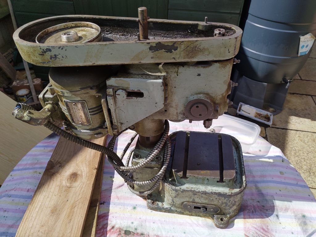

        I have just started renovating this drill. It isn't the common high speed bench drill that one normally finds, if you google the above title. I believe that this one is an earlier model, probably pre war or wartime manufacture. The main spindle is supported on a vertical sliding surface and fastened there while the quill can be used in the normal manner via an adjustable lever. The setup is very similar to the much more common Pollard drills
        Now the problem is this. It has a notice listing its speeds. It has 6 speeds ranging from 2350 rpm to 12,000 rpm. Lifting the belt cover reveals a block of 3 flat pulleys on the motor with equivalent pulleys on the main spindle, there is a very thin, wide belt transmitting the power. It still has its original massive motor which is a 1/3 hp, 2880 rpm three phase. The motor is specific to this drill and a massive mounting arm is integral with one of the motors end covers.
        So my query is how does one get 6 speeds with this set up? There appears to be no reduction gear box on the drill, if there is, then it is mighty small and no lever to change gear! I was expecting a 2 speed, three phase motor, such as a Dahlander. The rating plate shows the current to be 0.6 amp at 400 / 440 volts. There are only 3 wires going into the motor, which rings alarm bells. I would surmise that it is wired in delta as there is no sign of a neutral, but then the motor is stated to be 400 / 440 volts NOT 240 volt 3 phase as I would expect with delta connection.
        There isn't a terminal cover plate on the motor, the three wires just go through a grommet on the motor casing. Next move will be to dismantle the motor and see what is there. Not easy, as I can barely pick it up!
        Does anyone know how you get 6 speeds out of this oddball?

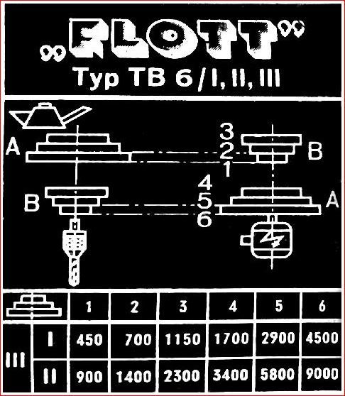

                                On my Flott high speed bench top drill, the pulleys are easily swapped over, a pin spanner releases the pulley from a slotted taper.
                                Dennis

                                  I have an Alfred Herbert Model B high-speed drill, and as-made it should have come with three interchangeable motor pulleys. These are secured by a LH thread stud onto a tapered shaft on the end of the (single phase) motor. When I bought mine it only had the smallest pulley – giving the slowest spindle speeds.
                                  The pulley on the spindle is two-step, as should the interchangeable pulleys be. I calculated what diameter motor pulley was needed to give the intermediate and high speeds – I didn't bother with two-step – and turned them from multi-step aluminium pulleys, as used for pillar drills and the like. I put a crown on the pulleys to make sure the belt stayed on-centre.

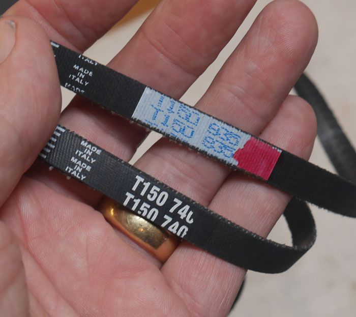

                                  The other issue is one of belts: you need a different length belt for each pulley – there's insufficient adjustment on the motor to allow for changing the pulleys. I got my belts from a very good company in Gloucestershire – can't remember the name I'm afraid, but they were no huge problem, and I bought two of each size, which will see me out! If you would like photos just shout.
                                  David.

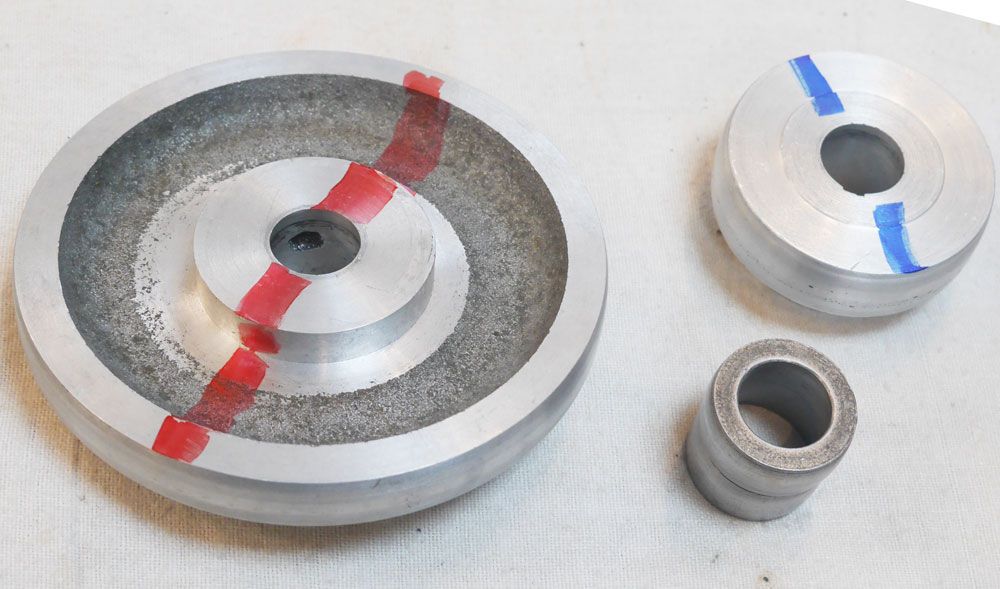

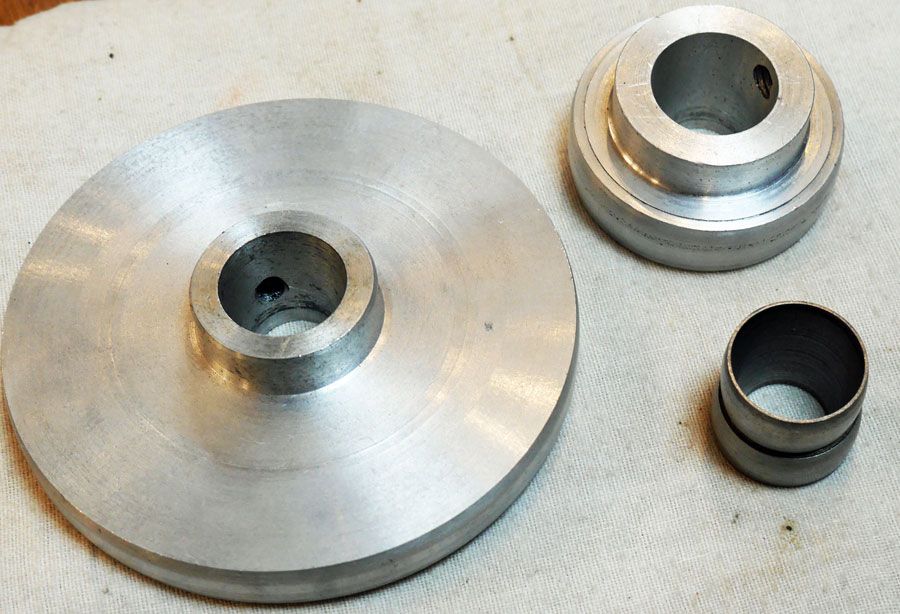

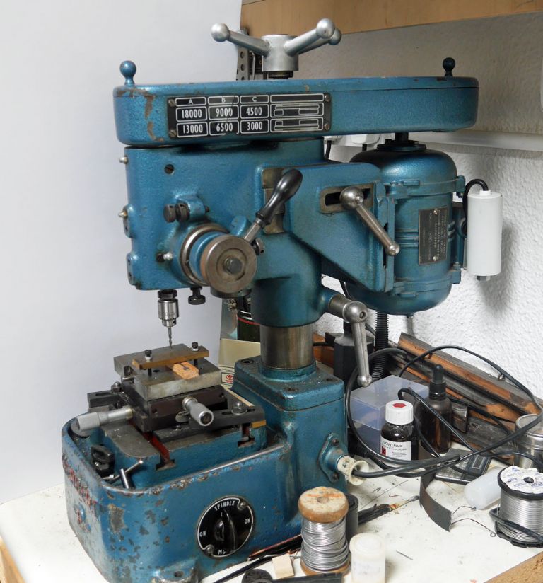

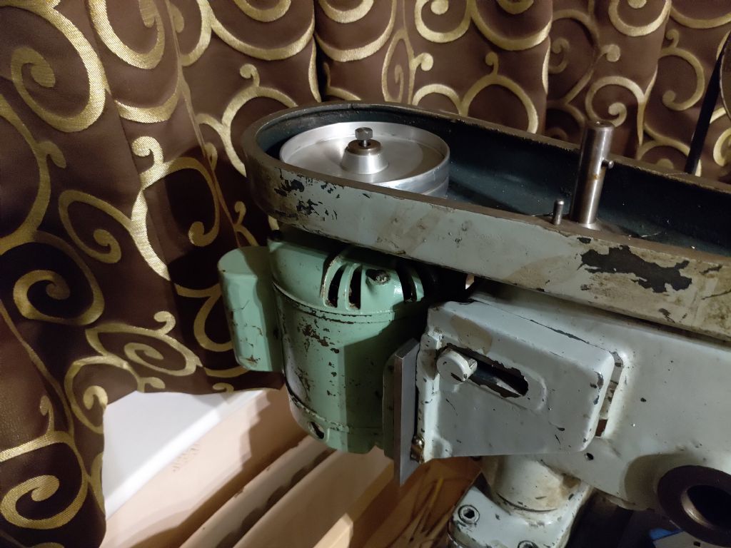

                                        On the basis that a photo is worth a thousand words, I've uploaded some pics of my machine, which I suspect is smaller than yours (!). herbert1.jpg

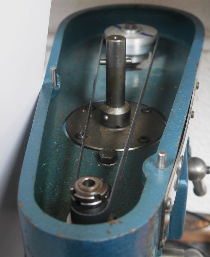

                                        next pic is with the cover off, and shows my home-made second size pulley in place on the motor spindle (the tall central spindle is the rise and fall mechanism for the head casting on the pillar).

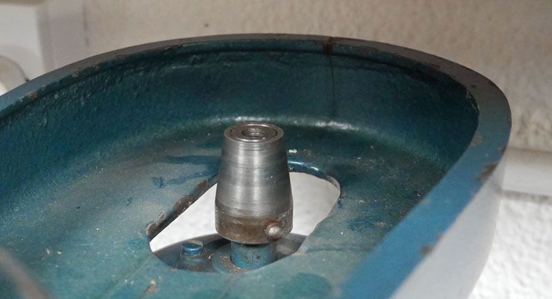

                                        This shows the taper stub on the end of the motor shaft, onto which the chosen pulley is bolted…
                                        …and these are the three pulleys. Original cast-iron bottom right has two options, whereas my home-made aluminium ones only have a single step option.Turned the internal taper on my Emco Maximat V10P.
                                        The other side of the three – the large one betrays its origin as a multistep pulley!
                                        Lastly two of the three belts. These are the medium (740mm) and long (835mm) belts. Any decent belting/bearing supplier should be able to source them for you. My belts are significantly smaller cross-section than yours – 10mm wide by 1.1mm thick, but the same principles would seem to apply. My machine came into my old shop – The Tool Box in Colyton – some years back, and I had promised myself a high-speed drill if one ever came in: I model 0-gauge railways, and for drilling small-diameter holes (down to 0.35mm or so) it is incomparable.
                                        Hope all this rambling has been of some small help! Best of luck with your own project.

                                            I also picked up a Type B in September, thoroughly coated in grease and brass chippings from it's hard working life, though mine only came with the largest pulley rather than the smallest. I investigated getting spares from HerbertSpares, but the price was a little eye watering…
                                            I'm also interested to see that Herbert did actually supply these drills with single phase motors, the ones that I have managed to research either had the three phase motor, like mine, or have had a single phase motor retrofitted, like I am trying to do. I'd be interested if there is any other makers marks on the motor? The Gryphon motors aren't exactly an good fit on the back motor mount.
                                            Next step for me is to make a new motor pulley cone – to fit the keyed motor shaft rather than the tapered pin.
