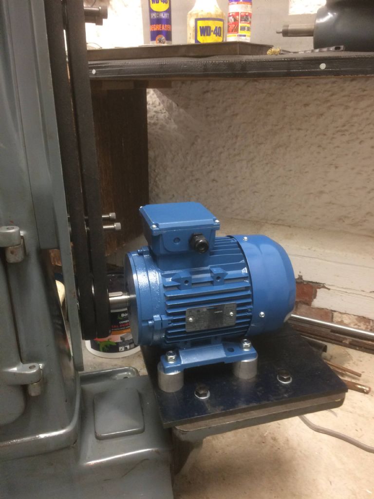

      The refurbishment of my Alexander Toolmaster is progressing quite well. It now moves freely in the X and Z directions and I have fitted a new 3ph motor. Not been able to test it yet as currently do not have the power sorted out.

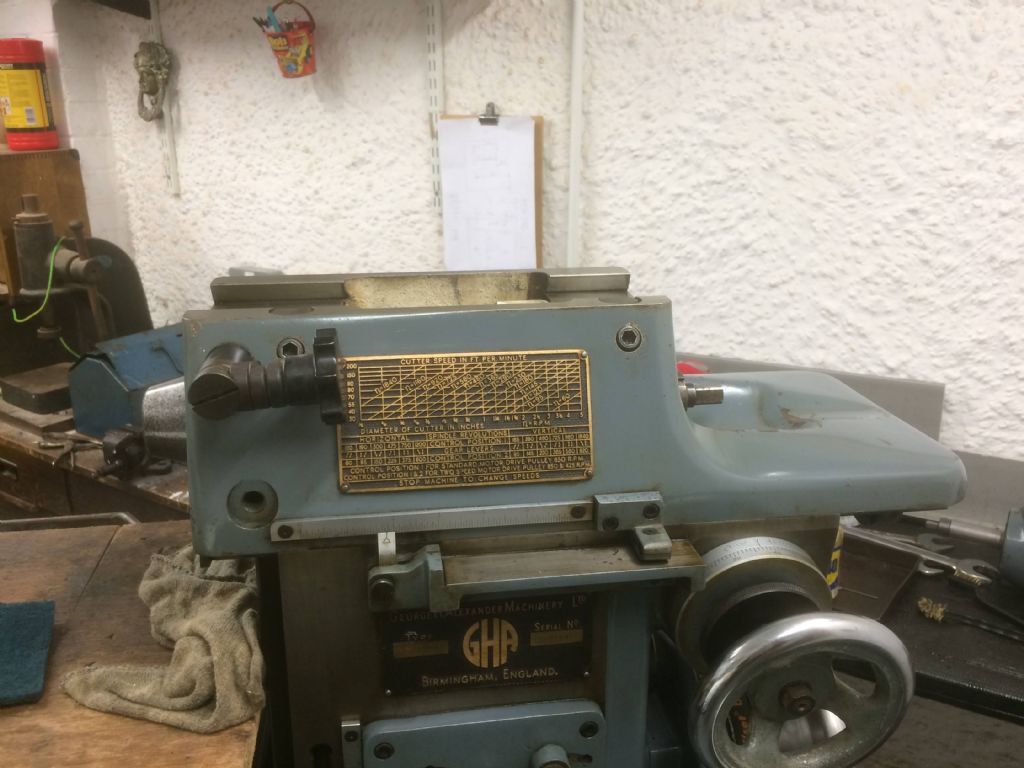

      I now need to sort out the Y direction travel but I cannot work out how to remove the horizontal spindle carrier. Please can anyone advise. I have attached a couple of photos.

          I think you have to remove the spindle first and then remove the gib strip then disconnect the leadscrew from the handle and it should come out.
          #635351
          Phil P
            @philp
            I am pretty sure that you need to remove the support bracket hanging down from under the rear of the slide.
            Once that is gone the slide comes of the front of the column.
            Phil
            #635408
            Bob Sillitoe
              @bobsillitoe83708
              I have removed the support bracket. If I slide the head forward (or backwards) something somewhere hits something, so it will not slide off. I have seen pictures of heads removed from Deckel machines that still have the spindle in situ, so on Deckel's at least it doesn't need to be removed. The Deckel instructions are to remove the gib strip, to then lift the head on the gib strip side and then to lift the whole head off. I just cannot make this work on my Alexander, I can lift the head on the gib side but I still cannot lift it off. It could be of course that I am not strong enough!!

                  Thanks for the youtube link, very useful for all sorts of things. On my Alexander even if I removed the horizontal shaft I still wouldn't be able to slide the head forward because there are two pins at the back of the head which are used to locate the support bracket and they would foul the machine as the head is moved forward. The pins are a press fit so probably not easily removeable. It might be possible to slide it off backwards though. However I really don't want to remove the shaft to find out.
                  Here is another link I have found which includes an extract from a Deckel manual which shows how to tilt the head before sliding it forward. no shaft removal required. This is what I have been trying to do but with no success. Is my Alexander different – I have no idea!

                      But now I am restoring it, new motor with VFD, freed up the X and Z travel and generally degreased it. There is really nothing wrong with the horizontal head, I was just wanting to take it off to see what was inside. So now on the basis of if it isn't broke don't fix it I am just going to put it back together. I can then get on with sorting out the VFD, never had one of those before.
