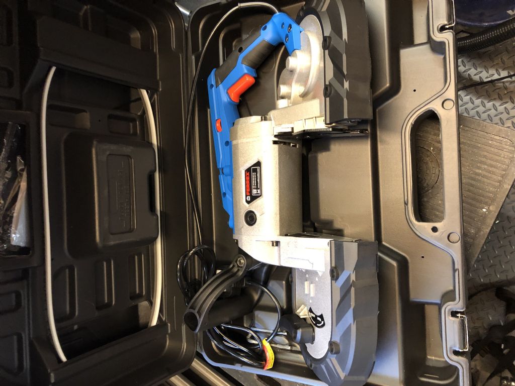

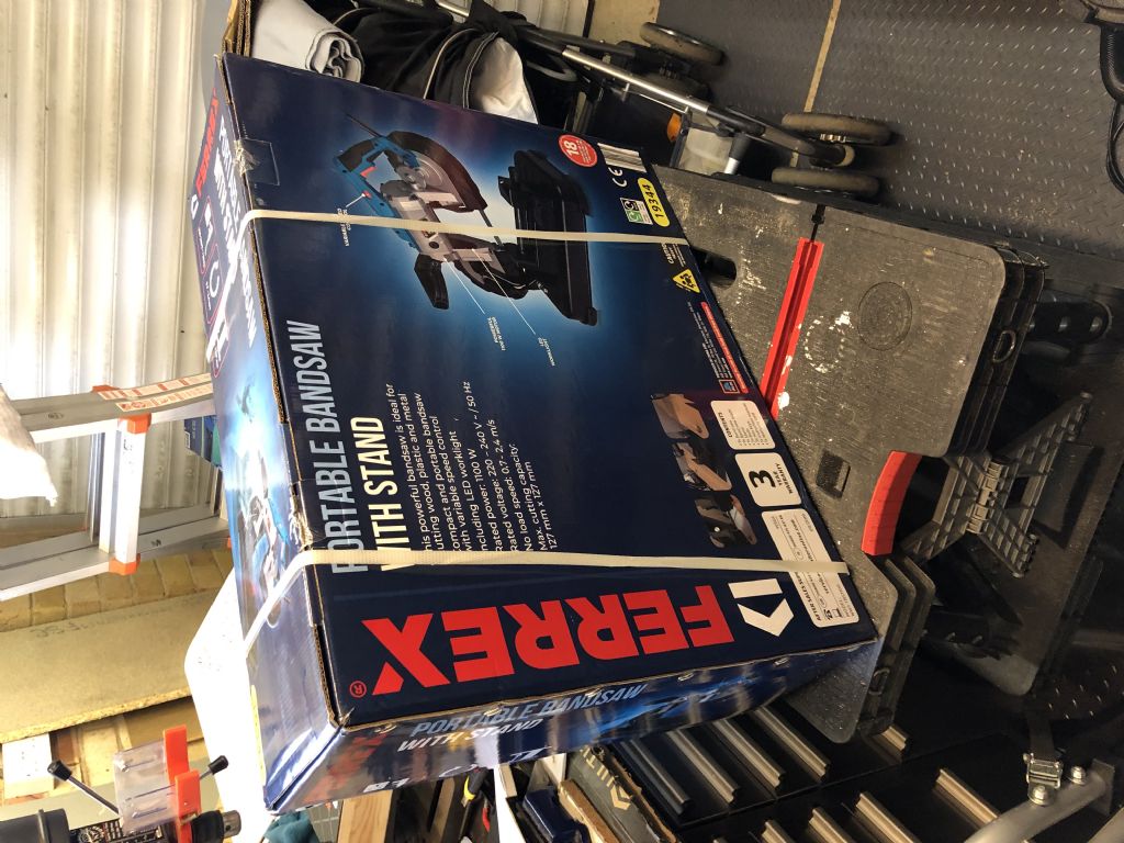

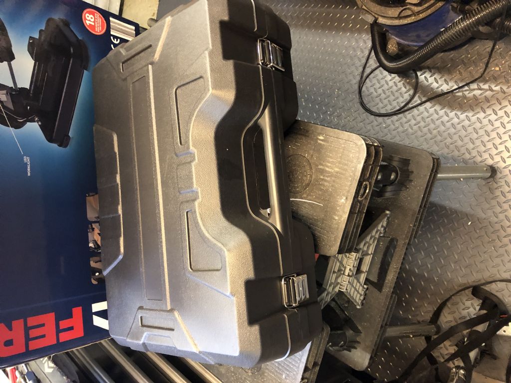

                        I bought one about 10 days ago and it took a week to arrive, I unboxed it today:
                        Inside the cardboard is the stand and a blow moulded case for the saw, which is nicely screwed together with plastic and metal castings and not flimsy.

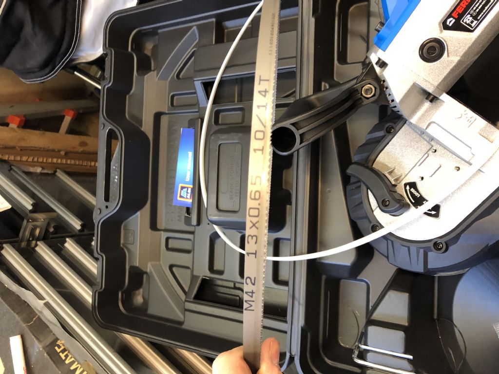

                        The flex is about 2M/6 ft long, the blade is stored in the lid with the instructions, which were only in English. The blade is marked thus –

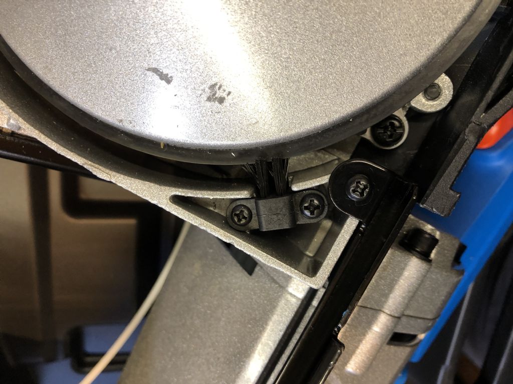

                        There is a brush to remove filings from the teeth of the blade

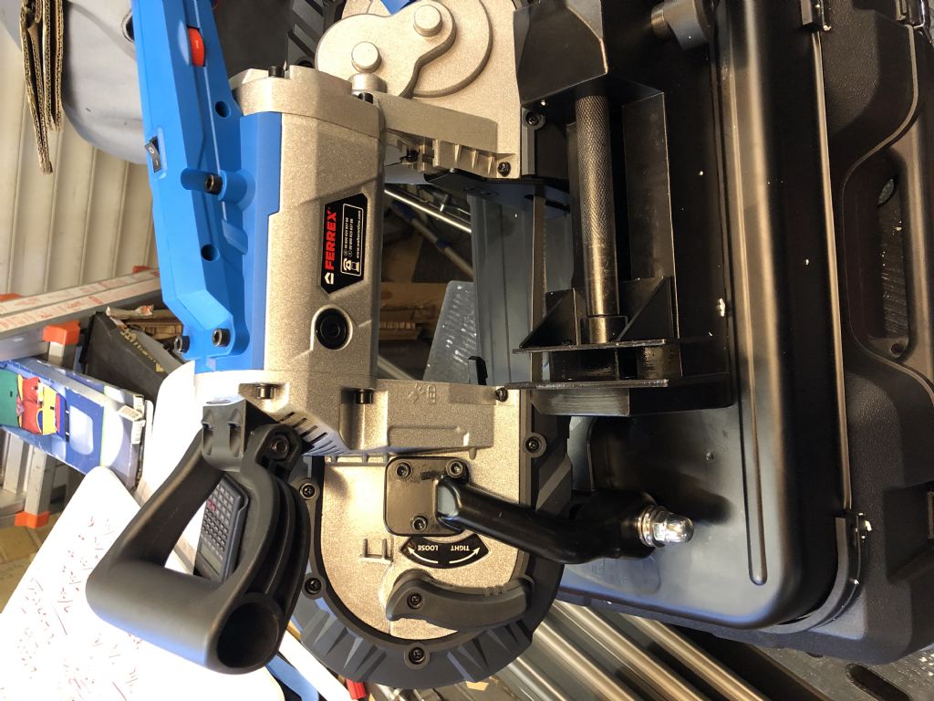

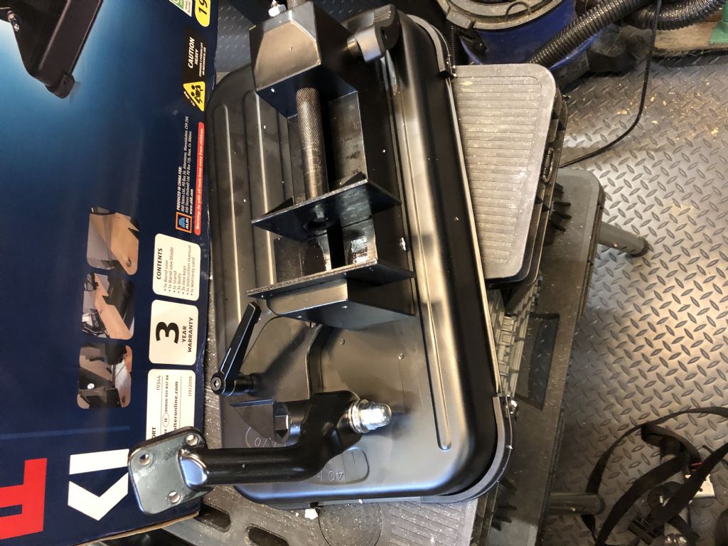

                        Fitting the blade was easy, as was fitting the saw to the stand with 3 Allen bolts.

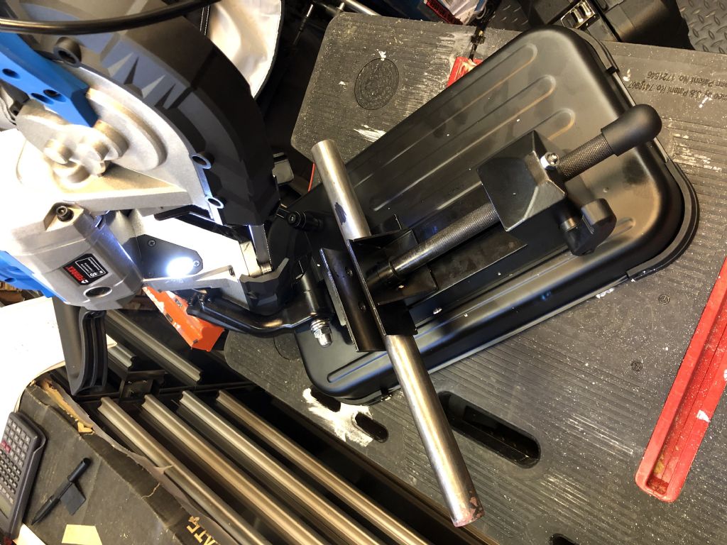

                        The vice and the angle adjust (0 x 45 degrees) are secured with a lever lock, the vice onto the knurled bar. The speed control is step less in 6 stages from 0.7- 2.4 metres/ sec

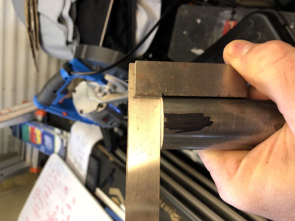

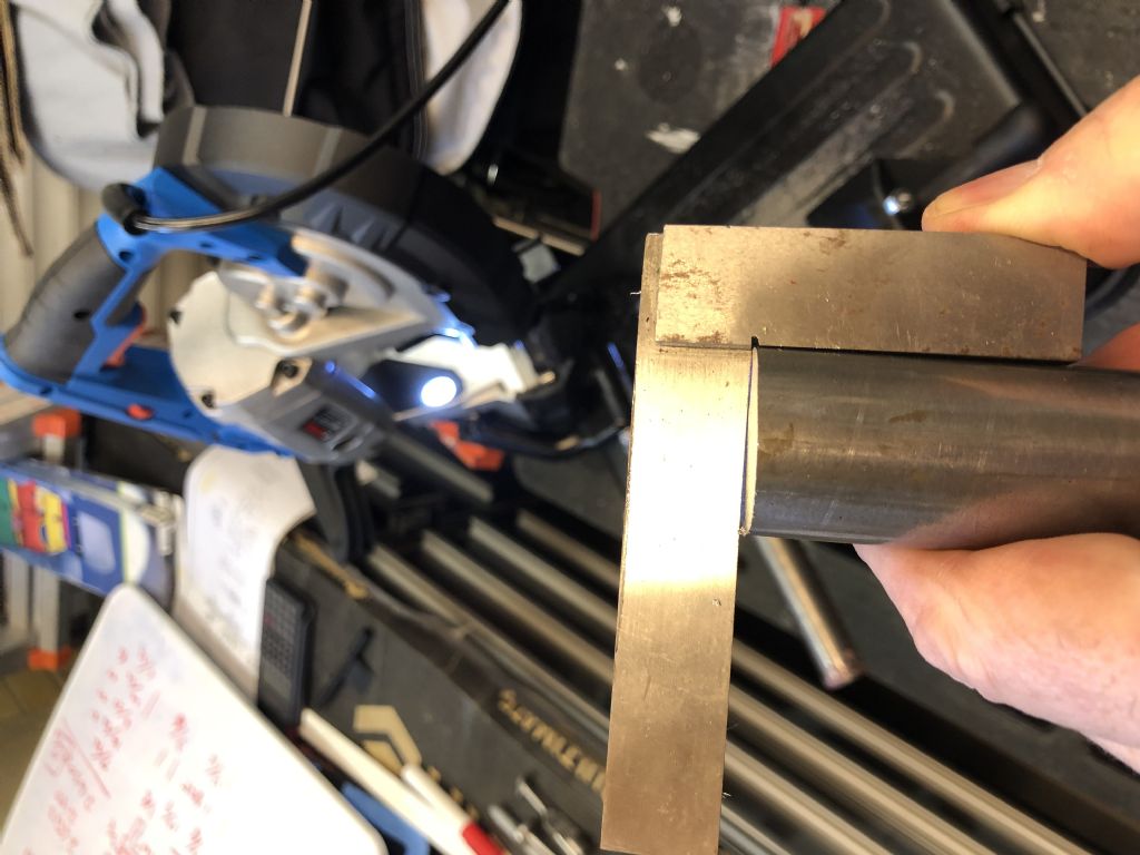

                        i cut a piece of 30mm mild steel to test it with no other setting up initially at the slowest setting raising it to number 2 as it started to cut properly.
                        It cut through in a minute and a half, you have to keep the trigger held, there is a led light to help illuminate the cut., the cut vertically is a little off but no worse than hand cutting, the front to back is acceptable as it is adjustable by tweaking the angle
                        First impression is of good value and likely very useful especially when I get to making a vertical table fixture.
