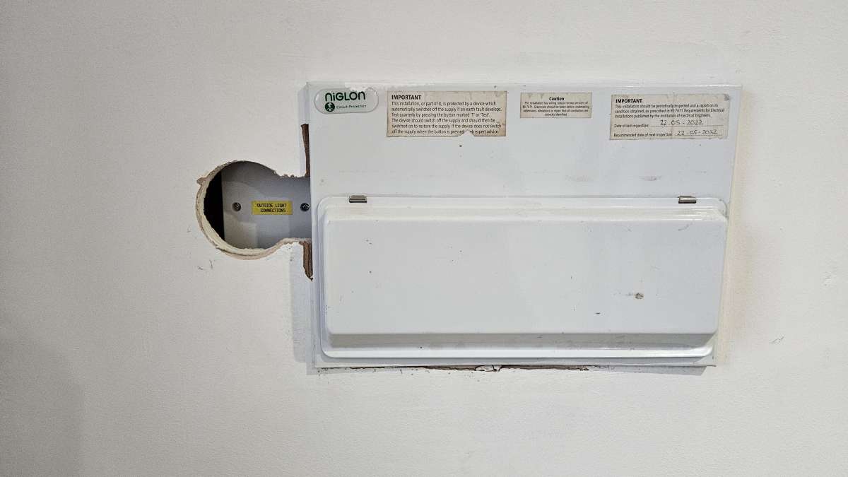

                              Not my house but the result of some halfwit fitting an isolation switch which they turned off before plaster boarding over it. Several other brilliant pieces of building prowess came from this firm during a house conversion that cost many thousands and left the owner with an unfinished job that i helped rescue.20240204_155135
