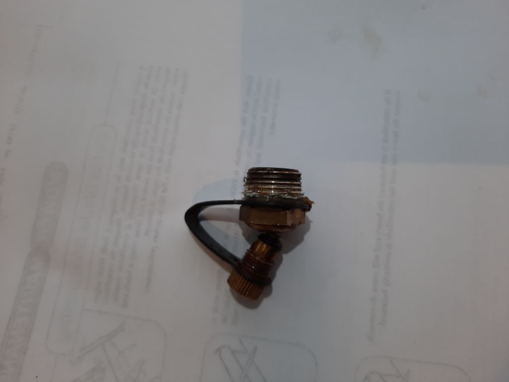

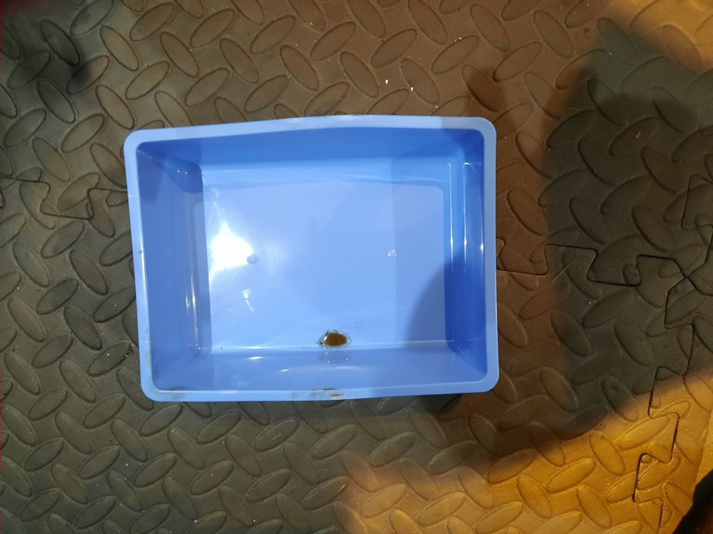

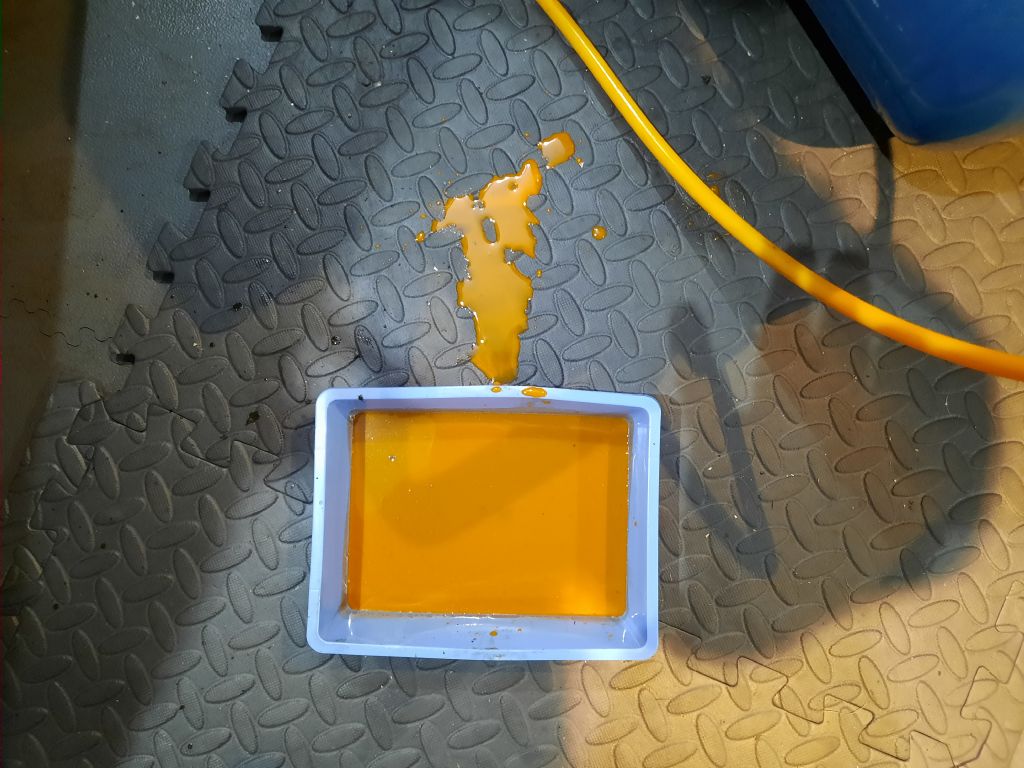

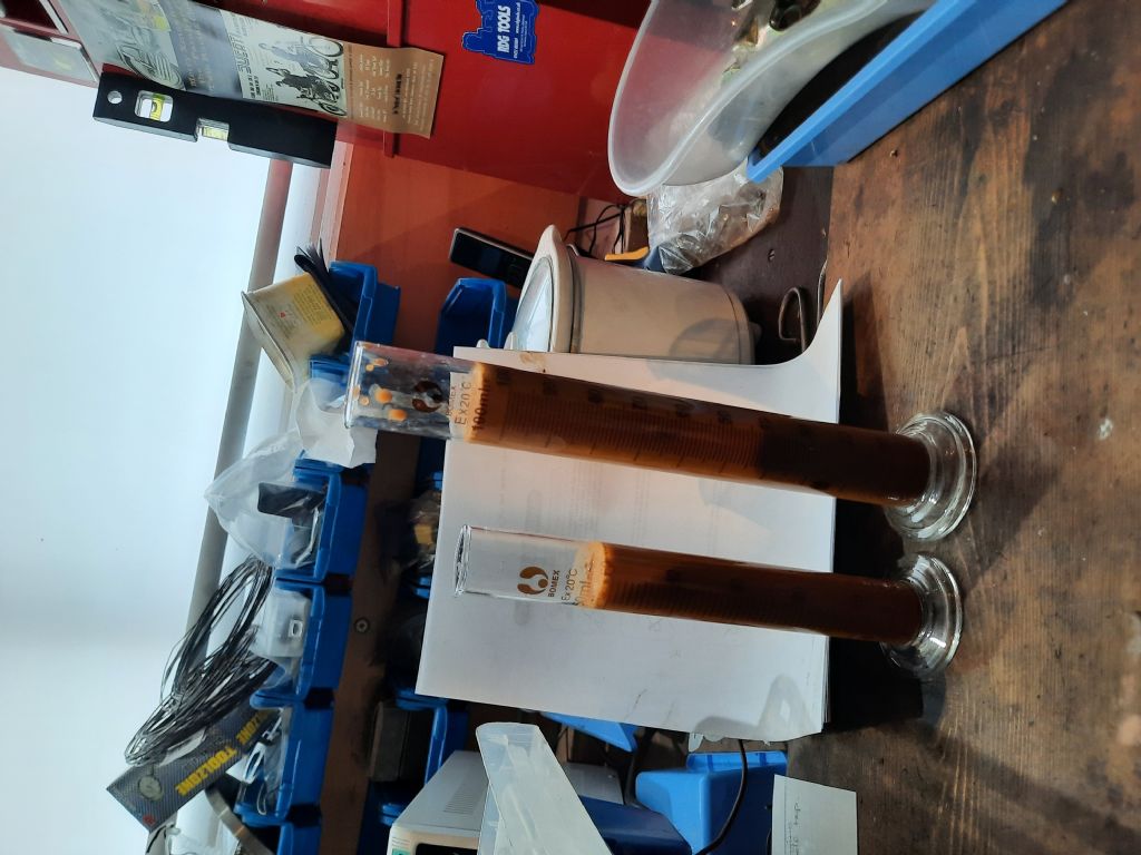

                          A heartfelt thanks to Gary. Because of this thread I checked my compressor yesterday…
                          Background
                          I bought this compressor in late 2016 from Aldi but the design is pretty generic so will apply to many other brands. To begin with I drained the tank regularly when in use and would get a thimble full of water each time. I then installed a dehumidifier in my workshop about a year ago and and around the same time the water I was getting out of the compressor reduced to a dribble each time I drained it. I became lax in checking the compressor as I assumed the dehumidifier was causing this. WRONG This is what I found yesterday:
                          1. Amount of water initially drained by removing the small drain plug
                          I gave the compressor a shake and could hear water sploshing around. I removed the large plug with a 17mm spanner and apart from a blob of crud nothing else came out. However, I could still hear water when I shook the compressor. I poked my finger up the drain hole and broke through a crust of muck that had formed there. This is what came out:
                          2. Third drainage attempt
                          3. over 150cc of rusty water
                          Following on from a comment made in an earlier post about checking the drain wasn't standing proud from the bottom of the air reservoir you can see in the next picture the drain plug's top two threads are discoloured. I read this as showing they have been standing proud from the bottom of the cylinder.
                          4. Drain plug threads and design
                          Conclusions
                          Because the water did not fully drain each time the compressor was checked it allowed crud to form over the drainage plug so that it eventually blocked the drain completely allowing a much larger volume of water to collect over time.
                          Solution
                          A couple of fibre washers added to the drain plug would lower it sufficiently to bring it level with the bottom of the inside of the air reservoir and stop the initial build up of water happening if drained regularly.
                          #523627
                          not done it yet
                            @notdoneityet
                            Solution
                            Well done. Checked and rectified by a simple mod (could also have machined off the excess, instead, but washers are cheap). Apart from 4-5 years of potential rusting already caused by poor manufacturing and lack of regular drainage, that should certainly lengthen the safe lifespan of your compressor (although I suspect the pump will wear out first if used quite often).
                            My receiver is well over-sized for my present usage (I no longer do grit blasting) but I always open the drain valve and allow the tank to blow itself empty, after use.

                              Posted by Graham Stoppani on 30/01/2021 06:44:17:
                              Mid quote deleted for clarity
                              Conclusions
                              Did it go "Bang"?

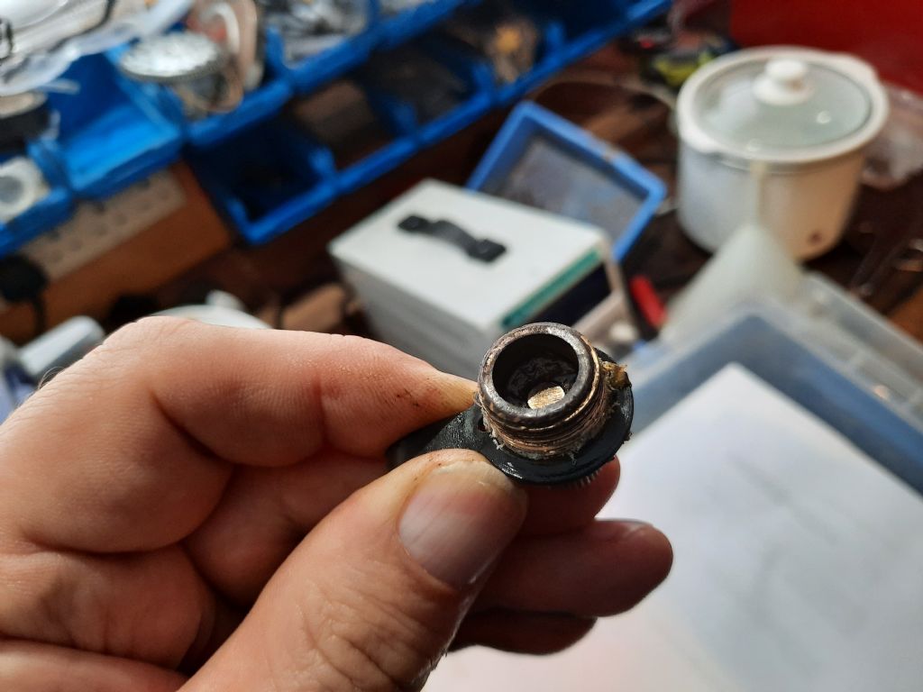

                                I also drained my compressor for the 1st time in many years & about 100 ml of whitish water came out. My question to the chemists amongst us, will a tank rust more with standing water as opposed to only moist air being cycled in & out?
                                Tony

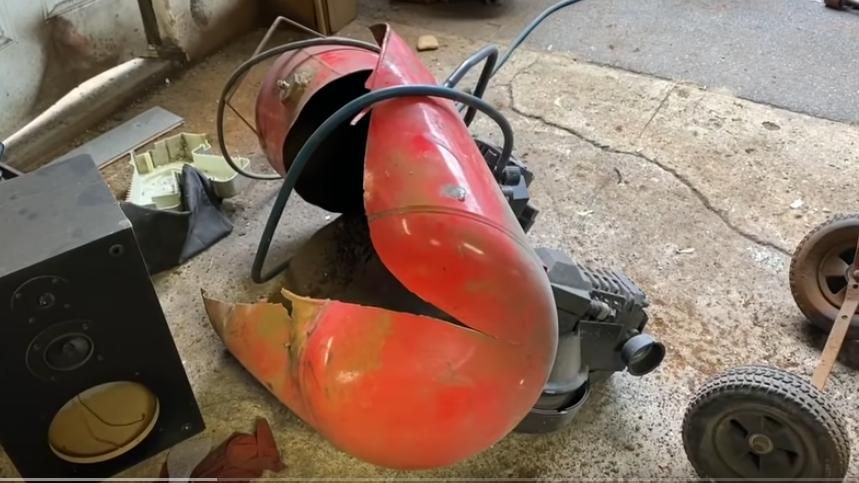

                                      #523648
                                        Posted by Sam Longley 1 on 30/01/2021 08:44:28:
                                        Conclusions
                                        Did it go "Bang"?
                                        This one did:
                                        #523664

                                                Posted by Tony Pratt 1 on 30/01/2021 09:08:53:
                                                Tony
                                                That's a little bit of oil in the condensate.

                                                  #523751
                                                  Robert Atkinson 2
                                                    @robertatkinson2
                                                    Posted by SillyOldDuffer on 30/01/2021 10:09:31:
                                                    Conclusions
                                                    Did it go "Bang"?
                                                    This one did:
                                                    Sam said " And there we go again– back to the one in 10 million cryingthat was probably as rusty on the outside as much as it was on the inside & most people with any sense would have already said "Hey this is beginning to look a bit dodgy, perhaps we should have a look inside, or think about a new one" "
                                                    As has been said before, that tank failed from fatigue at the longitudinal weld. Look at the photo. Corrosion may have had some contribution, but not from rusting through.
                                                    Edited By Robert Atkinson 2 on 30/01/2021 17:28:24
