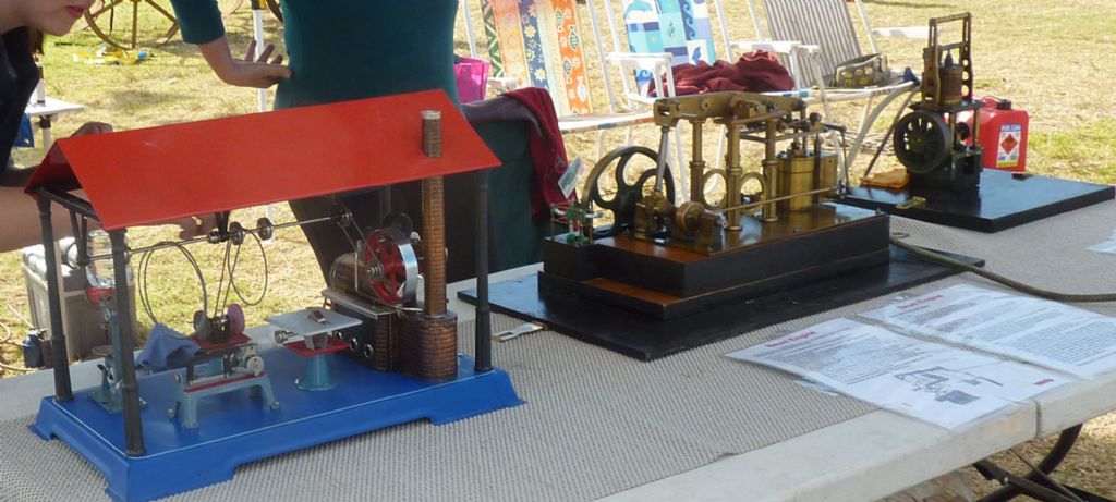

                            Paul Lousick
                              @paullousick59116
                              Do not have size for the engines but they are in the photo below. (not run all at the same time) Worth investing in a steam cleaner. If they are not big enough to run your engine can always be used to clean the bathroom..
