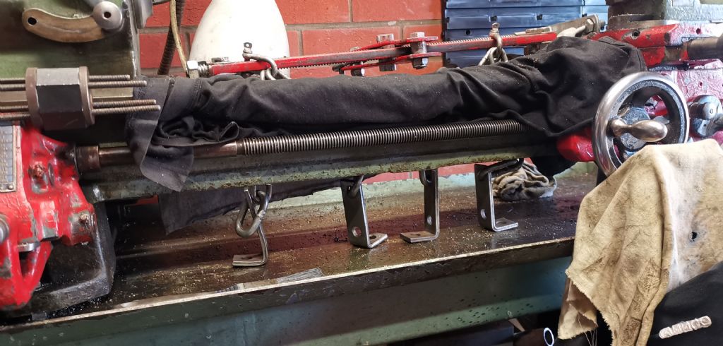

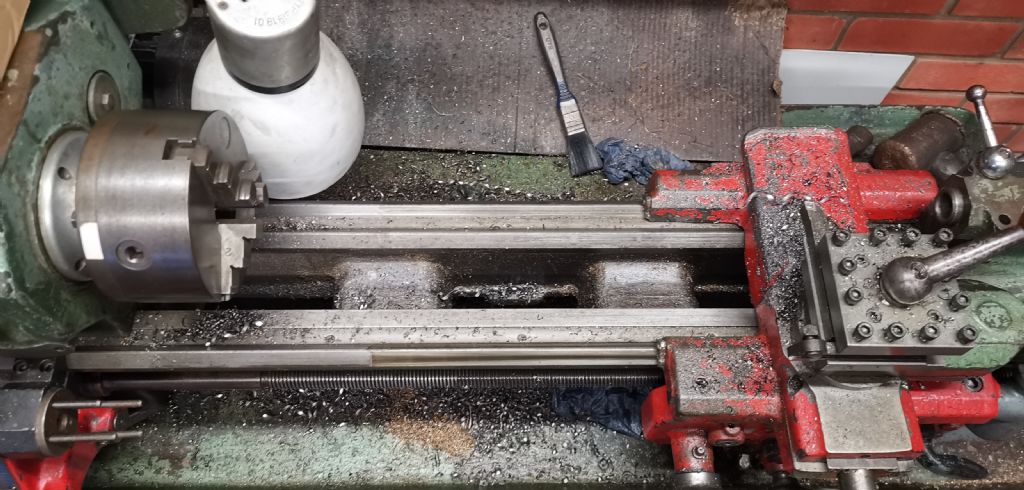

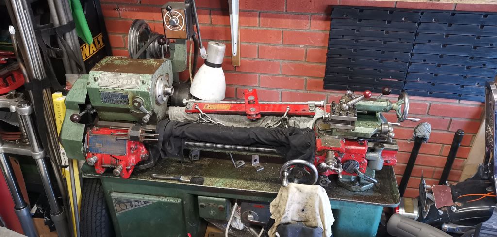

        Hi all,
        Hope someone can give some advice.
        Im moving home soon and need to lift my little Boxford into the back of a van.
        For this I'm planning on using and engine crane and a hoist leveller to help with the difference in weight at one end. There will be 3 of us doing this.
        I tried to find ways of doing it but everything is in the way when I think of using straps – the motor, the gearbox, the lead screw, etc..
        So I was planning on using the blocks in the middle of the bed, get the leveller chains through it, like on the photos, then connect the angled brackets with 1/2" threaded rod, about 6" long to keep them apart the same width as each block.
        My question is, would lifting by these blocks risk damaging the bed? It's all pretty solid, but thought of asking the experts…. I think the lathe weights about 400kg
        Thank you

              If you are lifting it with an engine hoist, without taking it apart, a well known Boxford dealer showed me his method. A strop around the web between the ways immediately in front of the chuck and lift the whole thing as a single unit. Later Boxfords had a threaded hole in the web to take a lifting eye. It will still be heavier at the headstock end but if you remove the chuck and slide the carraige as far right as it will go, it will be nearly balenced.

                Thanks for the tips so far, let me try answer them all.
                Just been in the garage and mine doesn't have any holes on the cabinet near the top. I did see a photo like that online, with the solid bars across, but can't do that on mine.
                Also no threaded hole to put a lifting eye.
                I have a spare saddle, so I could at least strap that extra one to the lighter end to help counter balance even more.
                I did read online about putting the saddle as far right as it can go, that's why it's already on that position on the photos.
                My worry was really if lifting on those blocks would damage it.
                I reckon we can do it, we are used to lift big block V8 chevy engines attached to gearbox into American cars.

                  I've had to move several Boxfords over the years. I've always stripped them into big lumps that can be manoeuvred by hand. (Just about).
                  Take the chuck, tailstock, toolpost and saddle off. Disconnect the belt and split the bed from the cabinet. You can go further and split the bed and headstock if you want but its not essential IMO.
                  It doesn't take nearly as long as you might think and putting it all back together is no big deal. It's much safer to transport it this way as its no longer top heavy, in fact you can put some of the parts in the bottom of the cabinet to stabilise it.

                      You can put the strop through the bed close to the headstock and around a bit of 2×3 wood under the bed. Simple. Importantly then put a thin rope though the spindle, around the strop, and back through again to pull the strop close to the headstock otherwise it can sip down the bed. This also ensured the pivot point when lifting a bare lathe without a cabinet is above the CofG.
                      Last time I stripped a Boxford I weighted the bed alone and it was 60lb and i wrote it on it. Unfortunately that's the only marking left but I think the all up is more like 400lb than kg including cabinet.

                                    I'm lucky in the sense of where to move from and to..
                                    It's coming out of my single garage..so straight flat to the driveway and into the new garage, again all flat…
                                    Thankfully no steps or awkward corners to negotiate.
                                    Should be a pretty simple move but was worried if lifting by those blocks would damage it.
                                    I really don't want to take anything apart, so to make it a more straight forward move..
