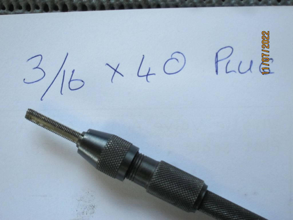

      I happen to have three 3/16"x40 plug taps which are all very well but perhaps one more than I really need. What I would like is a taper version of the same thread, achieved perhaps by grinding the end of one of the plugs to give a leading taper which would then make life a lot easier. Initial thoughts are to put one of the plug taps into a hand held pin vice and offer it up to the grinding wheel but before doing so I have wondered if anyone may be able to suggest better ways of doing this.

          You could indeed get a taper using the method you mentioned, but it is not quite as simple as that. The tapered flutes also need some relief behind the cutting edge, that is harder to achieve. If you are tapping something relatively soft, you may get away with just the taper, though. Since the length is good and you have three, it would be worth using one as a guinea pig. Maybe using an electric drill rather than the pin vise would get a better match of the three flutes, though.

                  I'd give it a go with a diamond file. You'd have nice control of the taper & clearance that way.

                      The pin vice idea is one that I've used. It's a bit tricky because, as Old Mart says, you gotta put some clearance behind the tapered cutting edge, and without grinding the leading edge off the taper of the following land !
                      IIRC I was doing cheap M4 taps, using the side of the wheel, and got a failure rate of 1 in 3.

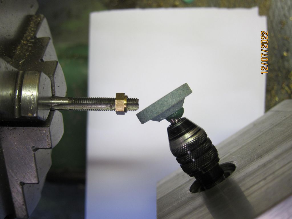

                                          Well, despite all the doom and gloom and with absolutely nothing to lose I gave it a go using the Dremel with the tap indexed in the lathe and have achieved a useful compromise, the test nut running quite happily up the modified tap.

                                            That's just a plug tap with a chamfer on the end. Won't start cutting until that first tooth hits the job. Not what I thought you were asking about, ie gradual taper over the first half inch or more like a proper taper tap. But if it works for you, go for it!
                                            You could get the same effect as this one by using your unground plug tap and chamfering the edge of your hole instead.

                                              The dremel illustrated could be set at a much shallower angle for more lead in. Starting this way at least makes all the flutes match, a job much harder freehand with a pin vise. Then some relief could be stoned behind the leading edge of each flute leaving only a tiny bit of original taper. The tap would probably work, but test first before committing it to an actual workpiece.

                                                    Taper tends to be around 10 turns of thread rather than an actual angle, so quite a bit shallower than what you have ground, just look at another taper tap to see.
