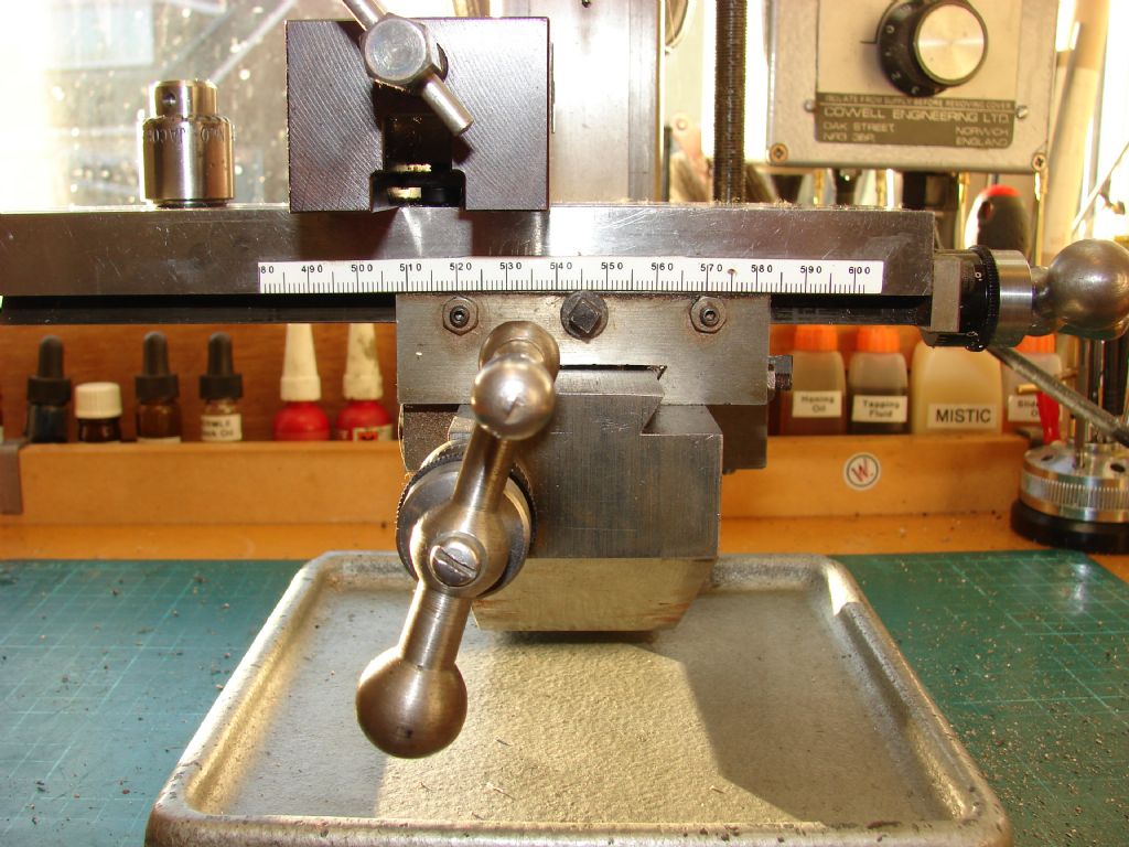

                        For what it's worth, when I fitted the 3-axis DRO system to my Warco VMC mill.decided to re-instate the table stops by fitting a slotted strip on stand-offs from the front of the mill table, like this:
                        x-axis scale 2
                        This arrangement also allowed the x-axis power feed stops to be mounted on the same plate. It wasn't long however, before I found that neither were being used, so it was removed and has languished on a shelf in the workshop for 5+ years.
